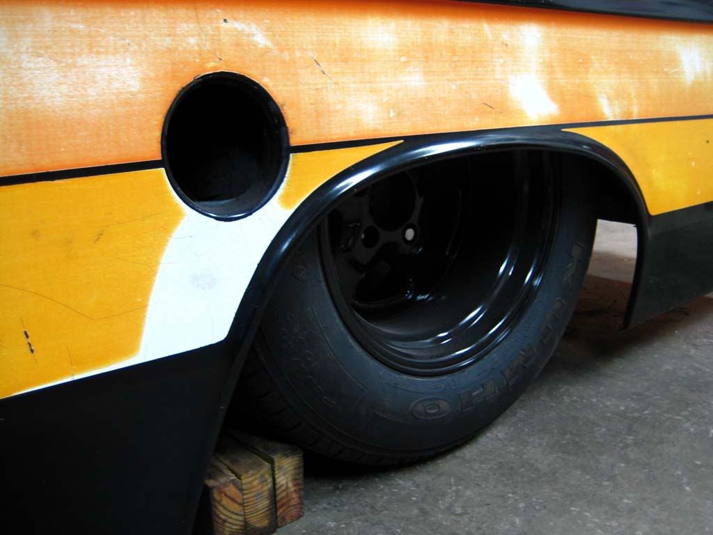

i dont think those rear fenders are going to work when they get wet they will just fall apart lol just miss-in your truck is lookn sweet keep it up what size rear tires you got on there

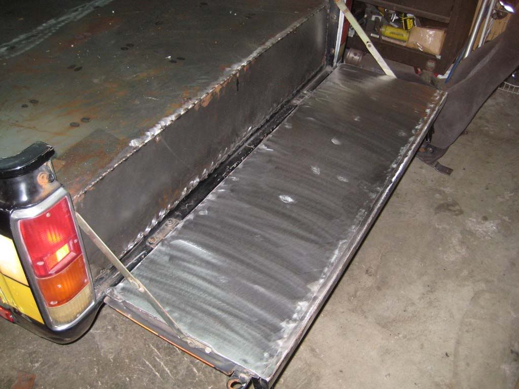

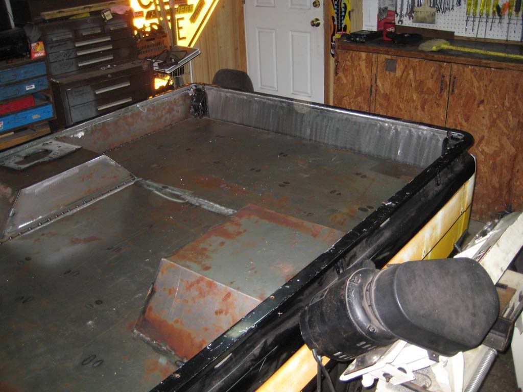

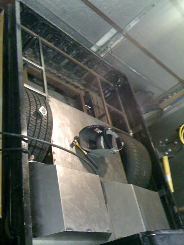

front section tacked in. wheel tubs trimmed and welded together.
gonna run to lowes and probably pay way to much for some 1x1 so i can finish the frame work.

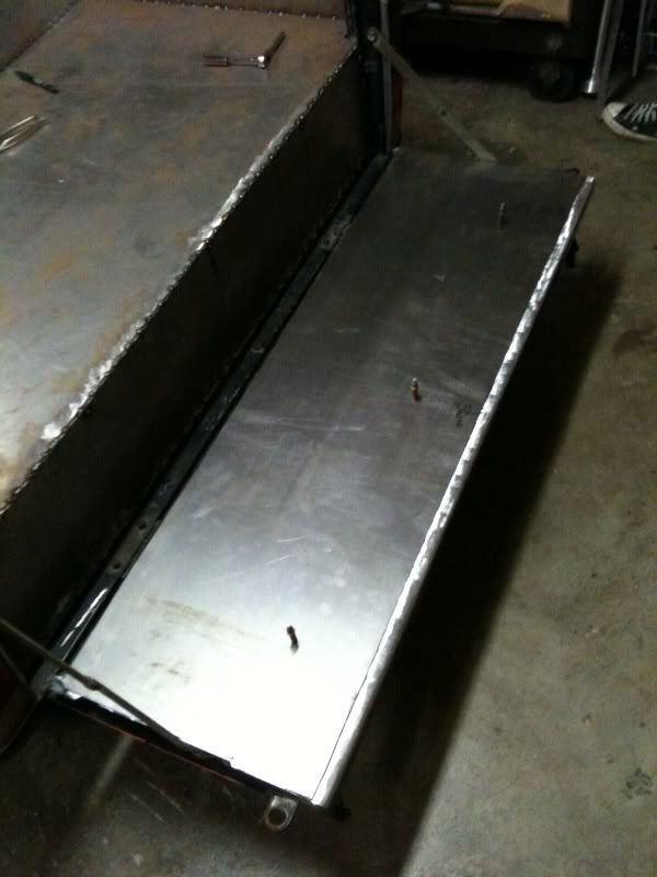

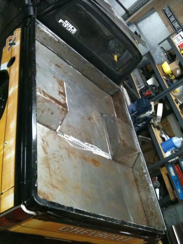

cleco'd on for now. gonna wait till my mar-k hidden latches come in. will be easier to cut out the slot i think. doesnt sit perfectly flat. if you push it down it does though.
coated the bed with wd-40 as well to keep it from surfacing anymore.

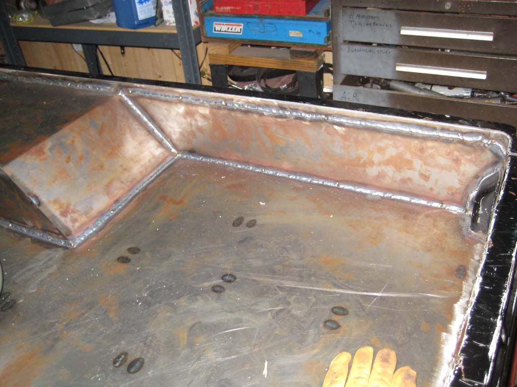

i dont know how much more.. if i said a number id be lieing.
easily 50' for 1x1" tubing. i think closer to 60'.
sheet of 4x10 plus a little more of 16gauge sheetmetal..
definately not a drag truck bed hahahaha
 Post subject: Re: LUV II
PostPosted: Mon Feb 01, 2010 11:16 am
Wrong perfect drag truck as the weight is right where it belongs "over the rear axle".

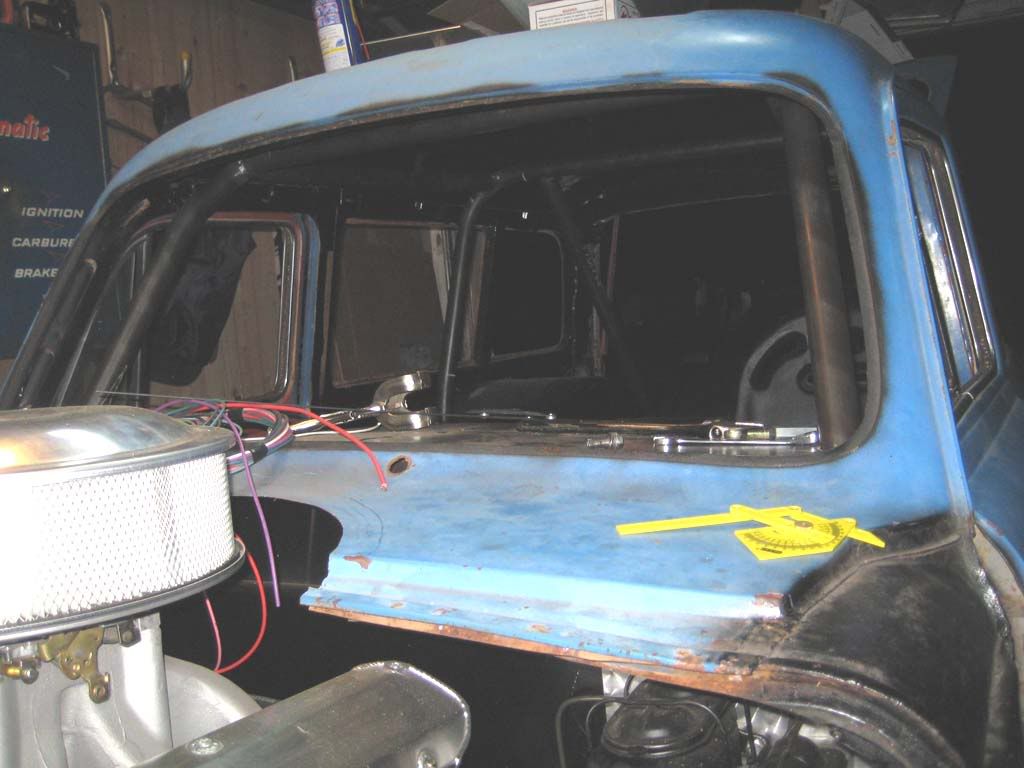

the cowl holes you plugged are for ventilation and air intake for the heater and airbox. i would think twice about closing them up.
just like the vents on the b pillar are for exit of the cabin ventilation..

im not going to be using any factory ac setup.. not sure if aftermarket will need them. but i havent welded up anything on the new cab except wipers

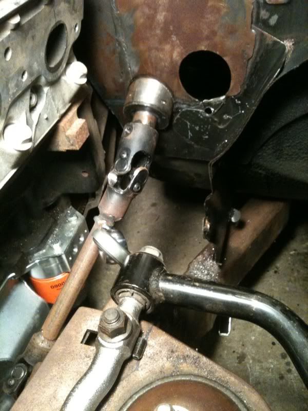

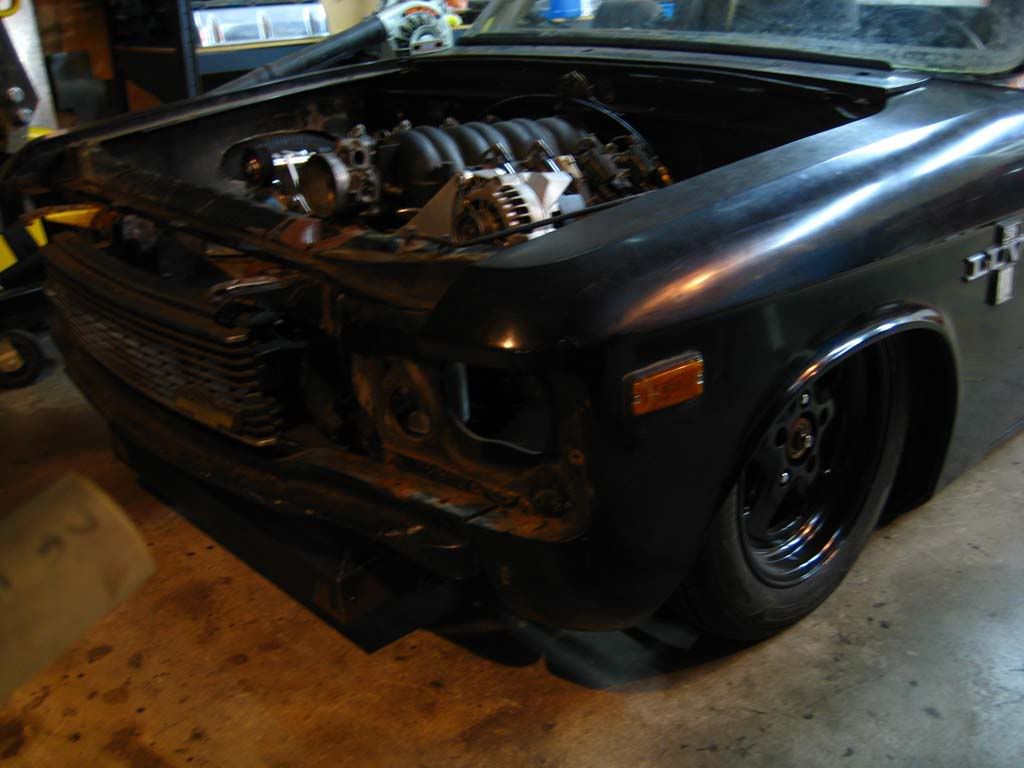

and i havent been doing much. i moved the steering column and got rid of the binding
Have you ever seen one of these? It relocates the steering.
link>
http://www.speedwaymotors.com/Steer-Clear-Box,6254.html
Quote:
Info
2006 Best Engineered New Product at SEMA
Finally, a solution to the age old steering column/pedals problem.
This nifty box provides unlimited options for steering shaft clearance so a high performance engine and headers will fit. Allows you to safely reposition the steering column higher, giving you more room for your feet and pedals. Chain drive.
Available in 8", 10", 12", 14" or 16" offsets. Available in brushed or polished finish.
PostPosted: Thu Feb 11, 2010 9:31 pm
LSX LUV Owner
Posts: 1261
Location: Dickinson, Texas
yeah ive seen them. but have you see the price? if i was made of money maybe!

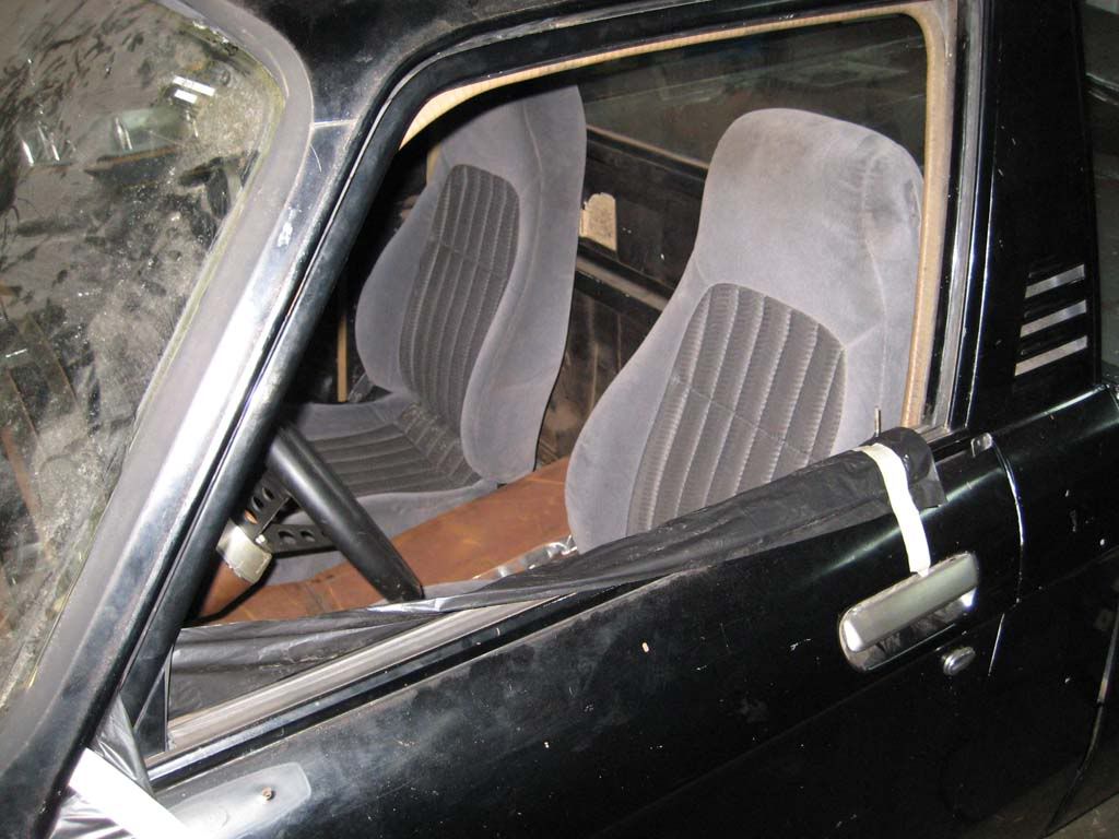

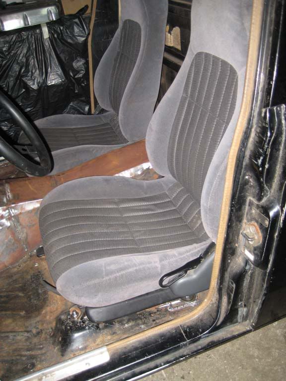

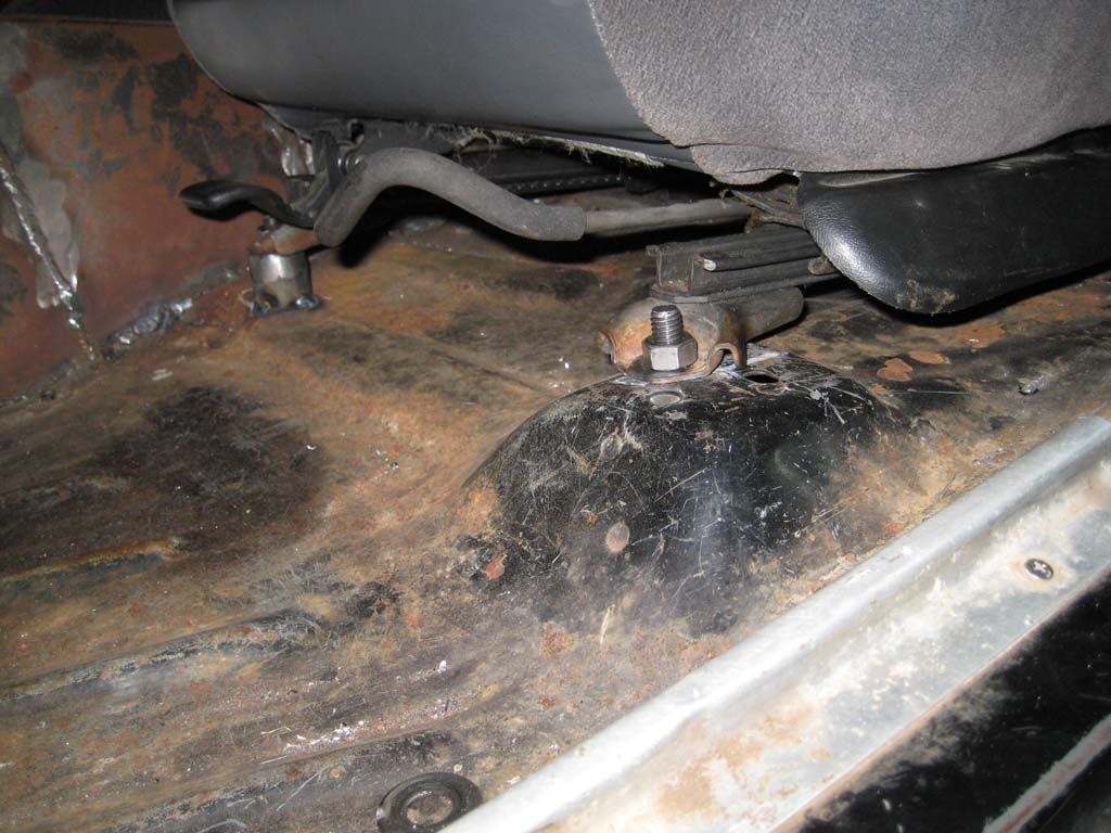

seats all mounted
custom door panels.. check

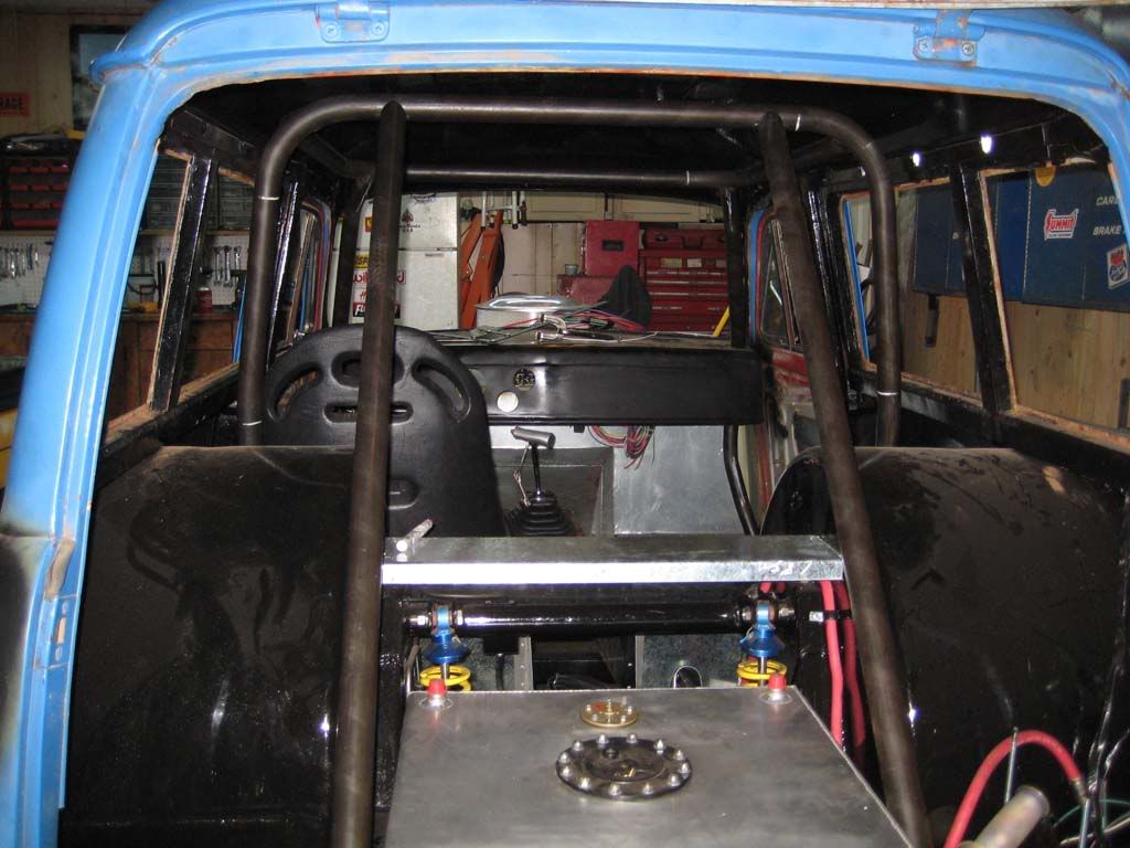

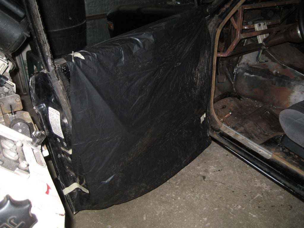

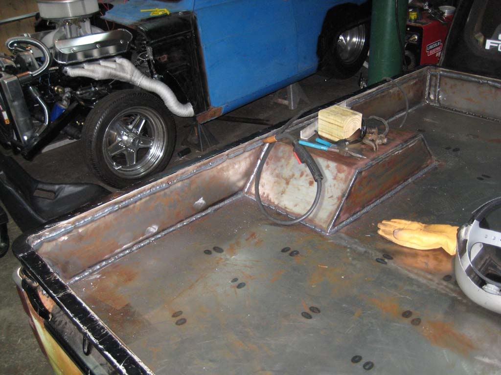

me and a buddy started welding bed all up...
and we started on dads cage
