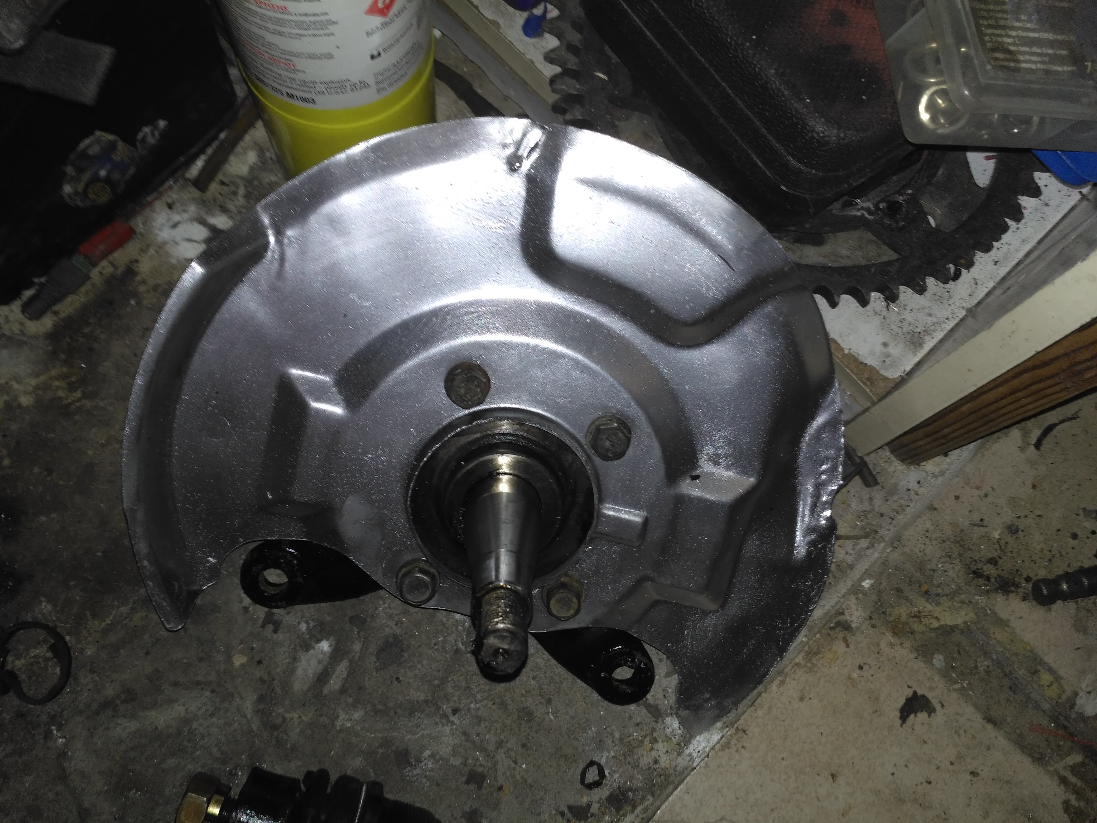

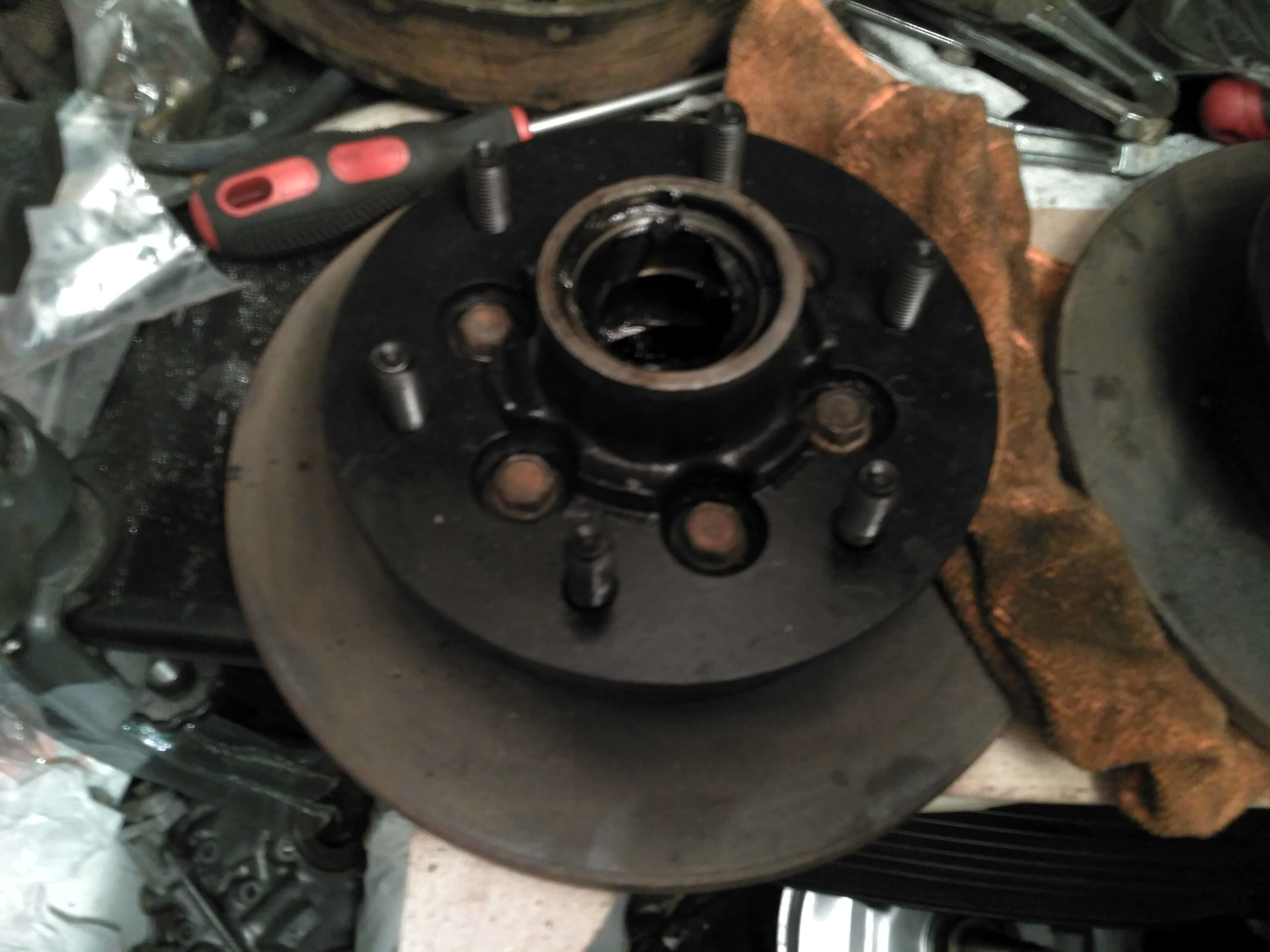

Managed to found a front brake set of a 1981 pup.Cleaned everything from rust and rebuild the calipers.Just got to put them on.
Any ideas how can i get the ball joints from the old arm with hurting them?

So i used i ball joint puller and safely removed the joints from the old arm.
The answer finally is that you can use the pup front brakes with the spindles on the first luv.

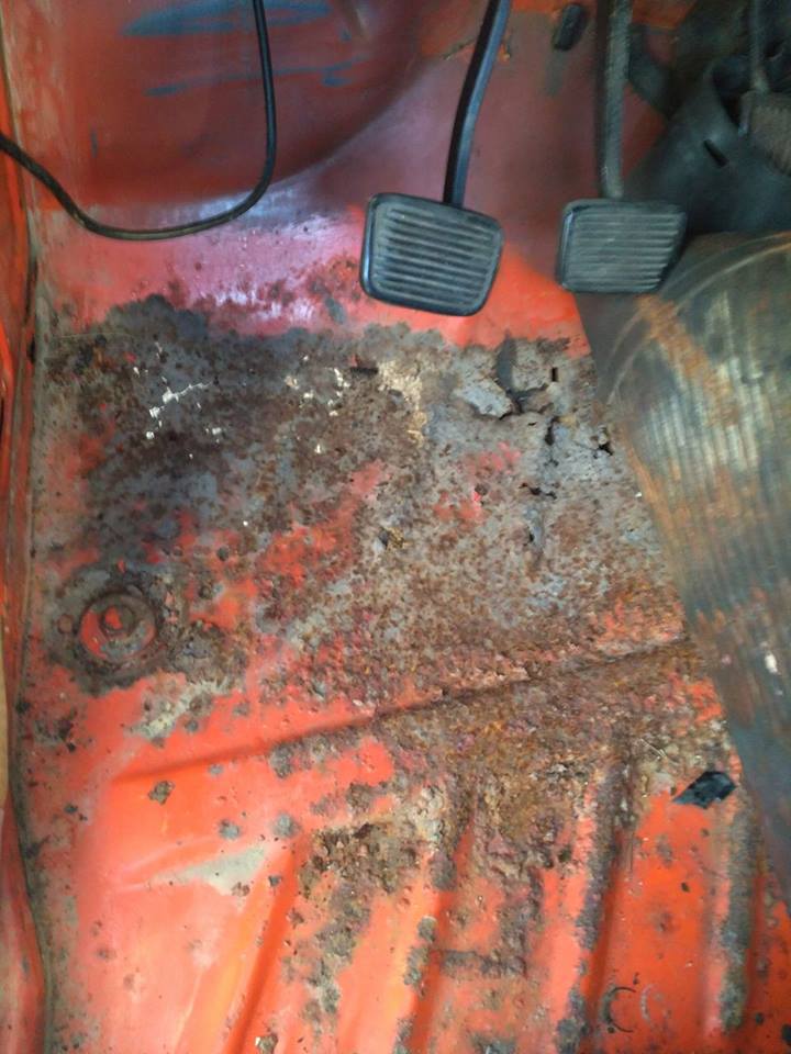

i am gonna fix the floor panels temporally with some sheet metal and for the future i got some new panels.
Anyone knows how many psi is the radiator cap?
PostPosted: Sun Nov 05, 2017 11:22 am
Posts: 203
Location: Blaine, WA
Radiator cap is 16 PSI.

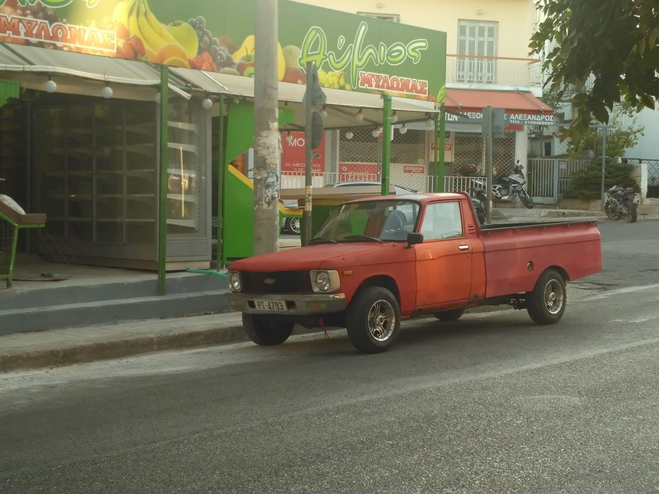

Finally i got my truck on the road
I put a weber on it and althoug it is not jetted correct it works much better than the nikki.
The disc brake swap works fine but the brake pedal makes a big travel so i will swap the master cylinder with another one from the next generation.
The brake light in the dash won't come off and i checked that the parking brake lever is missing the little plate that pushes the switch for the light.
Can anyone post some pics of the brake lever so i can figure out how it works to fix mine.
Also the speedo is not working and i believe that the speedo gear in my transmition is damaged.Is there any fix for that problem?
