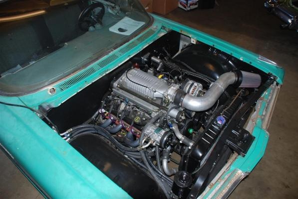

I am looking at the 6.0 deal too. Here is what I am looking at, this is in a friends 59 Chevy Wagon.
 Post subject: Re: 89' S-10 5.3
PostPosted: Sat Aug 30, 2014 4:48 am
Super charger and A/C , nice .
