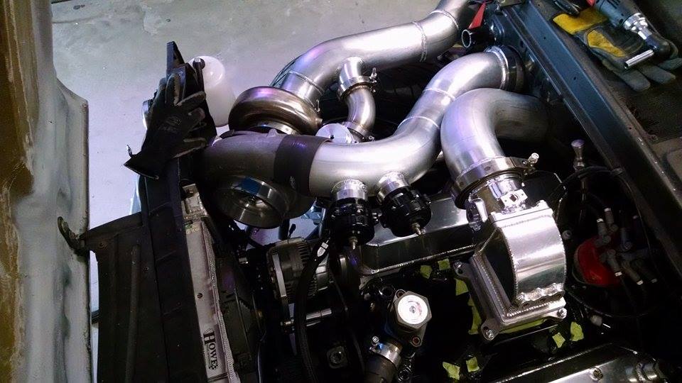

Here is some more.
Working on the cold side now
After trying to figure out how to route the piping to the intercooling in the bed, we tried to keep some leg room.
But opted for the simpler look running the piping through the center of the floorboard, and the passenger will have warm feet instead of warm thighs.
Here is the intercooler being mounted in the bed.
Starting to get close to completing the turbo kit. I am amazed at how its turning out.

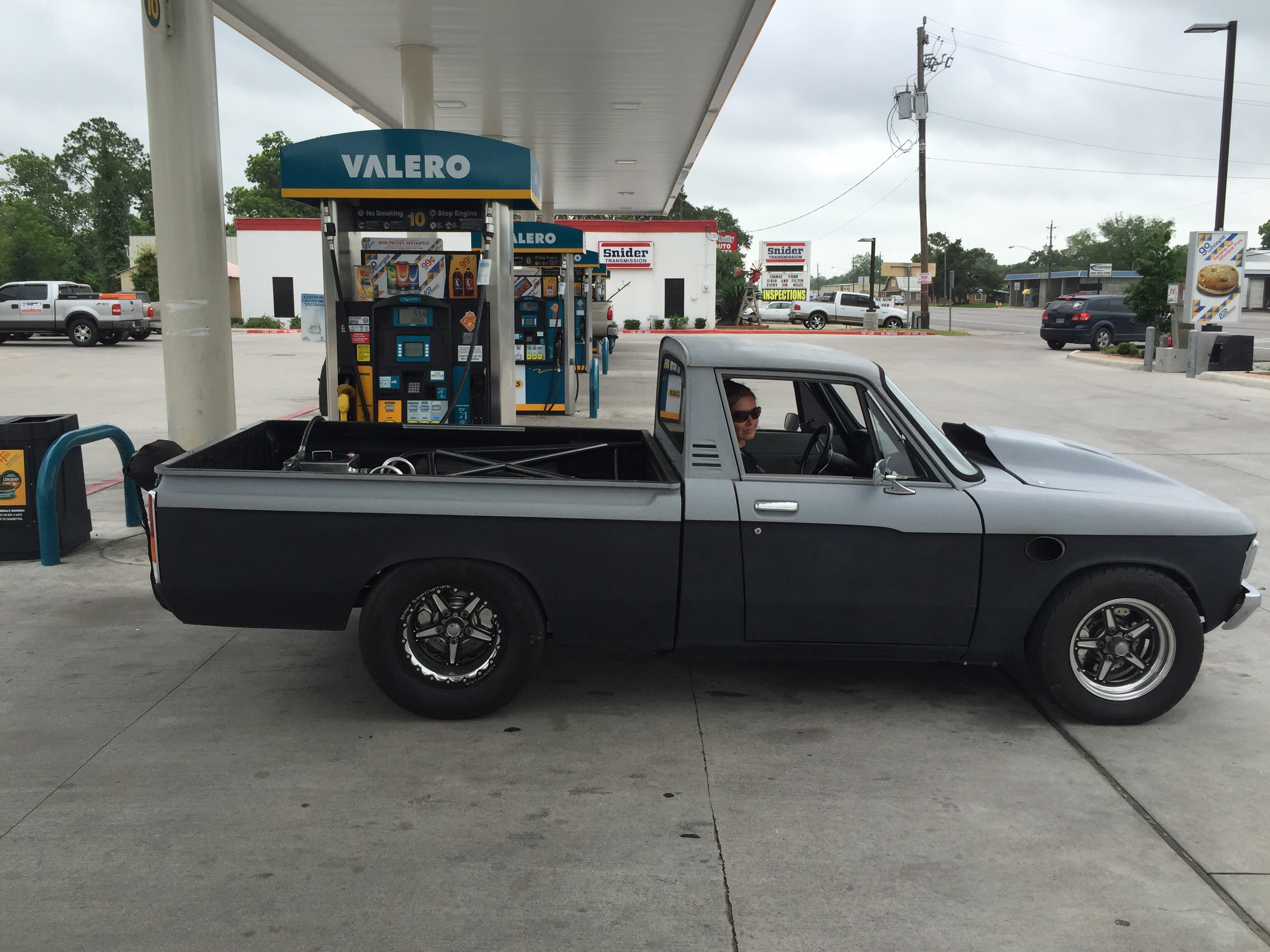

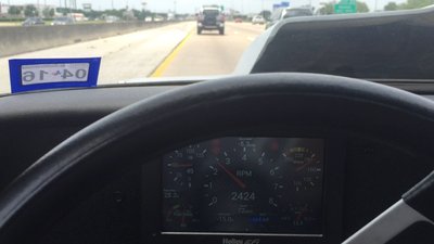

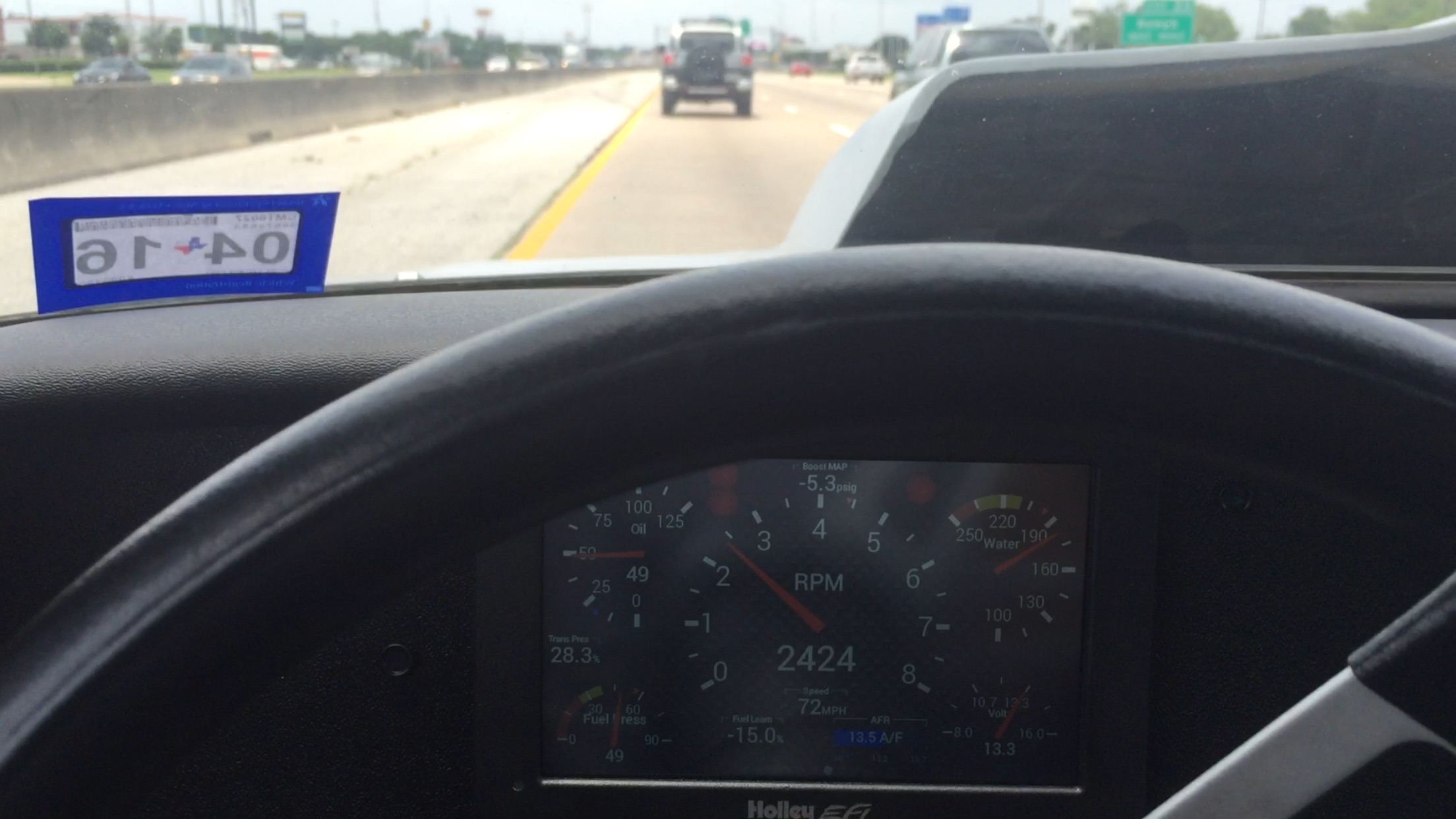

She's running. Still breaking everything in on a base tune but just on the Wastegate spring (5lbs) it feels good. I turned the C02 bottle on just to see what kind of boost it will make and it pegged my 3bar MAP sensor out. Once I get it lined out it should run decent.
PostPosted: Wed May 13, 2015 3:04 am
Your not at the E 85 pump ?
PostPosted: Wed May 13, 2015 5:21 pm
Joined: Wed Jan 04, 2012 12:27 am
Posts: 61
well yes, the yellow handle is E-85 but I am on 93. My fuel system isn't going to be enough for E-85 so I am on 93 until I add another pump and bigger injectors. Highest I have seen the duty cycle so far is 54% but haven't really made any hits longer than one gear.

I figured with Garrett involved it wouldnt be long before pump E85 was in the tank . And once you make the switch you'll never look back . That Holley dash is awesome.
