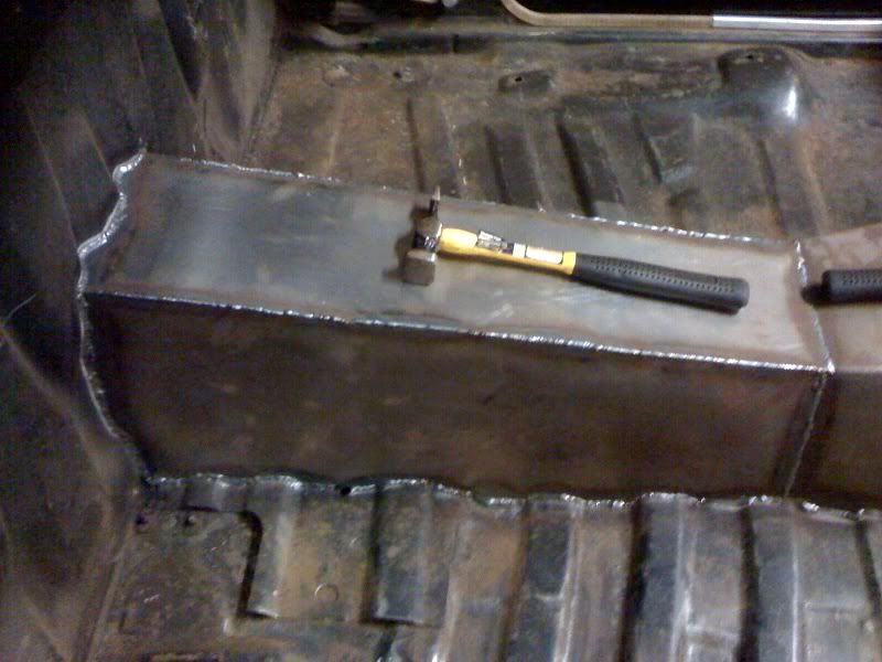

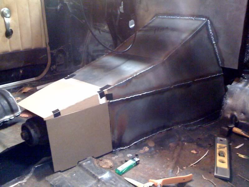

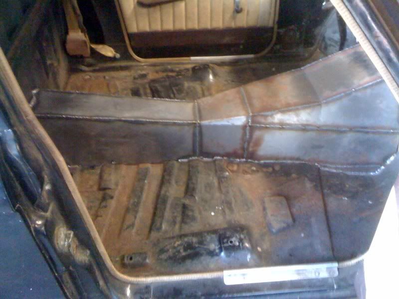

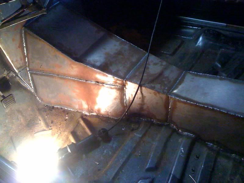

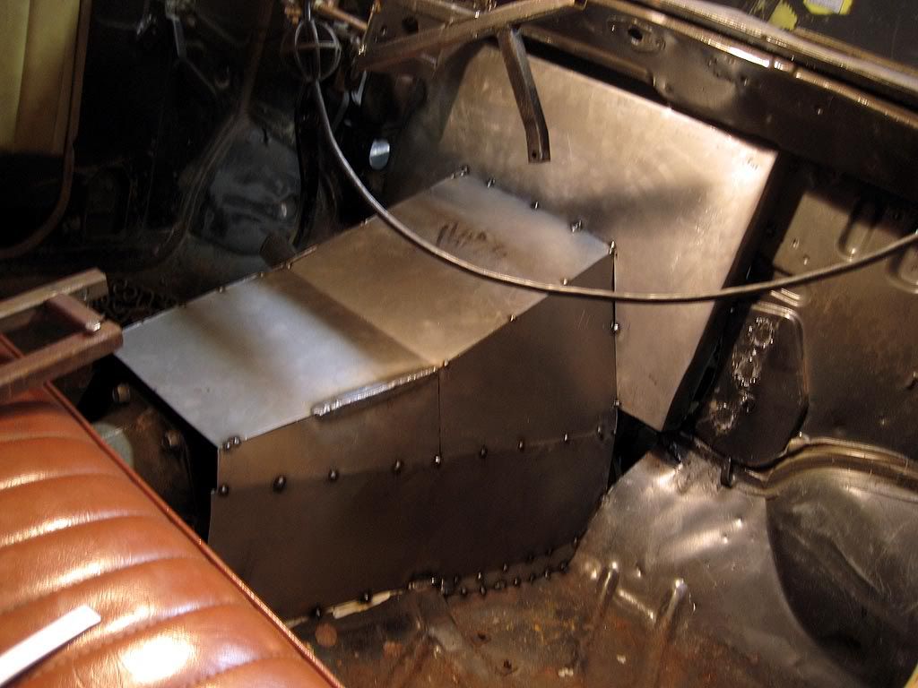

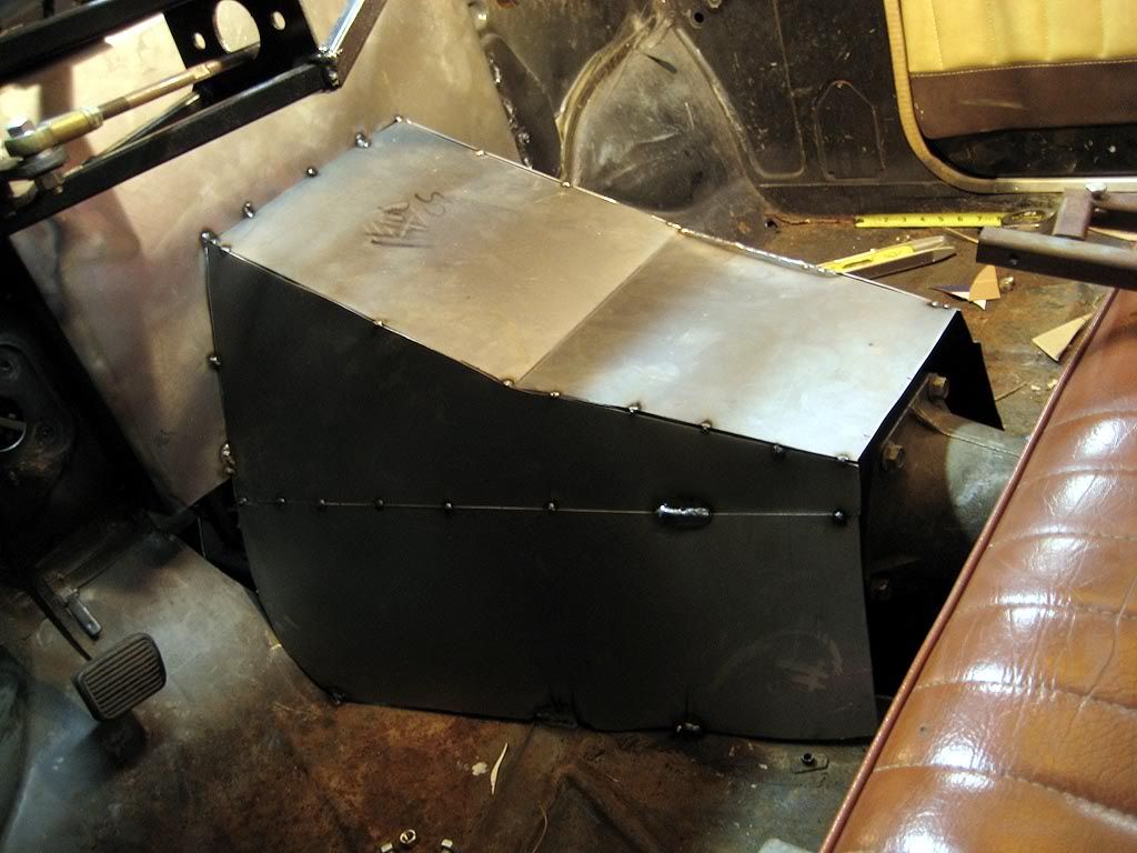

started transmission tunnel and firewall tonight. still not tacked on the driver side of tunnel by seat.. ill work on it more tomorrow.

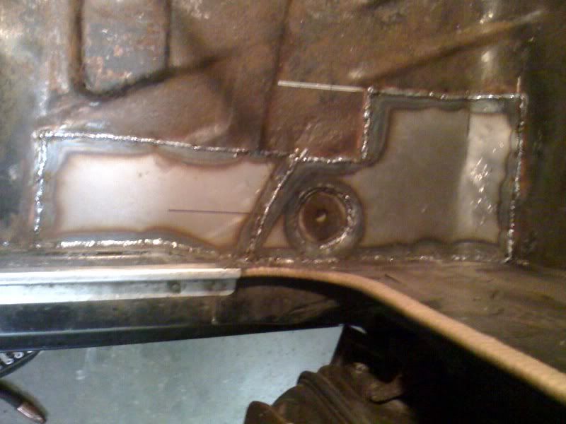

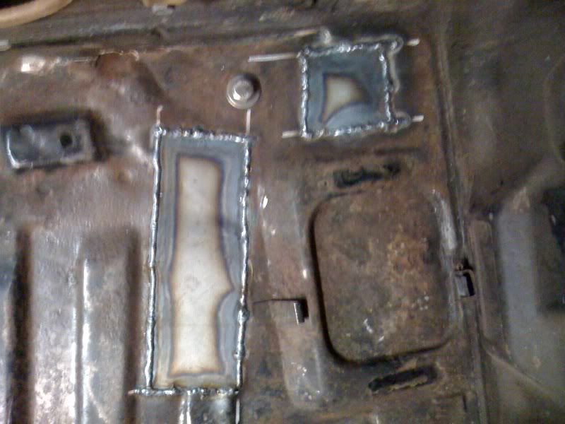

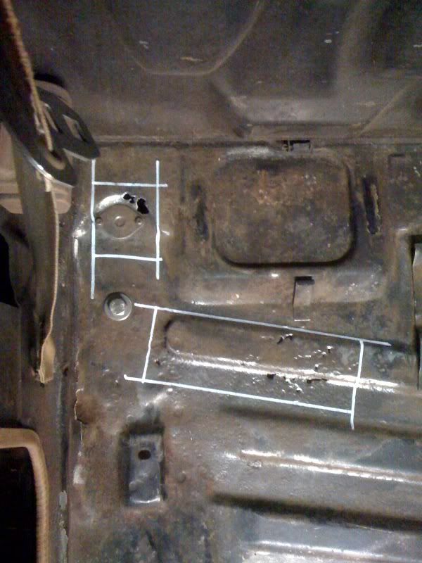

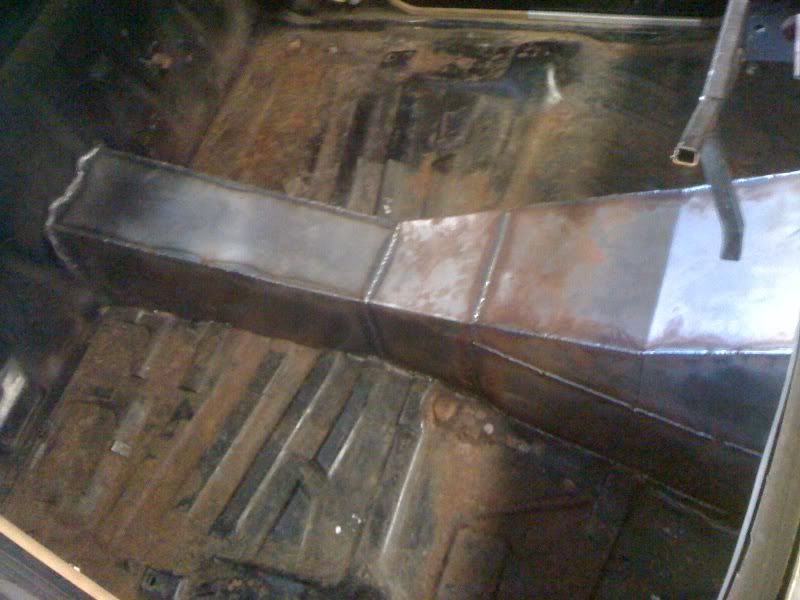

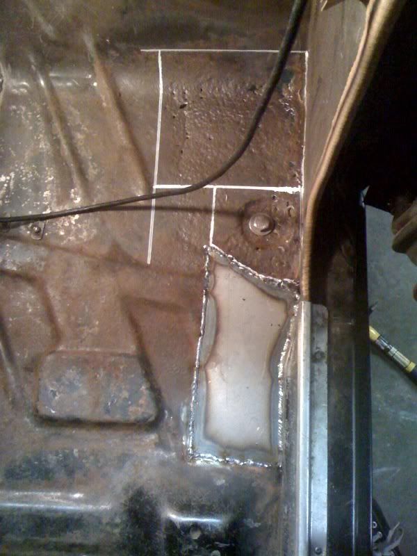

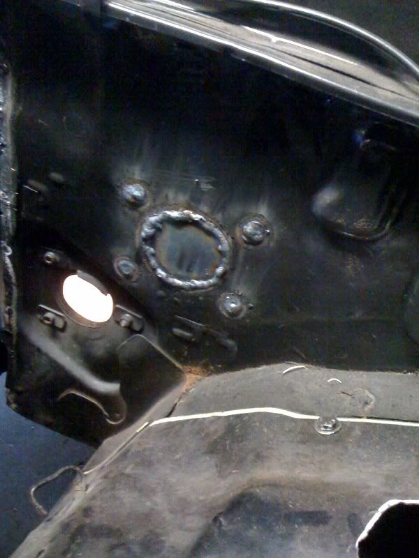

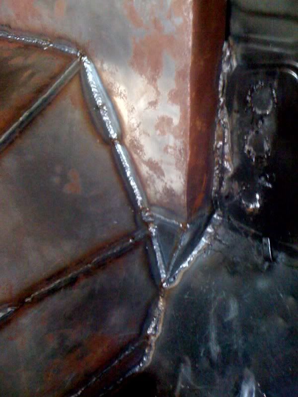

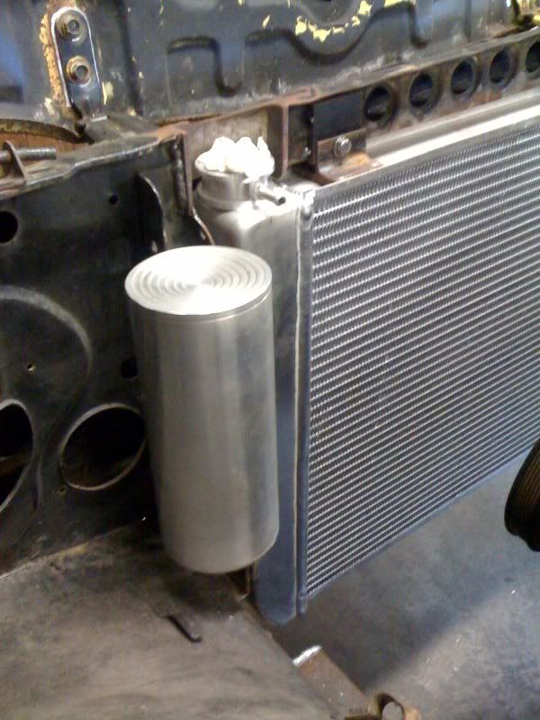

overflow mounted

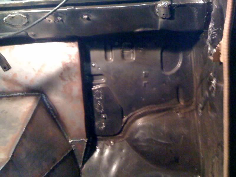

whole passenger side interior welding is done.
hoping driver side is as well.. need to wire wheel it to make sure.
booster holes all welded up

I take it you are MIG welding the parts? What wire size, flux core, or solid wire with gas, and/or what gas do you use? Those are some beautiful welds.
Rick
Loranger, La
1980 Stepside LUV (Again)
 Post subject: Re: LUV II
PostPosted: Thu Dec 24, 2009 11:22 pm
LSX LUV Owner
Posts: 1261
Location: Dickinson, Texas
yeah mig with 75/25 i think.. .030 wire. some welds look ok, others are meh. most the sheetmetal ones are meh.

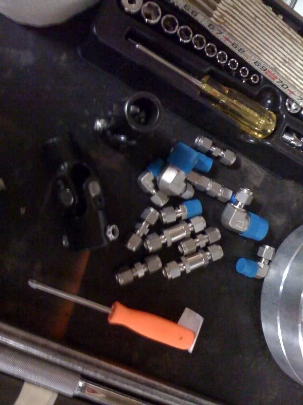

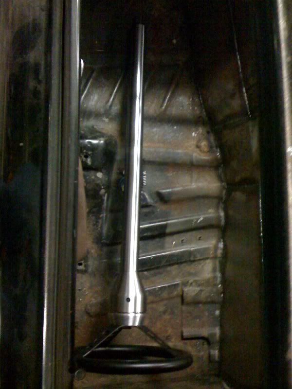

column and wheel.. ididit is a little different from flaming river so i took the column apart to see how it needs to be shortened, simple still, but more work than a flaming river. so if you are gonna have to shorten a column, get flaming river.
stainless fittings from mcmcaster
swagelok and steering joints
