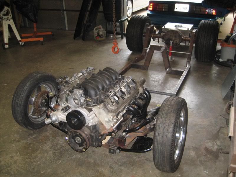

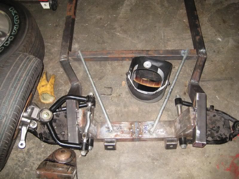

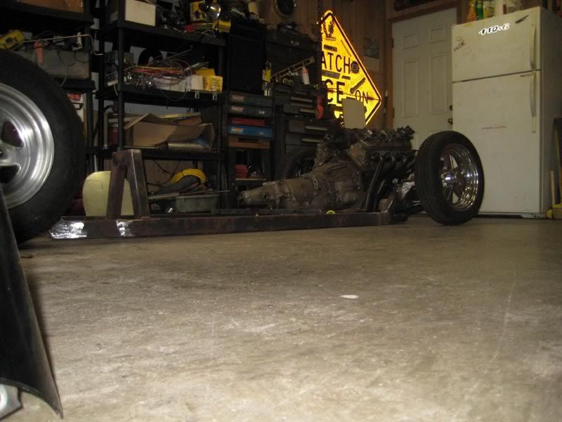

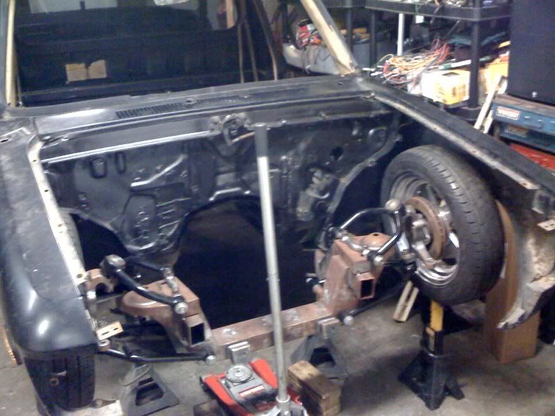

drop spindles on.. crossmember narrowed 3".. started welding crossmember in..

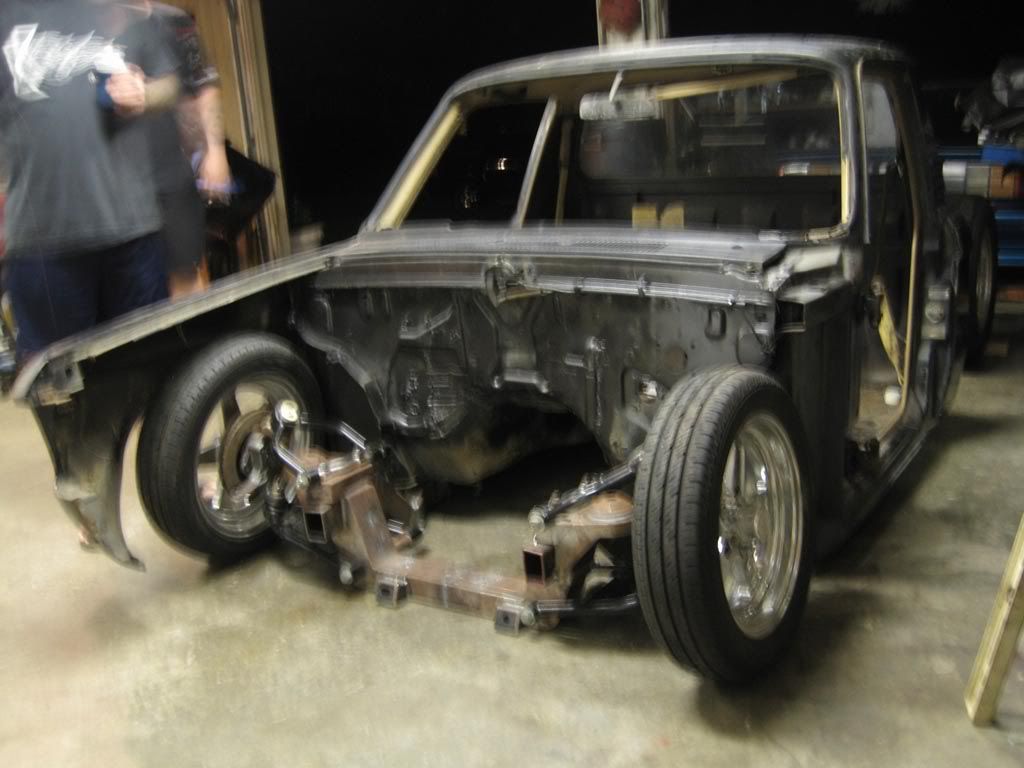

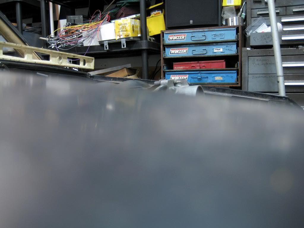

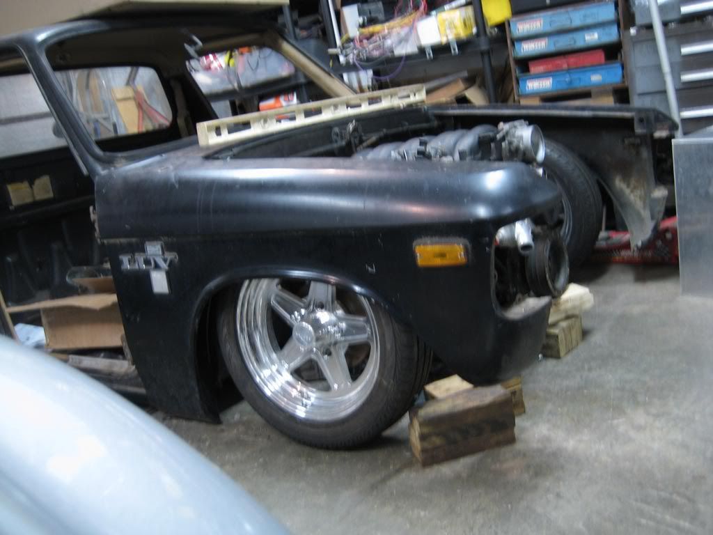

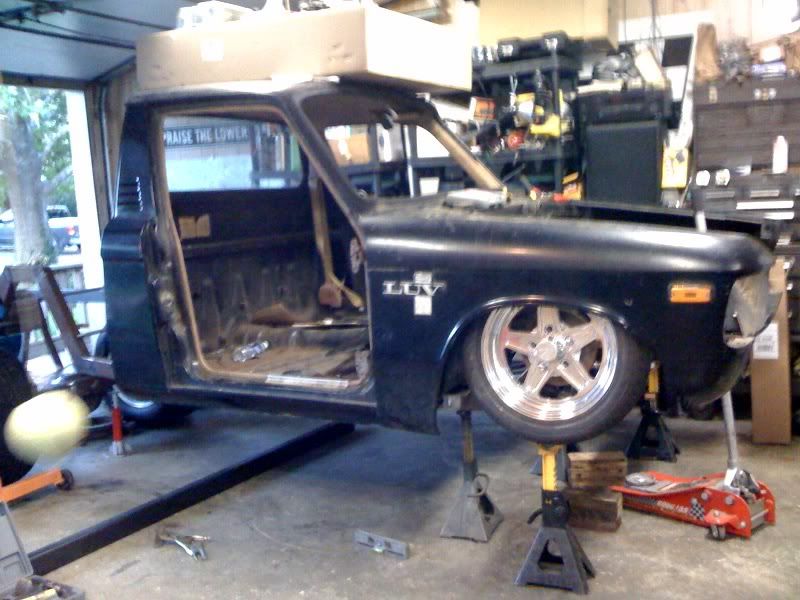

got cab on today.. frame clears the bottom of cab by like 1/2" easy.. will have room to run fuel lines on top of rails. woot. shitty blurry pics will do for now..
thought id add a little flare to the truck..
man i love me some 22" tall tires.. no firewall tubbing FTW!

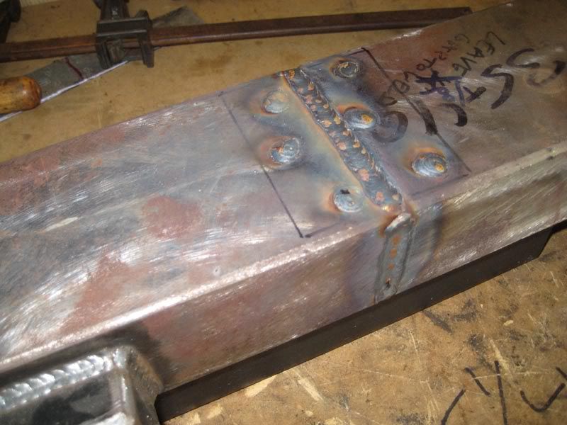

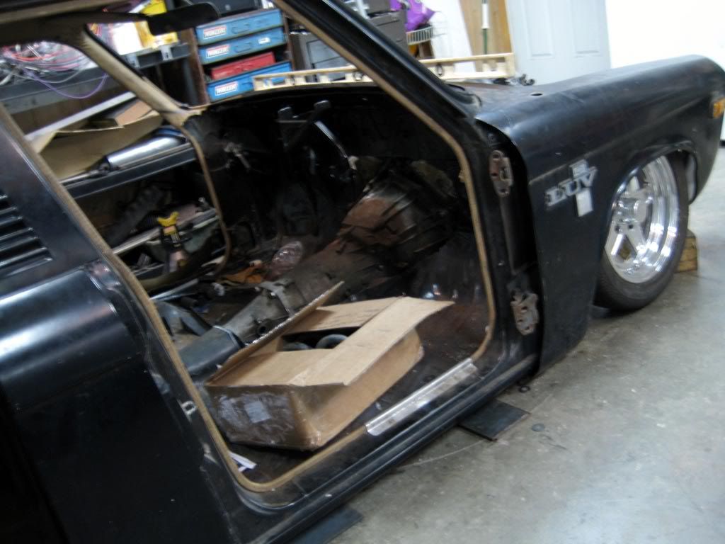

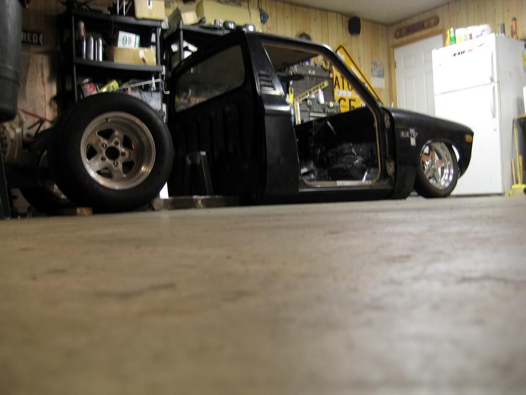

got body squared up on frame, tubes cut, and tacked up onto frame.. they will have two more tubes per mount to make sure its good and rigid. i spaced cab up off frame 1/4". will have to trim pinch, or fold it over some so the entire weight of truck isnt sitting on it..

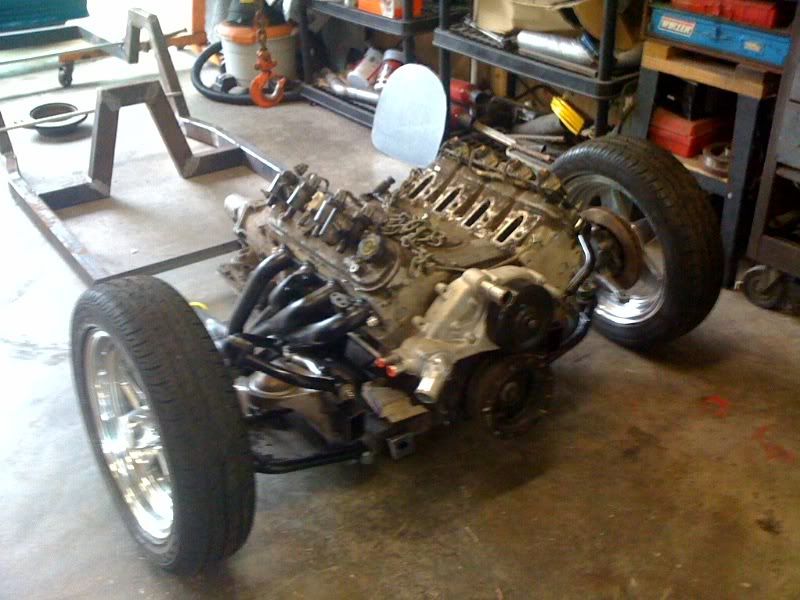

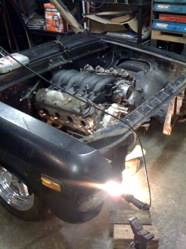

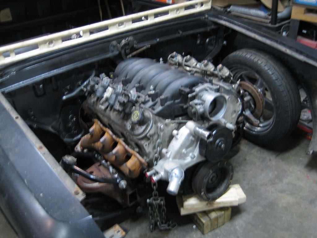

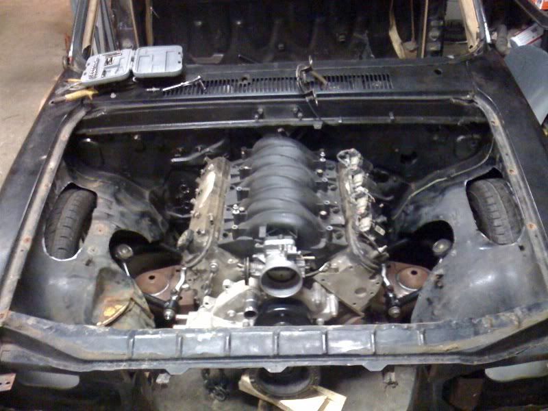

body mounts all welded up.. no pics as truck is on ground now.. tranny tunnel hacked out, motor sat in.. not positioned right yet. just stock in there to get a rough idea...

got the front clip all bolted up. a little more trimmed out of the tranny tunnel, motor pushed back some more. still might need to go back another 1/4" for oil pan/crossmember clearence. need an oil pan :(
