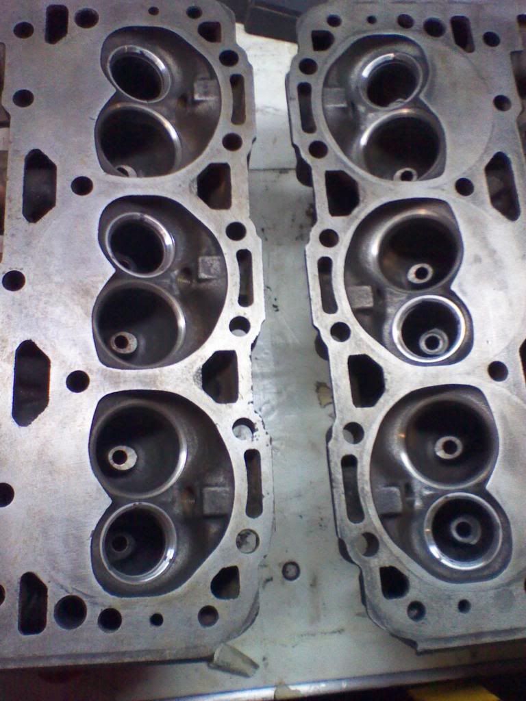

I don't know about a beast but its going to be a hell of a lot more fun to drive 8) im thinking it should have similar power to a stock 350 which is more than I will ever really need :lol: when its running I will get a dyno sheet posted, I realized yesterday I have already spent $3k on it and im still almost a grand from being done 8O

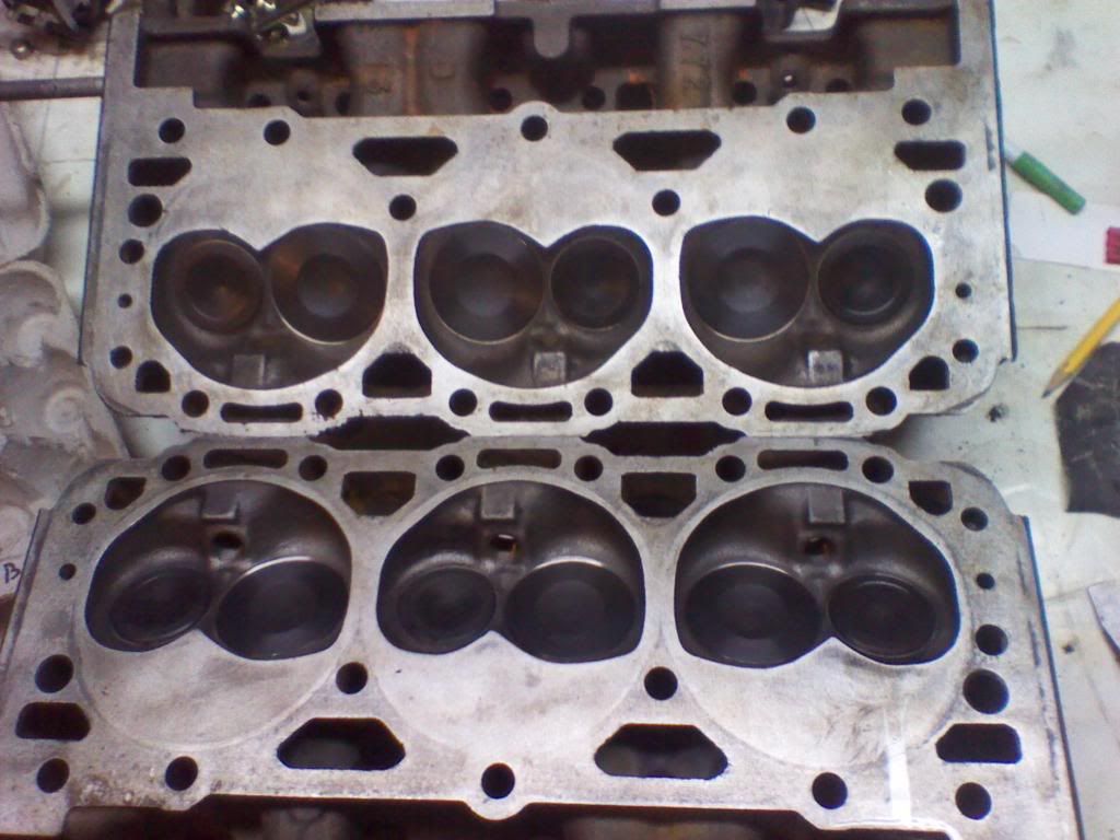

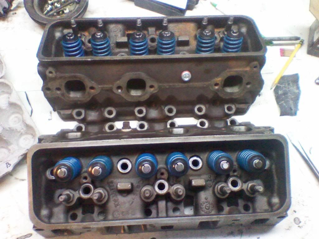

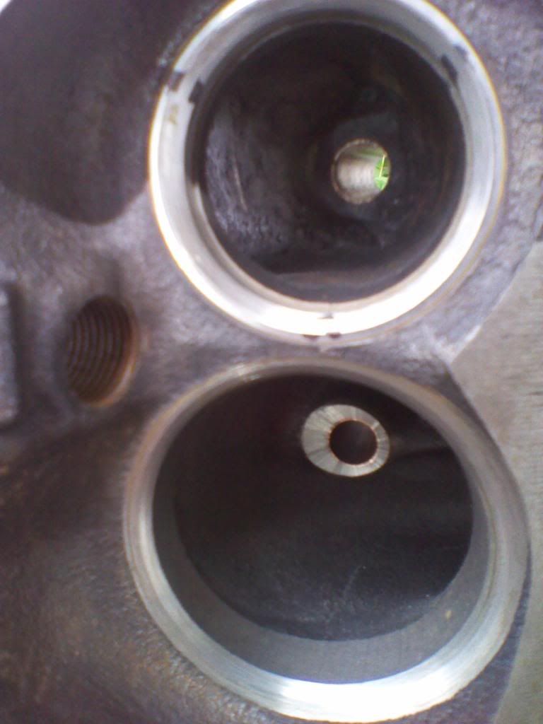

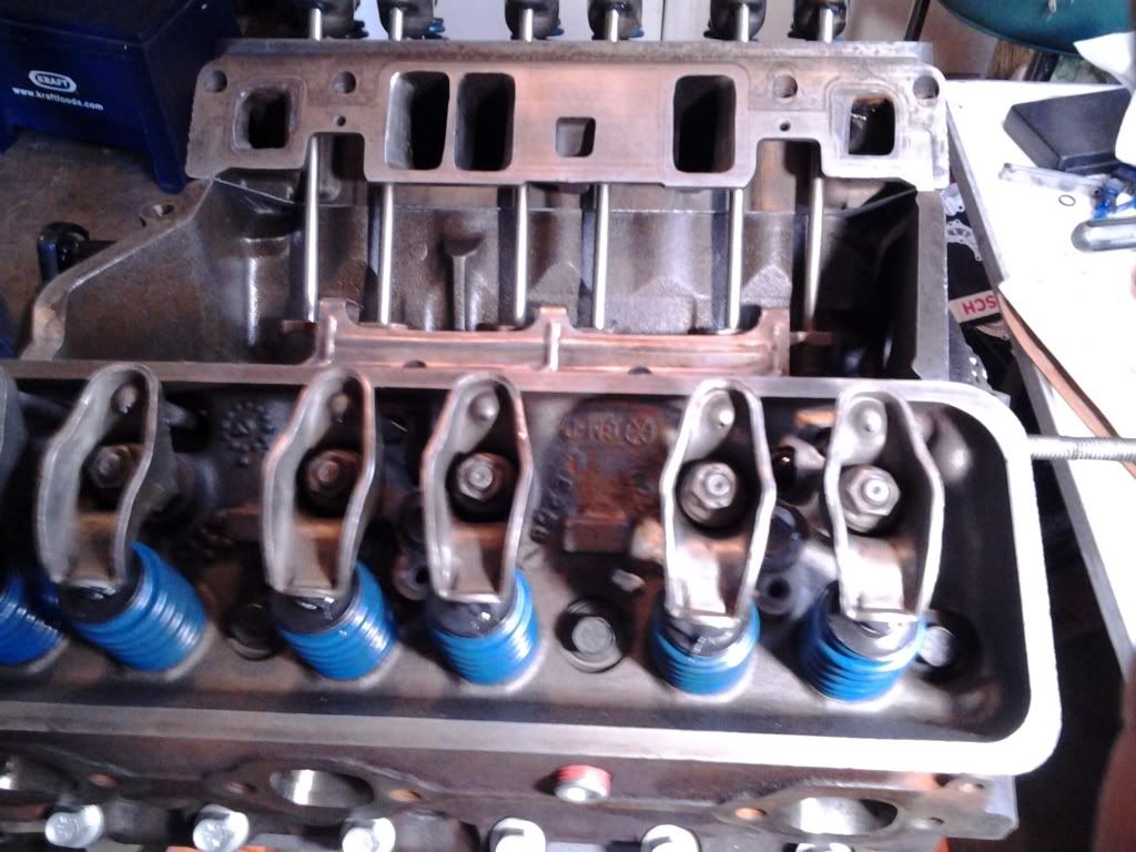

got my heads back from the machine shop, beautiful new exhaust seats installed and intakes ground. new guides installed. kind of confused tho, on one head he narrowed the extruded part the exhaust valve stem seals goes onto and gave me 3 seals that fit them... but not on the other head, im not sure why it was necessary to replace the guides.
should have them assembled this afternoon and on the block :ebiggrin my new cam will be here Tuesday, they had issues with their computer system and it hung in limbo a few days. engine will be good to go by next weekend :ebiggrin next weekend I will also be getting my transmission from picknpull, have to find one from a 1500 truck and find a np208 case with it hopefully
PostPosted: Sat Sep 21, 2013 3:55 pm
made some progress today

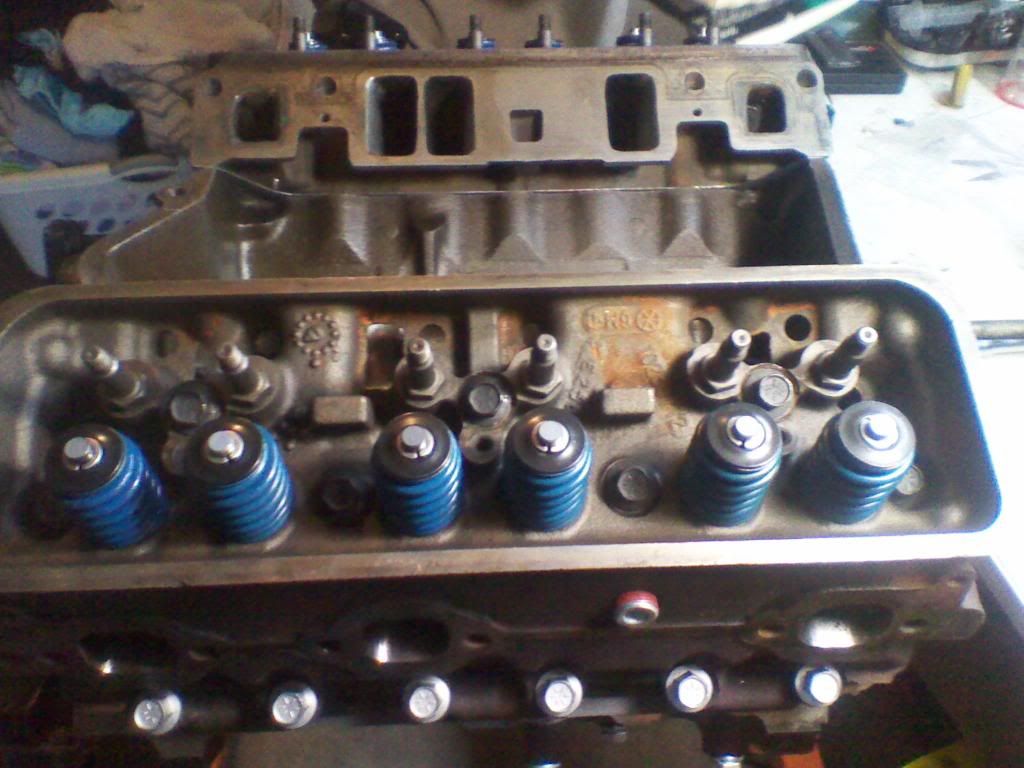

springs and valves installed
cleaned them up with brakleen
and they made their way home :ebiggrin :ebiggrin
spent another hour cleaning up all the dirty oily parts im re-using, oil pan, push rods, rocker arms, p/s pump/lines, oil filter adapter/lines, misc brackets etc.

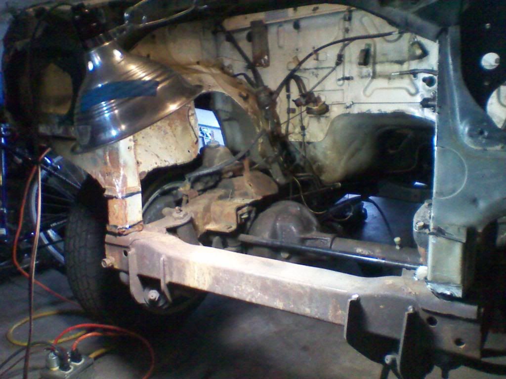

Made some visible progress today 8)
new brakes installed both sides, using the stock calipers so I can move the truck around the garage until I get the caliper brackets off a trooper

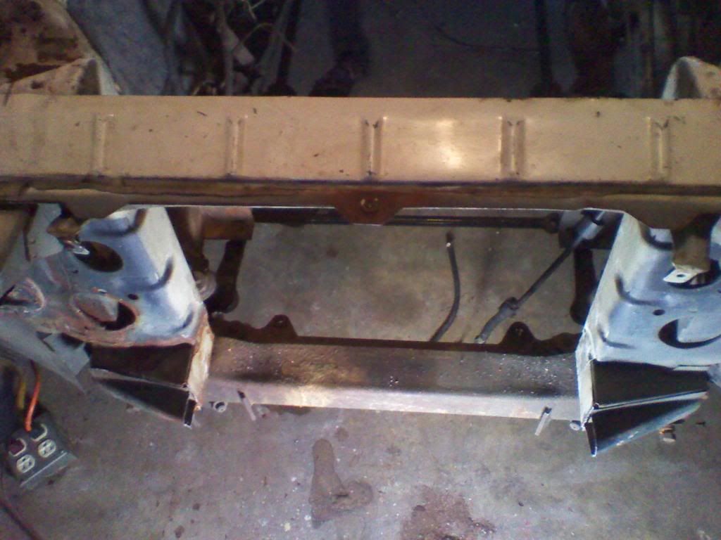

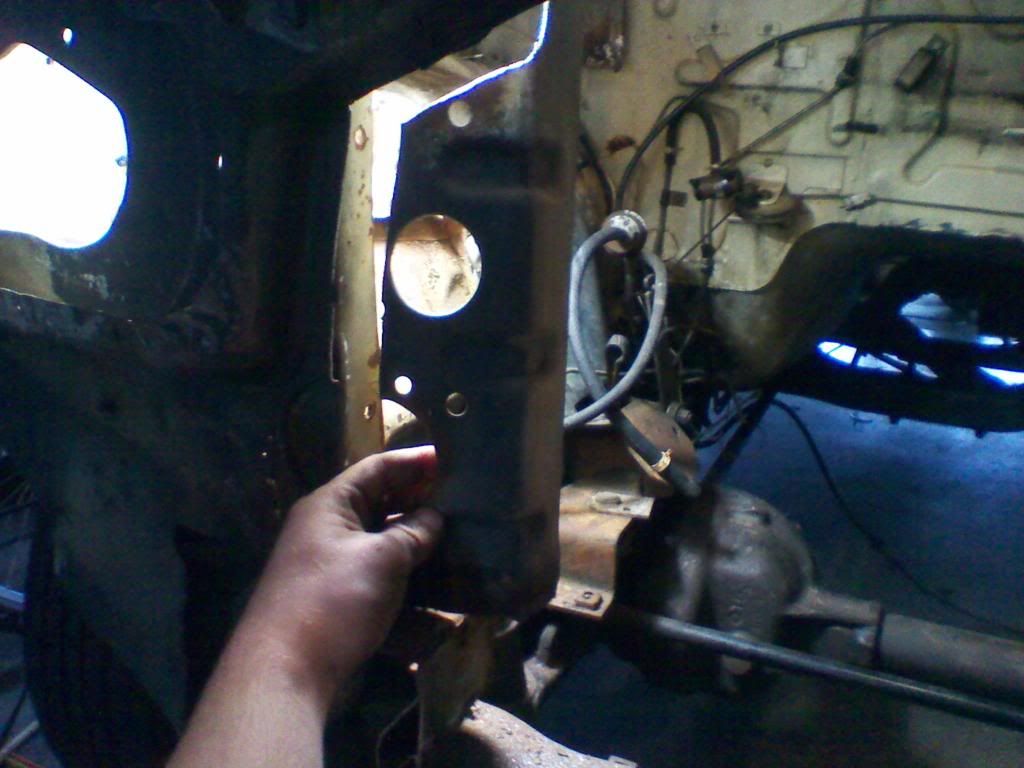

cut out the bent up core support
another shot of the core support out and the straightened out passenger side headlight mount
cut out the battery tray, still need to grind parts of it out
spent a bit of time carefully cutting out the sides of the radiator opening to fit the new radiator. going to trim the extra material off and weld it back in place

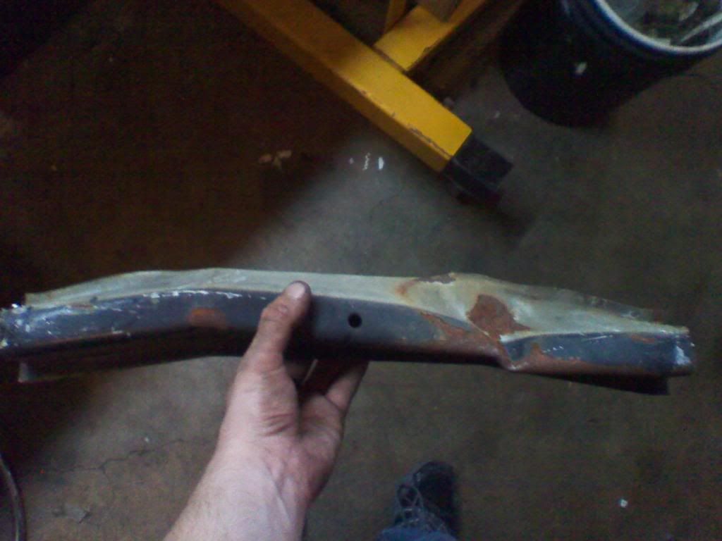

cut out the ends of the bent support, afterward I smoothed the rough cut edges out

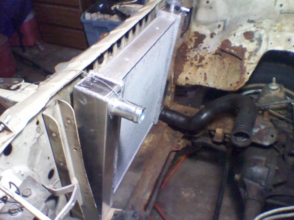

fit the new radiator in the new gaping hole and measured for the new width of the mounting flanges, as you can see the filler neck just barely clears the top (on the left)
it is fit at an angle for the clearance with the radiator cap
the angle of the installed radiator
my dad and I are going to fabricate a new support to replace the one that was cut out, picking up a welder in the next couple days, going to make a U shaped rubber cradle for the bottom of the radiator to sit in and a bolt in L shaped bracket for both of the top sides
didn't get a picture of it but I also mocked up the new grill, headlights, valance and hood and everything clears perfect :ebiggrin

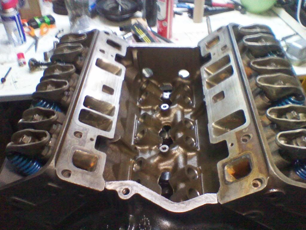

PostPosted: Fri Sep 27, 2013 11:32 pm
cam is in, timing set is installed :ebiggrin
need to install the lifters and pushrods in the morning didn't have time today
picked up some vht paint for the headers and hi temp for the engine. did some more sanding on the intake manifold its about ready to go on.
couple more weeks and it should run 8)

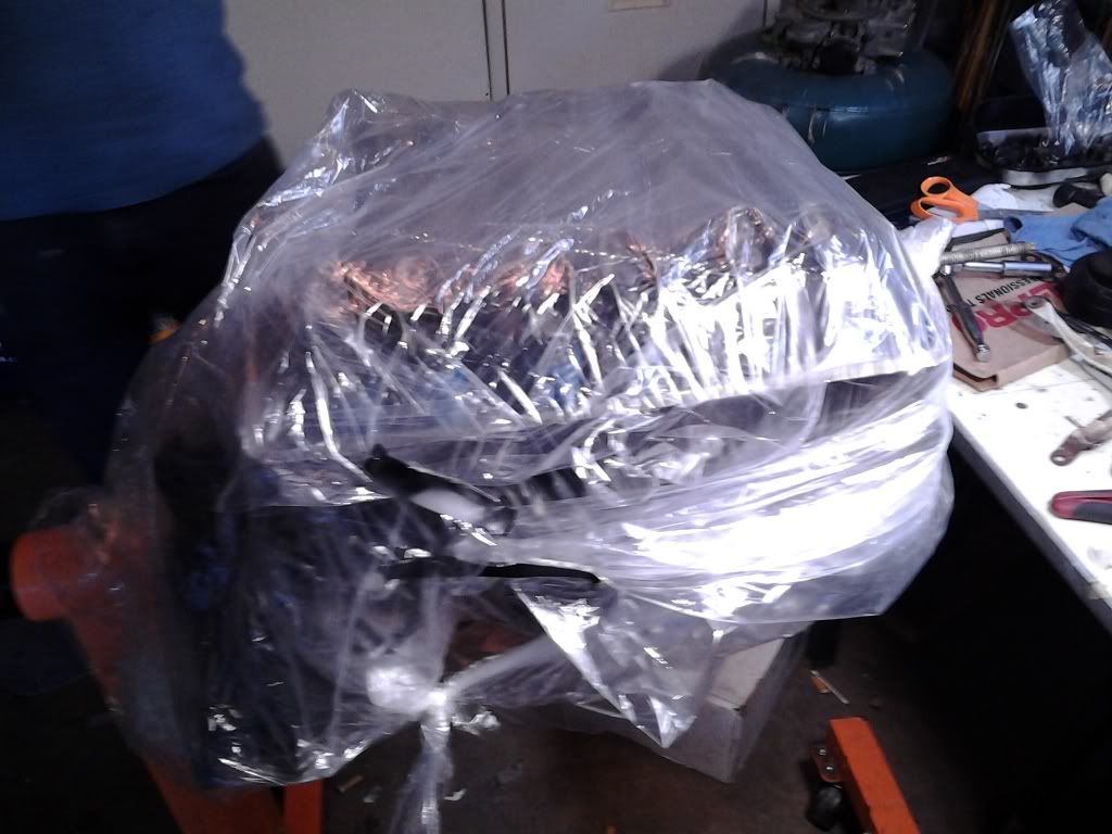

complete rotating assembly is together
been keeping it wrapped up while im not working on it and replacing the plastic each time... cat hair is the biggest PITA I have ever come across... been using the leaf blower to keep it out :lol:

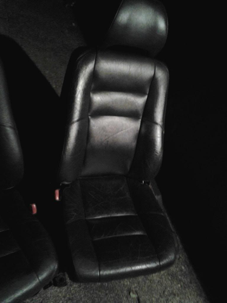

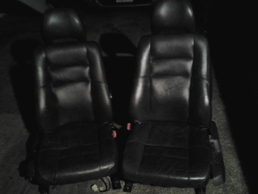

did get myself some seats from a buddy. they were in some sort of Volvo not sure which. going to mount them on the stock rails the ones they have are oddly shaped and really tall. I like the shape and support of them a lot they are really comfortable plus the adjustable lumbar support will be nice for roadtrips
