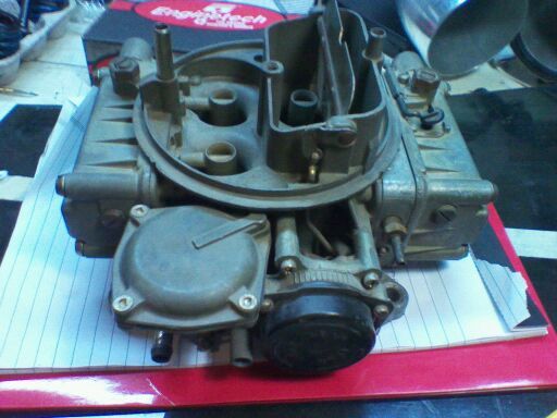

im trying to decide between a 390 and 450 cfm holley.. got the outrageous idea to bore a 390's secondary butterflies and fit the 450's shaft and butterflies to make a hybrid 420cfm, but that would be a much later project when I have a day or two with a mill and a few bucks for a carb core :lol:

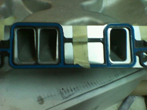

spending my afternoon sanding and smoothing up the new intake manifold, I don't like the look of the rough cast aluminum... this is a hell of a process tho no wonder they charge so much more for a polished one :lol: the installation instructions say to port the intake to match the heads so I figured I should check them against the gasket...
bear in mind the opening in the gasket for the single port is about 2.5mm wider than the double ones are so its not as bad as it looks. going to port it with that in mind and keep them same width like the heads,

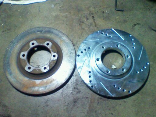

I got my new front brake rotors, calipers and ceramic pads
the old ones looks like this :esad
and the new ones :ebiggrin

and I got a 450cfm holley 4 barrel, list #4548, as far as I can tell was is off a ford 289, thankfully holley still has the rebuild sets for it.

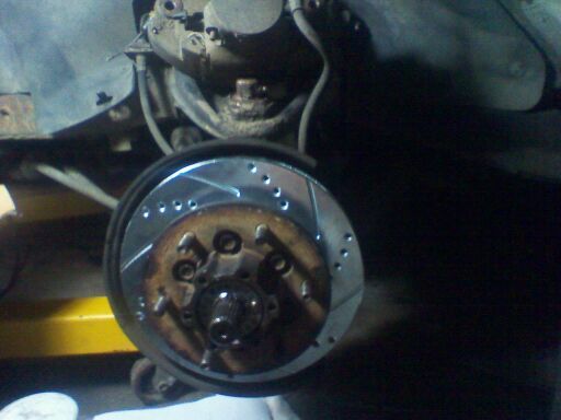

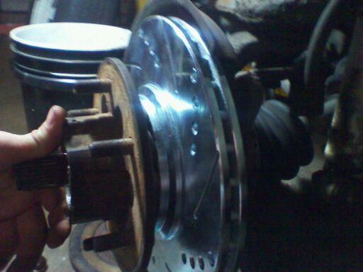

im half way thru pulling the rotor off the driver side right now to check the fitment, the bolt pattern is the same for sure (the 5 hole pictured is a generic pic the rotors are the 6 hole we use. they also have black and gold zinc coated rotors but I didn't see the point :lol:
I still need to pick up the trooper caliper brackets for the calipers. I bought rotors for an 85 to be sure they weren't the post 10-11/86 style
by tomorrow I will have them checked for fitment so I will let you guys know if they are the ones to buy for our trucks or not. I figured it would be worth a try to get a more heavy duty rotor/caliper combo, coming down from the mountains I have had my brakes cooking pretty good and smelling really hot so I figured whatever cooling boost i can get will be good.

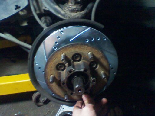

well good news the rotors fit great
couple comparisions old vs new

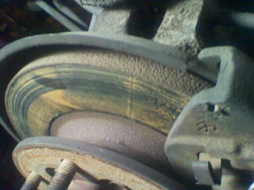

clears everything, bolts right up to the hub, this was the correct direction of rotation on the driver wheel, I changed them around before the next pic wrongly thinking it was the better way..
this is not the right direction of rotation this is the passenger side rotor on the driver wheel don't install this way, you want the outside edge of the slot to contact the pad first not the inner edge of the slot. the cooling vanes in the middle of the rotor are straight up and down and non-directional as far as I can tell so im going by the slots.
edit: right way around

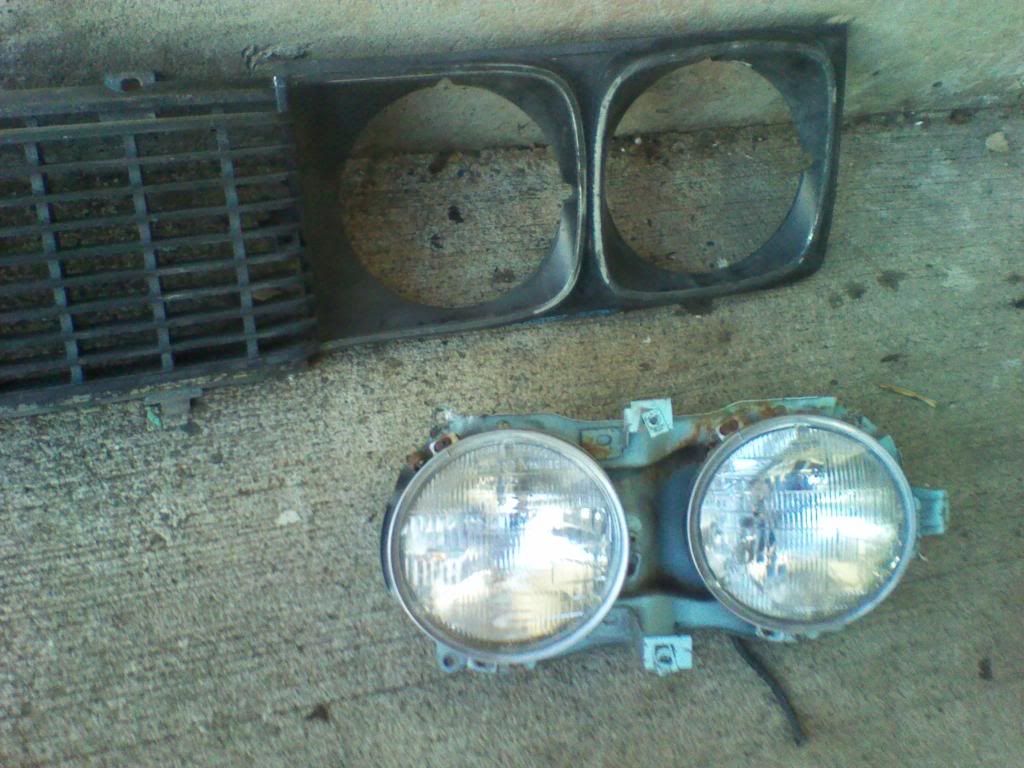

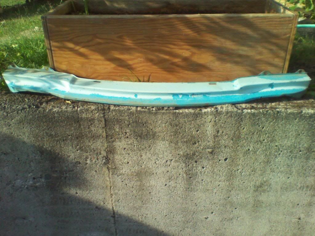

took a trip down to salem today to get some body parts off a 77, couldn't find anything local and this one has the 4 light setup I prefer the look of. got a great deal on everything, will be getting the bent body straightened out so I can mount the new lights
got a good straight hood
grill, headlight bezels, lights and the light brackets
and the valance from under the grill
I did find the fan and shroud I will go see about the shipping on monday
