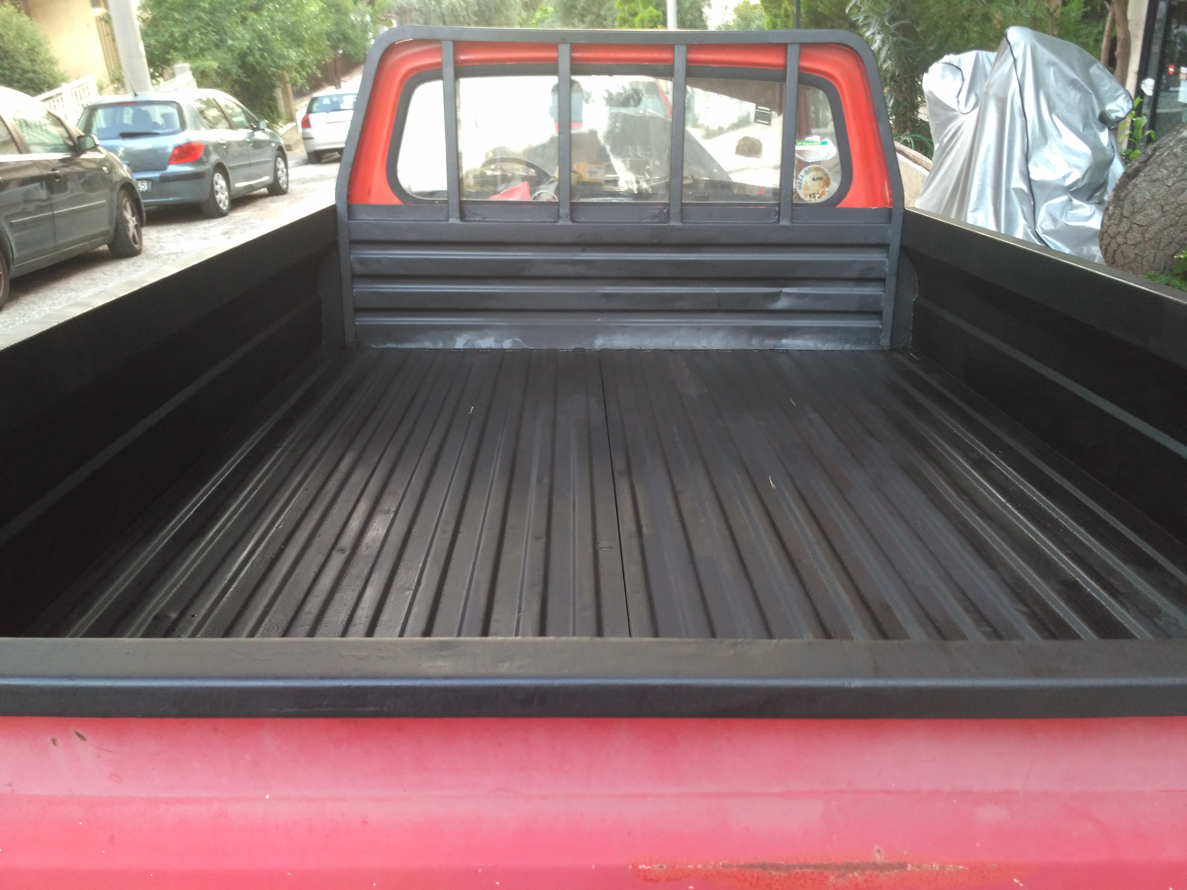

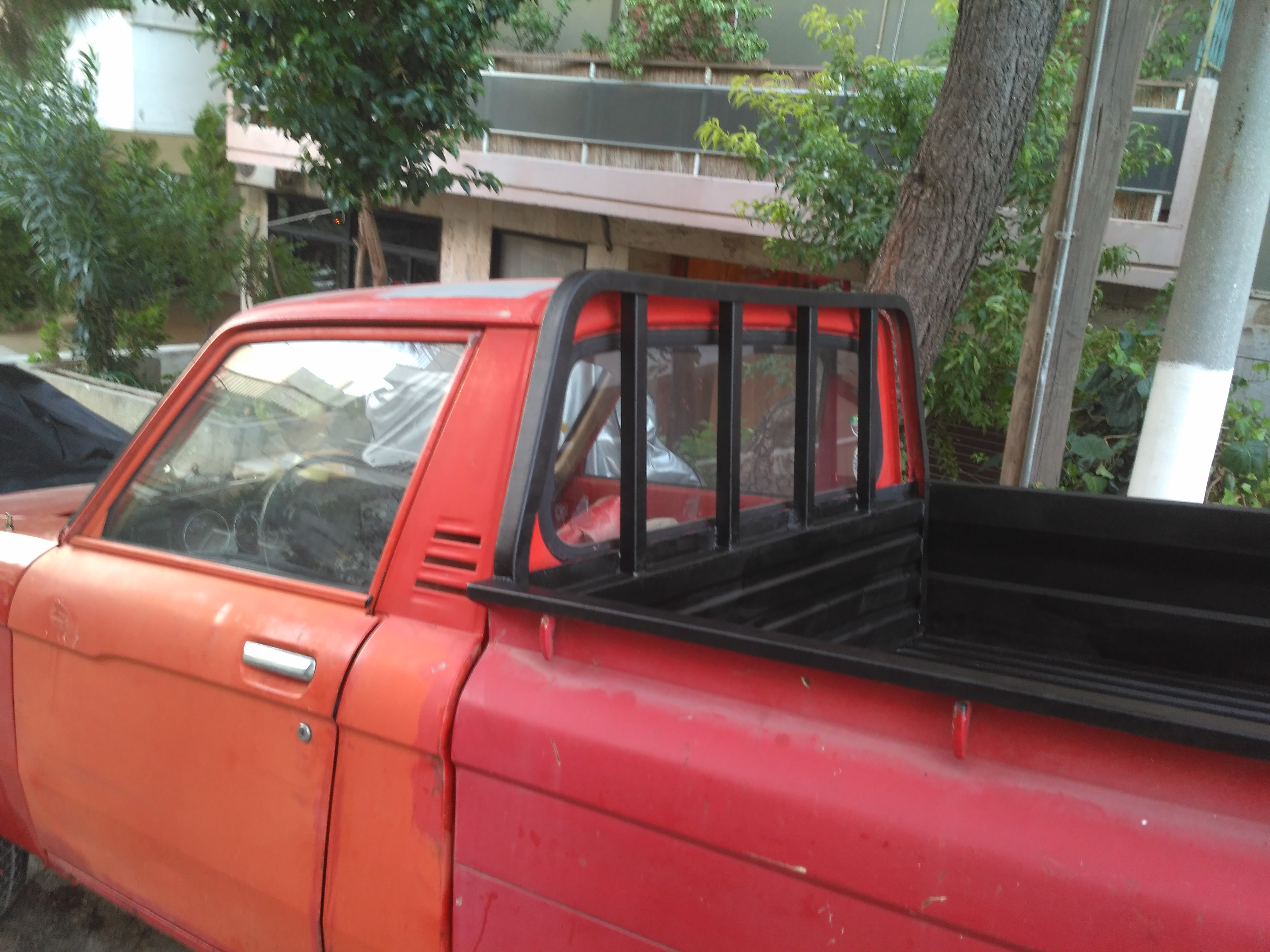

i painted my bed black

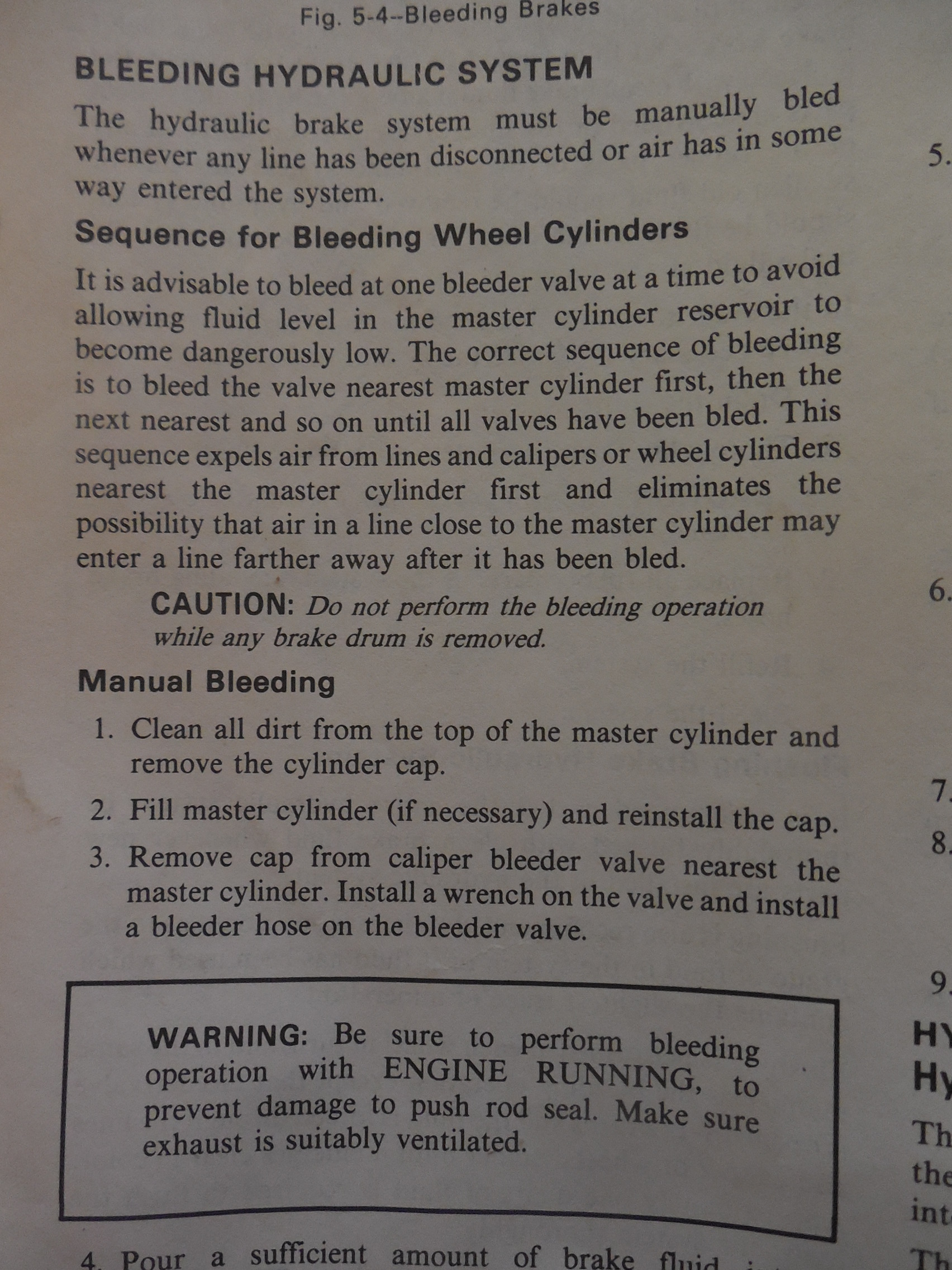

Start with the back brake furthest from the reservoir, do the other back brake second, do the front brake furthest from reservoir third, finish up with the last one.
It probably doesn't really matter if you do the back first or second if you have 2 separate reservoirs, that's just a good habit to get into.

I've always bleed the furthest wheel cylinder 1st and work closer when bleeding brakes BUT for some reason the shop manual CONTRADICTS THAT
& tells you the correct sequence of bleeding is to start w/ the nearest to the master cylinder first then the next nearest & so on ....ALSO gives a warning to do so while the engine is running.....Here is a picture from my Series 6 Shop manual.

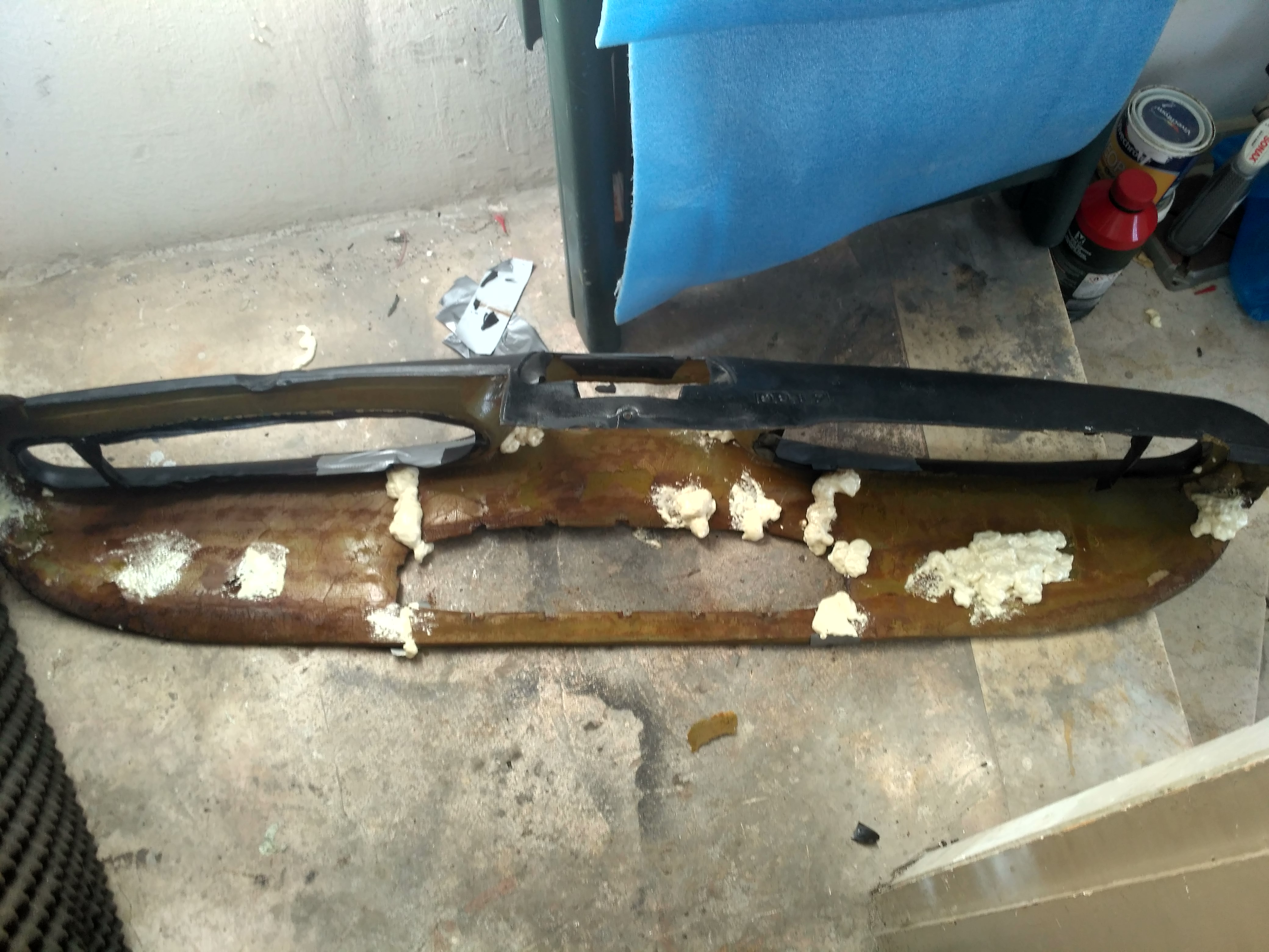

One more question.How can i remove the dashboard?Is it glued on the metal under it?Does it need to get the windshield out.
PostPosted: Sun Aug 20, 2017 12:15 am
Posts: 607
I've taken a couple off at yards I removed the parts off the dash and slowly pull it away where you can and use a putty knife separating foam from metal dash apart in the all openings, all around slowly working all over till ya get it free

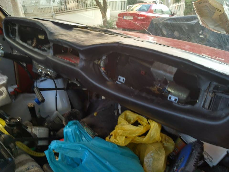

I removed the dash and repaired it my self as good as i could cause no shop here said could fix it.

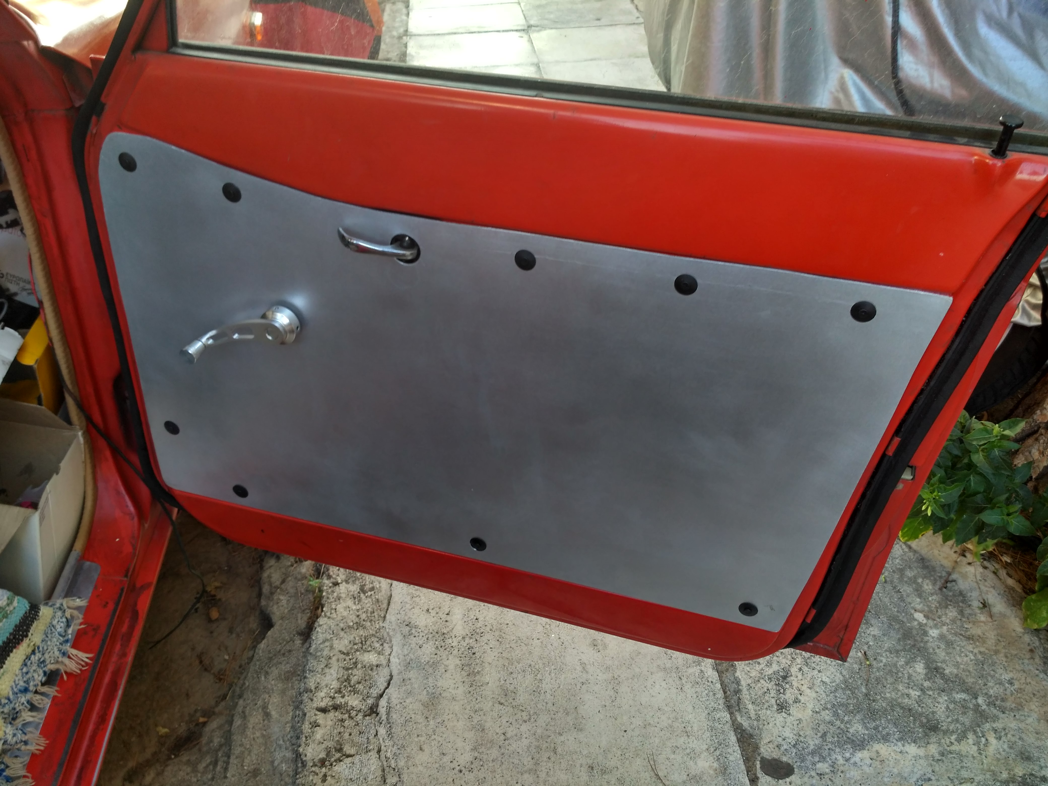

Made a pair of aluminum door panels.
Took the heater core out and send it for repair.

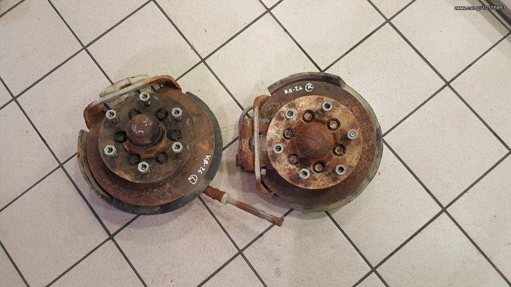

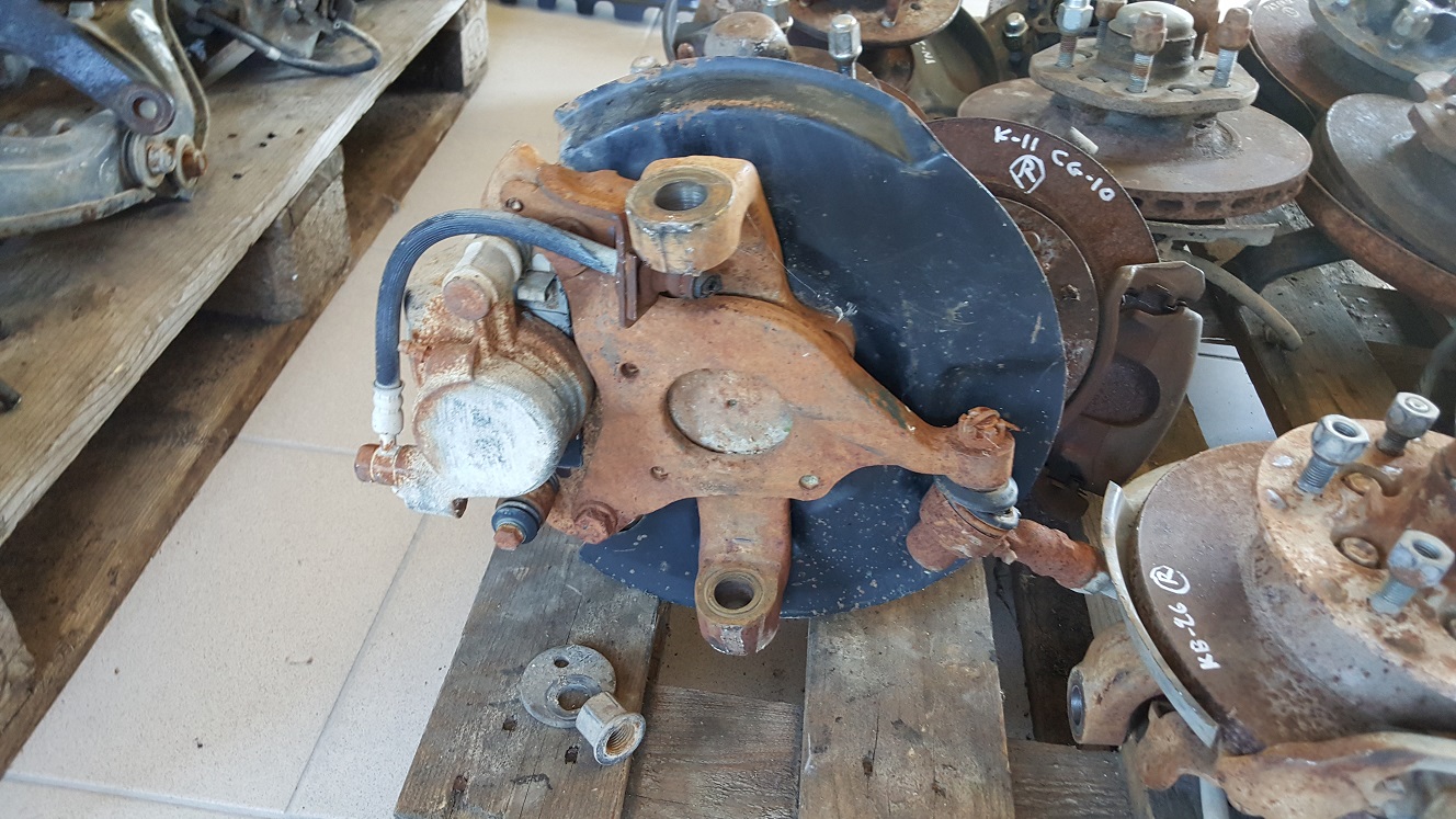

I got tired of waiting for the wheel cylinders to arrive.I believe the parcel is lost.So i am thinking of going for brake discs swap.
I found a complete from kb26.Do you know if i can fit them on my luv?Is the spindle the same?
PostPosted: Tue Sep 12, 2017 12:06 pm
Assuming there are no bizarre differences between the kb and the luv, this article should be helpful. http://www.luvtruck.com/Information/Brake_swap.htm

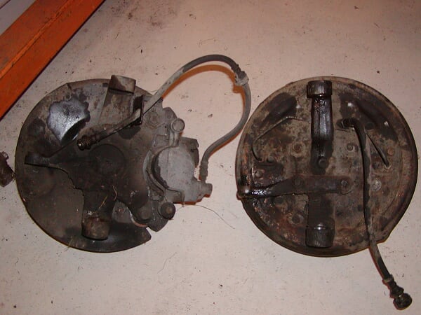

i asked from the seller a rear view pic of the brake discs spindles.
Whar do you think?

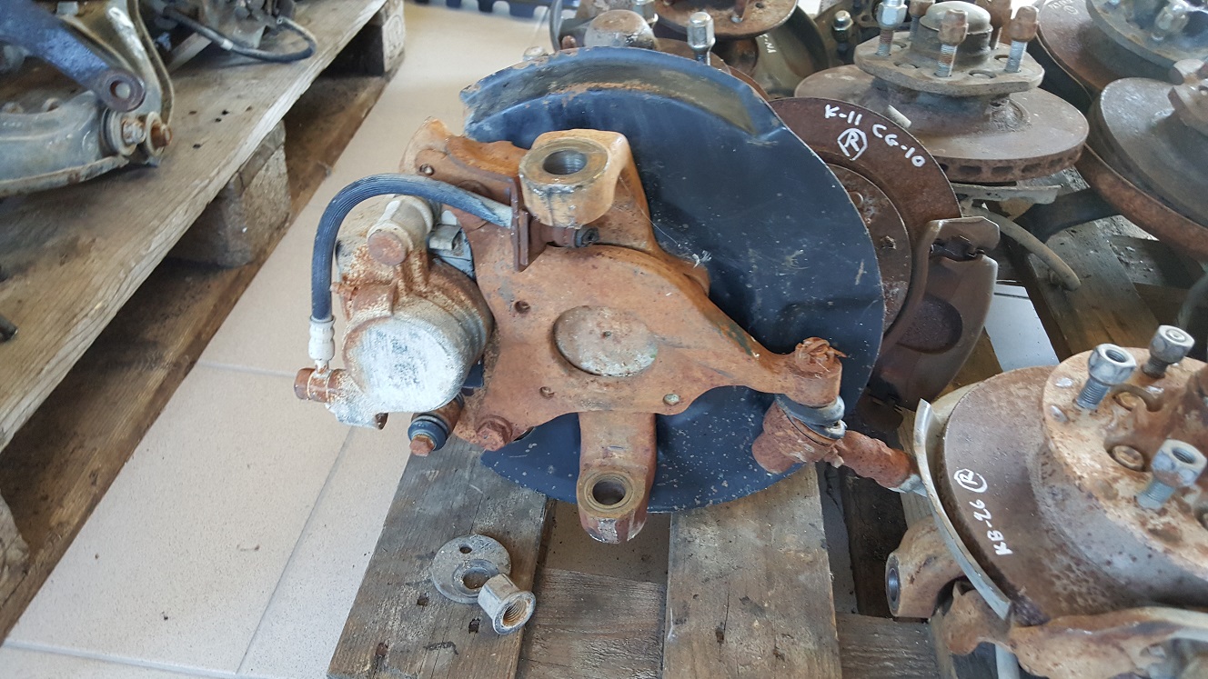

I am trying to figure out a way for the front disc swap.Do you know if i can use the front ends of a 4x4 luv?

I can t find any discs from a 2wd to swap my brakes so i was thinking about the 4x4.
Last night i was searching on some very old posts here and a guy here used the brakes from a pup on his luv so i think that is what i am gonna do.
Only difference is that the the mount for the tie rod is a little higher.
PostPosted: Wed Sep 20, 2017 8:08 pm
Posts: 1702
I'd get in touch with oldestisuzuist. In my opinion, he is possibly the most knowledgeable person here (and on isuzupup.com) about what crosses over between what we call the "first generation" and "second generation" LUVs.
