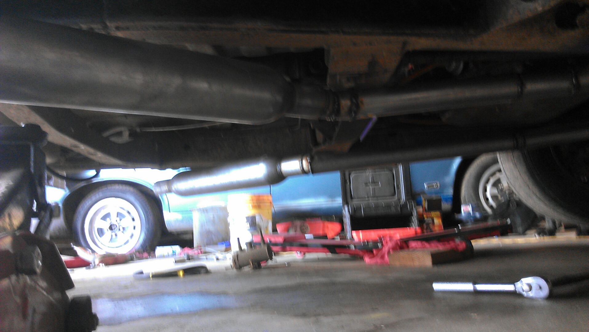

Yep! Almost got the exhaust finished last night, driver side is done, passenger side just needs to be welded the rest of the way, ran out of gas last night :/ right now its just 2" pipe with glasspacks . Will get upgraded later on and mitered the all the cuts, so no fancy bends, I like the look more over pipe bent with a bender, but it took a lot more time to do.

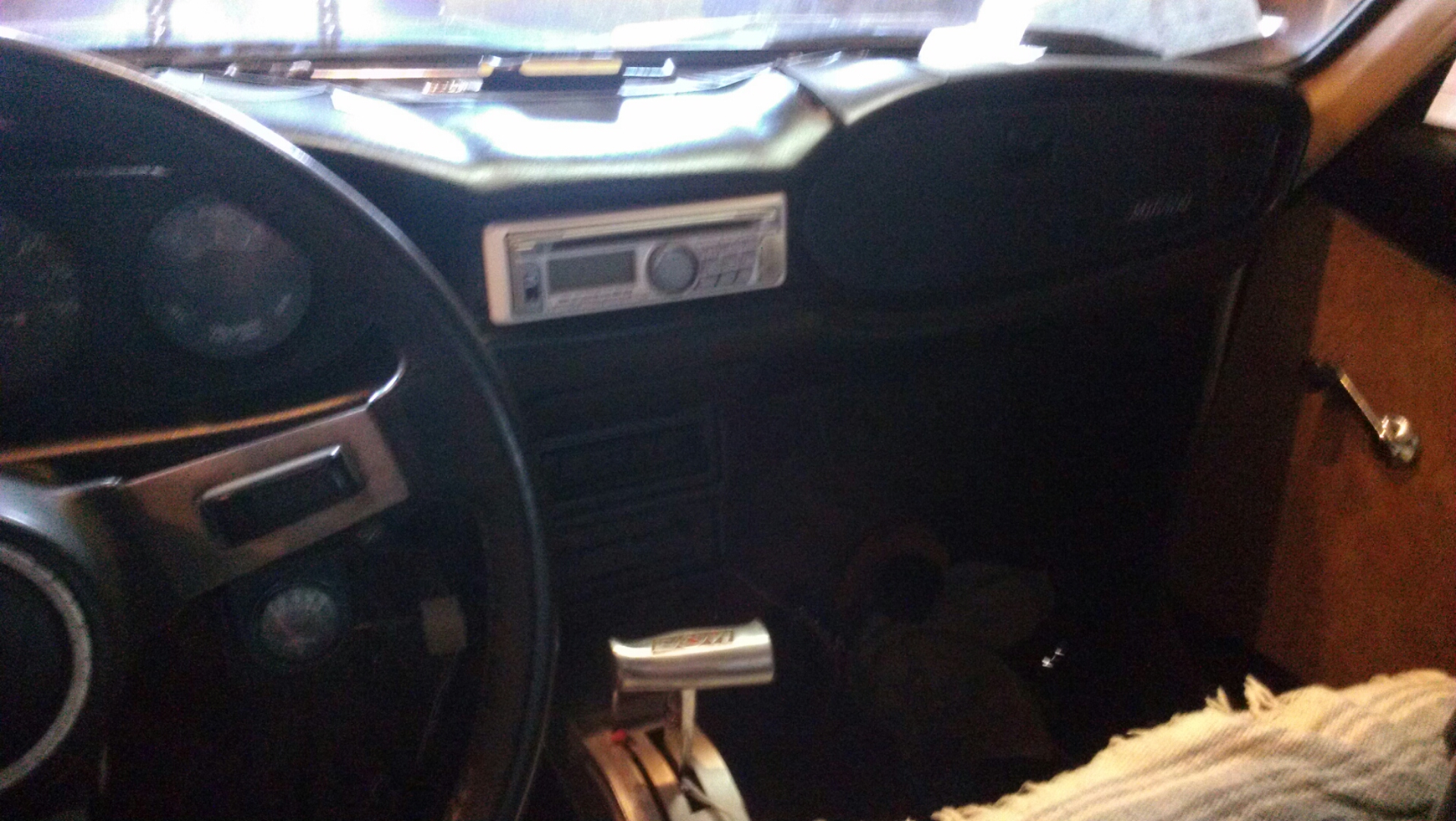

Installed one of my head units today, along with 4 6" and 2 4" speakers powered by an amplifier. have a 12" sub also but the box wouldnt fit behind the seat. Guess ill make one someday

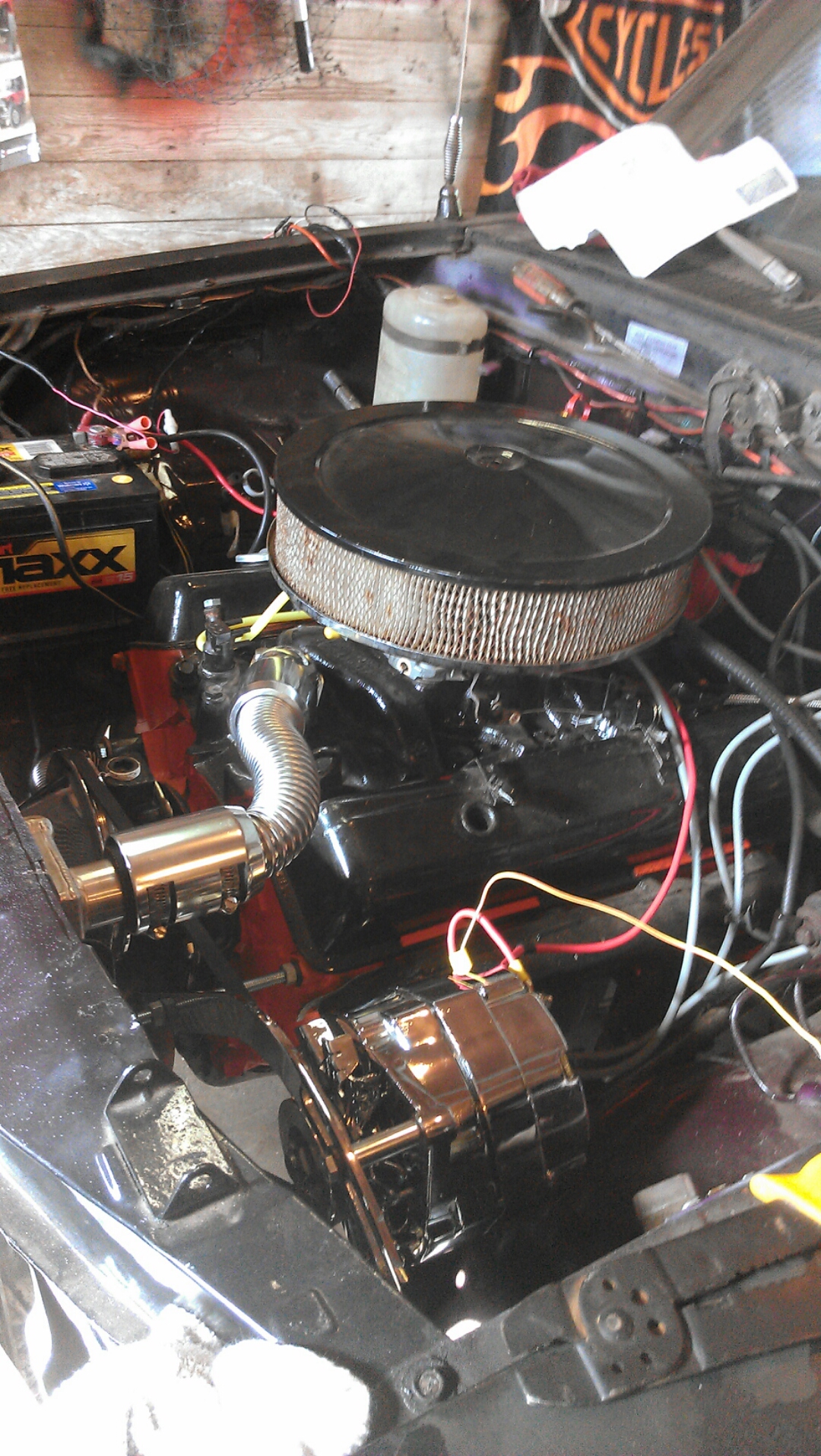

couple pics. got stuff done today. finished and installed exhaust, installed fuel pump, got the right size belt finally, wired up alternator and bought some more tranny fluid. all that left to do is pour gas in the tank and bolt on bed, adjust the fuel pressure, make sure fluids are good and I can take it for a spin! if there is no leaks or anything.

Fired it up and let it run for a little bit. Fuel preessire regulator is weird and I can't figure it out. So I bypassed it. Have a leaking tranny hose which will be replaced. Thing is loud! And shakes the entire truck haha. Gear drive sounds great as expected :) tomorrow ill pick up the hose, top off the tranny, figure out fpr and fingers crossed take it for a spin
