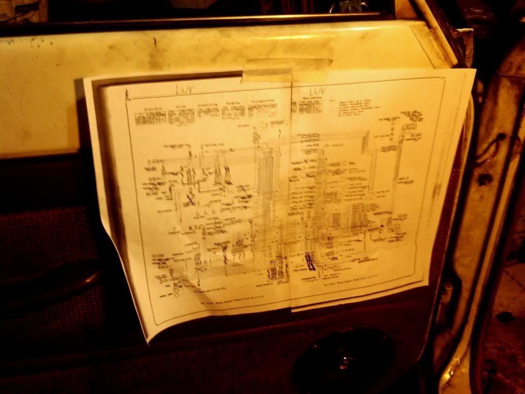

im in the middle of labeling and removing the wiring harness so i can cut out the extra wires and replace a lot of the old wires, get a more modern new fuse box and get rid of the voltage regulator for an internal regulated gm alternator swap
edit: pics up now.
keeping the wiring diagram close
got the gauge cluster pulled, harness pulled out and labeled with masking tape
pulled and labeled all the wiring from the engine compartment, pulled the relay box and the fuse box, vr will go tomorrow, i will clean up the engine compartment and remove the extra misc crap and cut out the rusted battery tray, will probably drop the exhaust tomorrow too.
that was fun :lol: every time there is another wire :roll: will start cutting the tape off the harness and figuring out what has stay and what can go, lot of random wiring that goes nowhere and weird splices.
calling it a night with that done :sleeping:

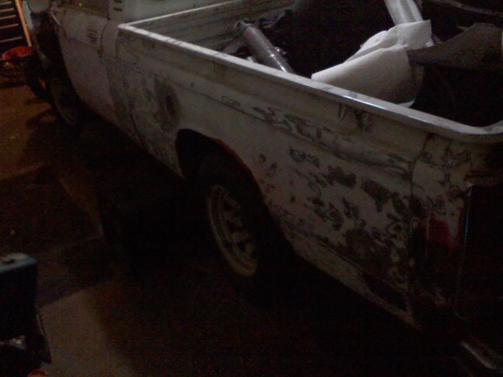

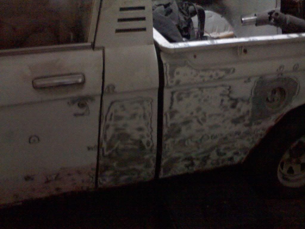

couple pics of the truck as it sits, i sanded out all the spots of surface rust, removed the red paint over the white and took the top layer of paint off all around
PostPosted: Thu May 23, 2013 9:51 pm
What are you doing to that truck? If you want to strip the paint use paint stripper, if you continue doing what you are doing ( it might be too late) you will warp the panels. Step away from the grinder.
PostPosted: Thu May 23, 2013 10:15 pm
5" orbital sander right now, being gentle with the panels letting the sander do the work.
im going to need some paint stripper before long to get into really taking the paint off. the spots where i went to metal are where i had rust spots starting from dings inside the bed or scratches.
what do you recommend for getting the bulk of the paint off?
PostPosted: Thu May 23, 2013 10:20 pm
Paint stripper. When you use a orbital sander it causes the panels to heat up and warp. Do not do this. If you continue down this road you will have to skim coat the entire truck in filler, then block it down. That takes a ton of talent, it's not something you can learn from the net.
