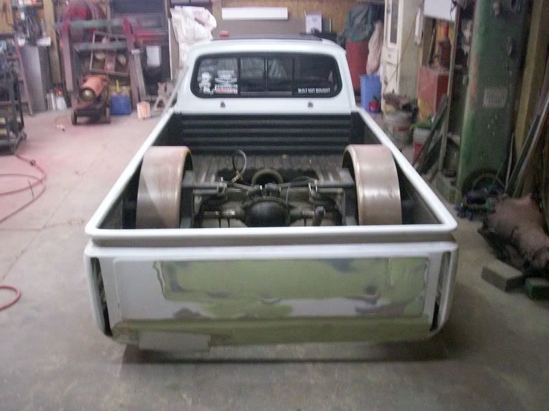

Got an early start today and heres the outcome, cut out bed crossmembers, made bed mounts and got the bed b/d 3 1/4" :smt045 Tomorrow I might go and get some sheet metal so I can section the bed and roll it under like the cab so everything will be even. Enough talk here are the pics....

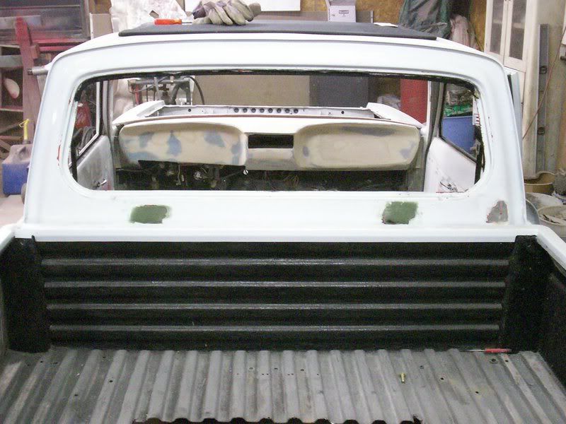

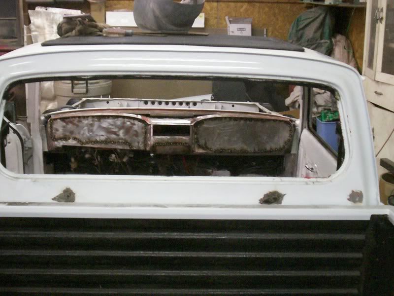

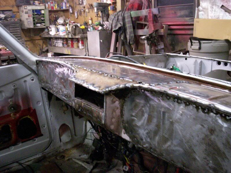

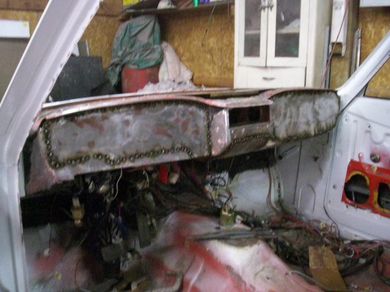

Suspension has been on hold, my buddy was paintin his c10 this weekend. So I started on the sheet metal dash.....
Added round tubing to make it look even more old skool
Just need middle patched and everything is welded up
PostPosted: Sun Mar 02, 2008 10:25 pm
Posts: 440
Location: Bowling Green, Ky

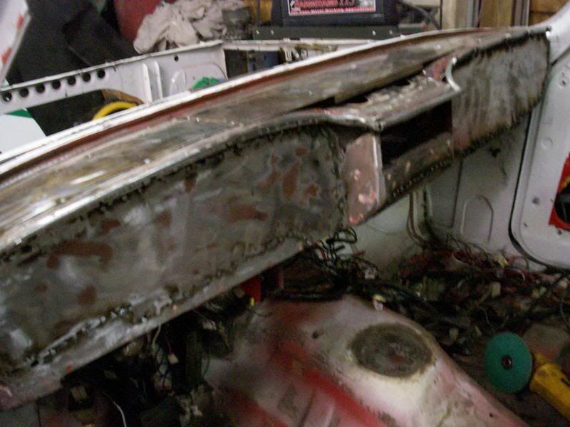

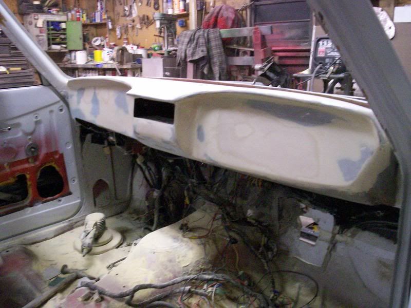

All welded up, I already have it smoothed, but w/o any pics at the moment, can't finish all the body work yet because I still gotta make a steel center console to the bottom of the dash after I section the tunnel for transmission and drive shaft

That is a interesting cup holder the you have in the center console. Is the console staying in the truck after the SFBD? Also is that a 2nd LUV in the right side of the garage?

Center console is gettin thrown out, makin a steel console that flows right w/the dash, I had another 79 Luv but it went to the junk yard after I stripped it all

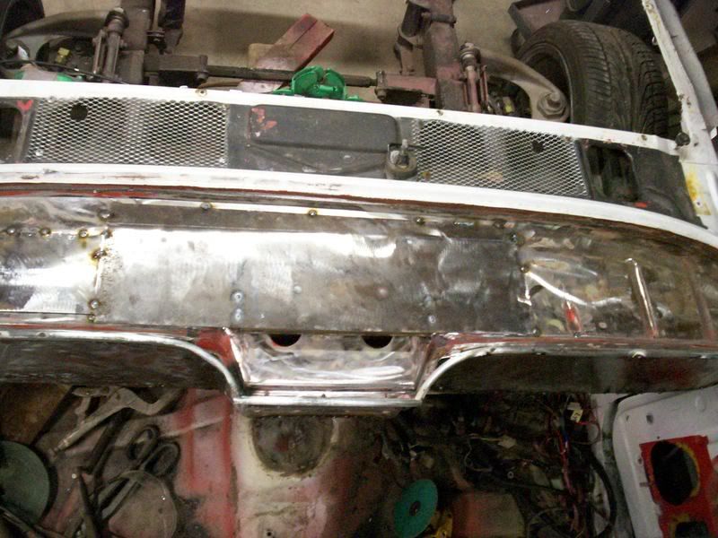

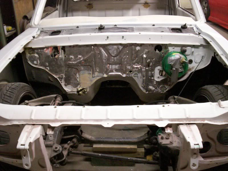

Front bracket has been cut and dropped for the radiator, next is steerin then I'm blastin that frame at the body shop I work at so it'll be super easy to finish up welds, make battery trays, and a few more gussets. Meanwhile, got the body work pretty much done on the dash, and started grindin/cuttin on the firewall to smooth it out

The dash looks really good. How much fabrication was there? Did you just fill in the empty spaces and smooth it out, or is that a completely new dash?
PostPosted: Thu Mar 06, 2008 10:23 pm
Posts: 440
Its the stock Luv dash, tore it completely down and welded all the holes shut, added round tubin to give it a hot roddish look
