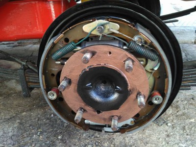

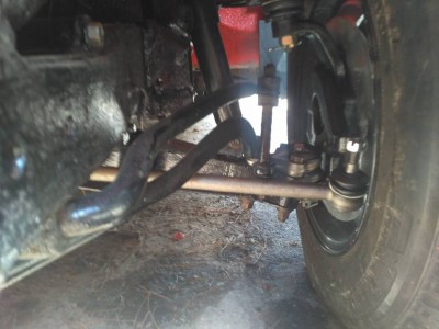

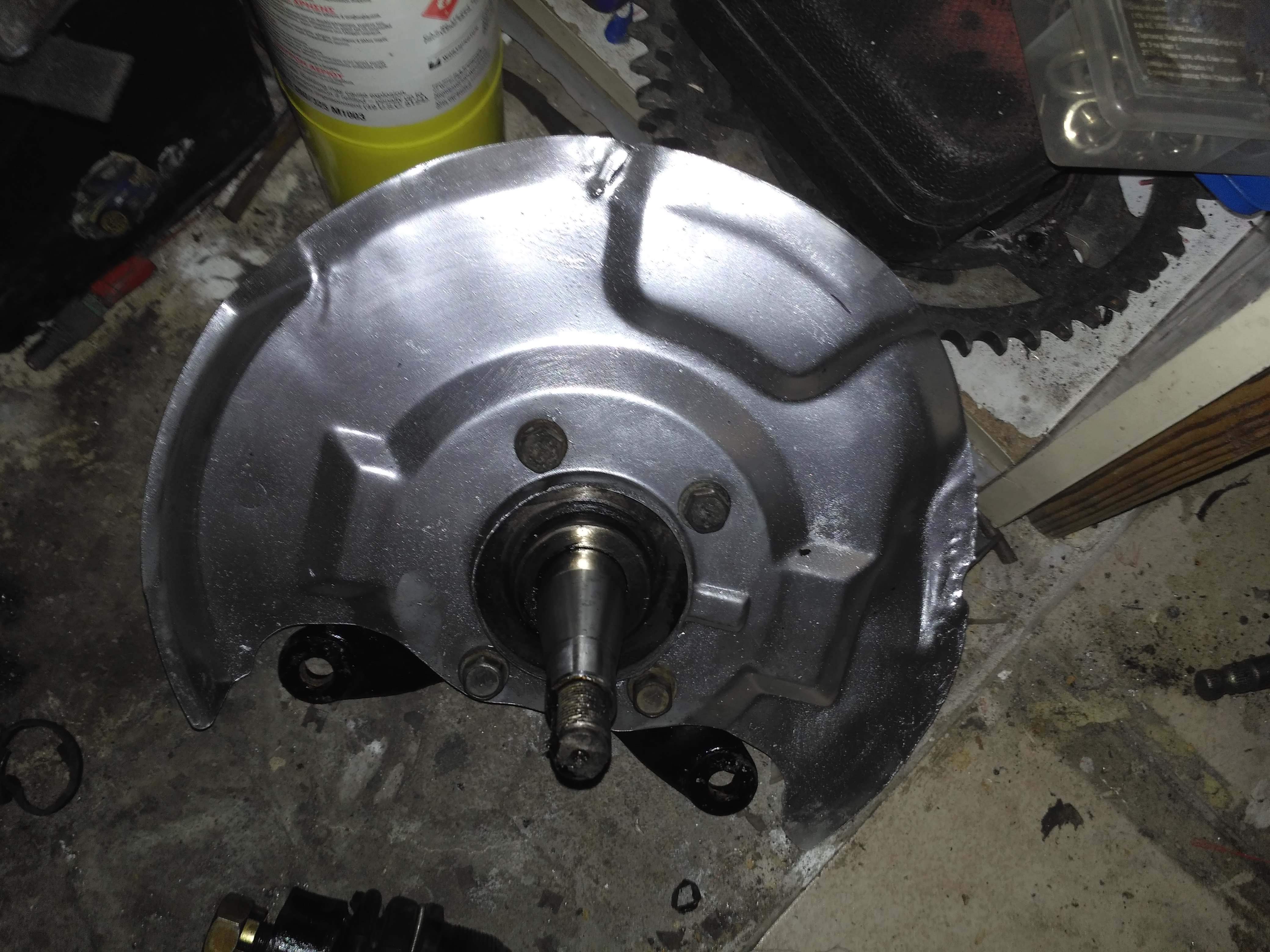

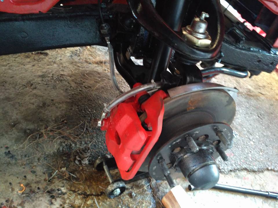

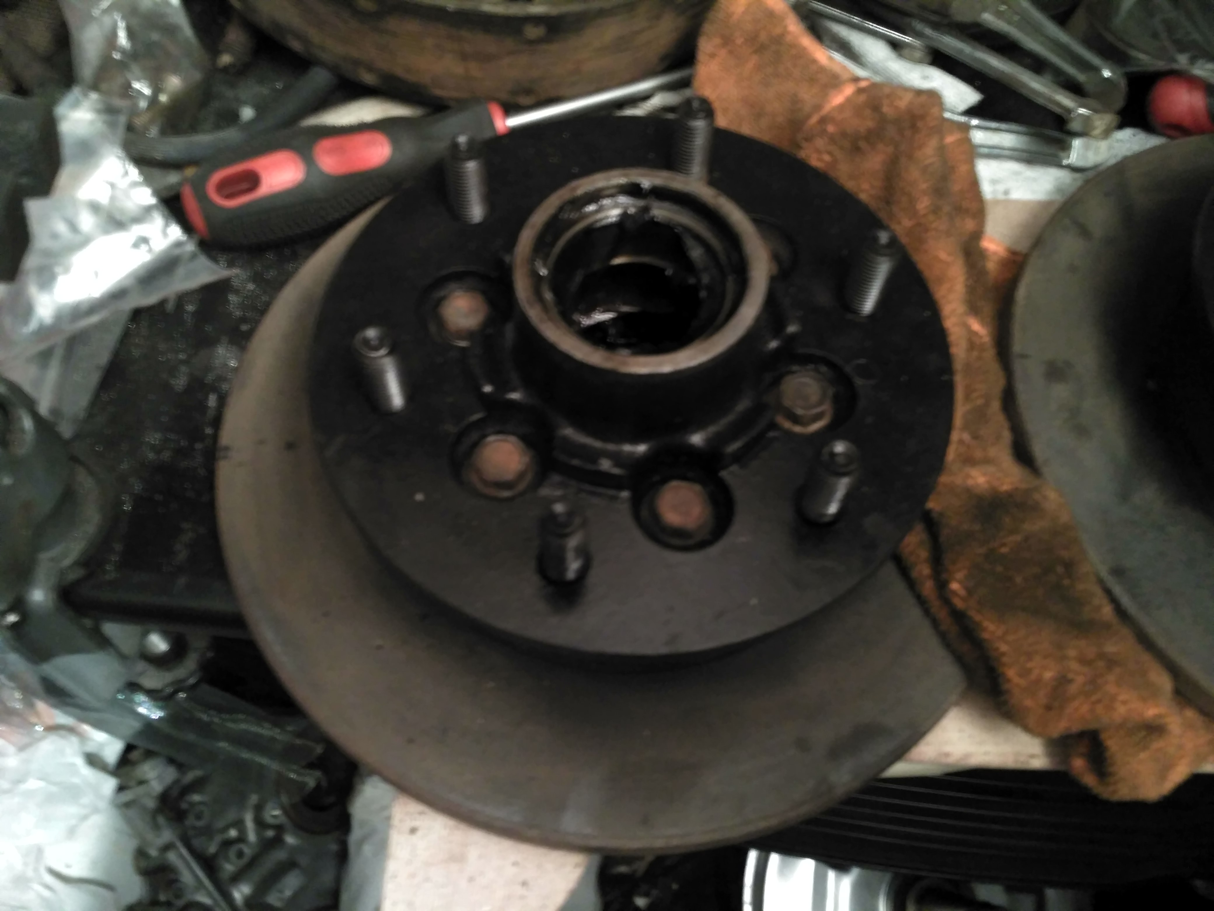

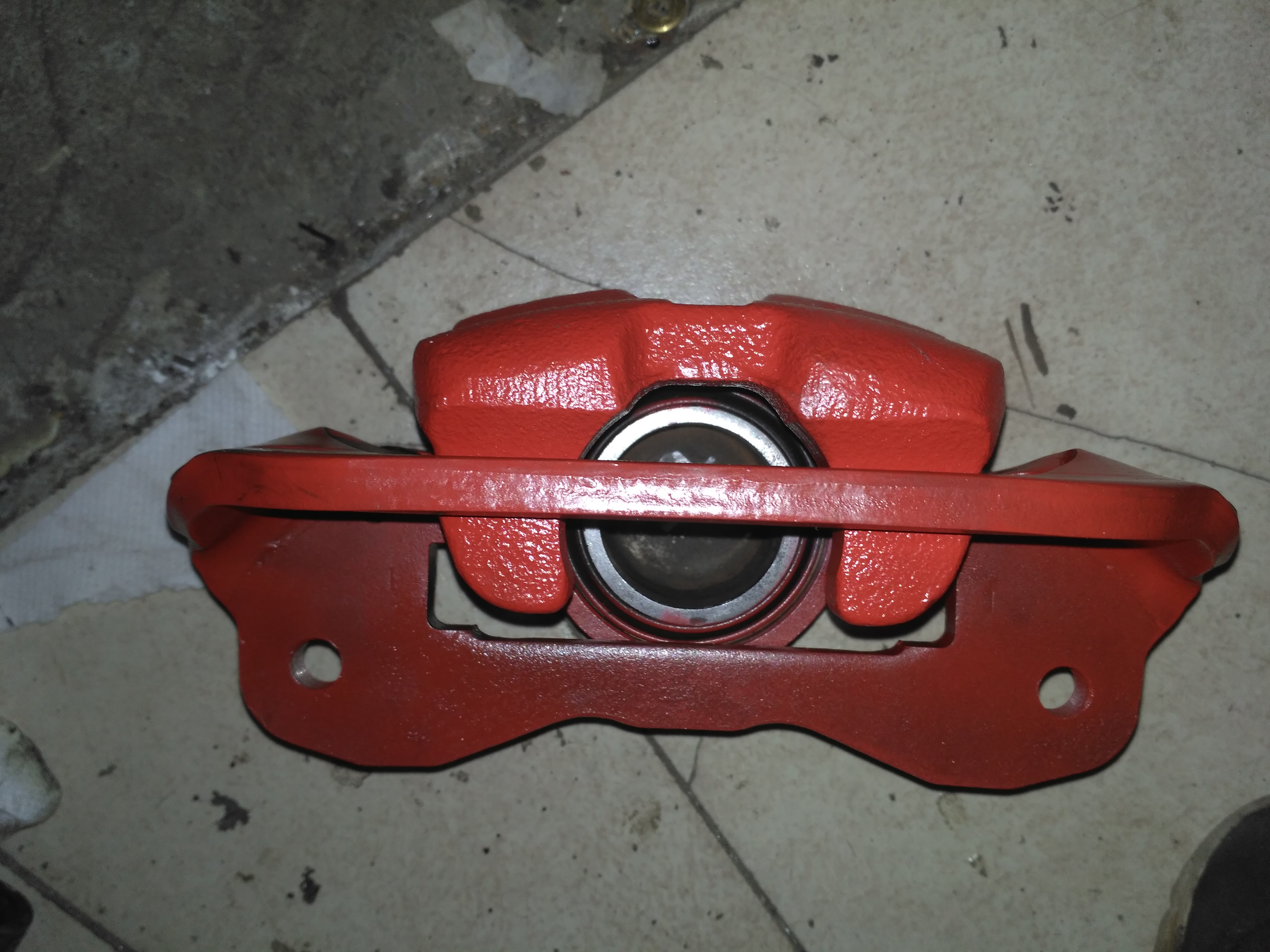

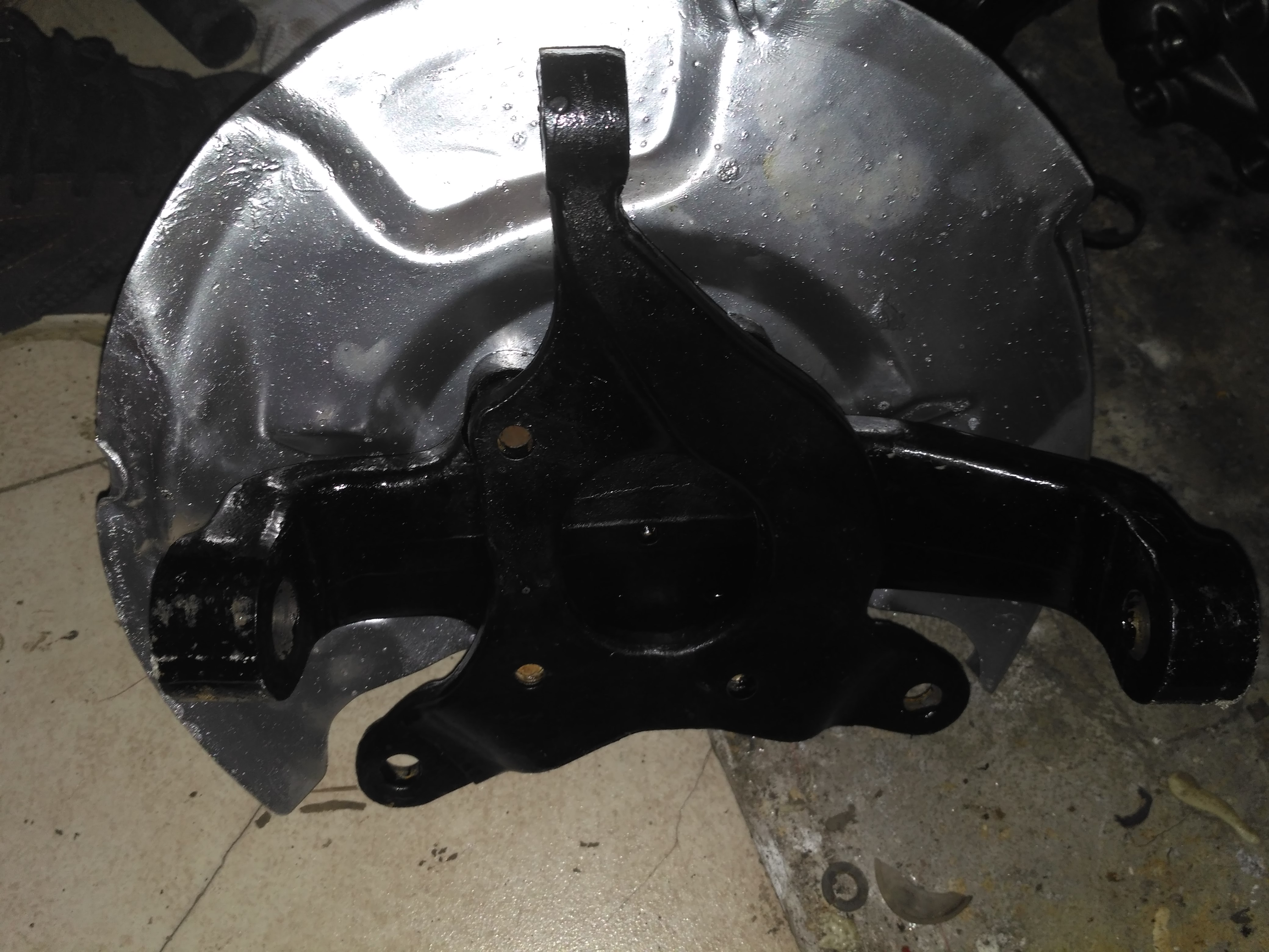

Managed to found a front brake set of a 1981 pup.Cleaned everything from rust and rebuild the calipers.Just got to put them on.

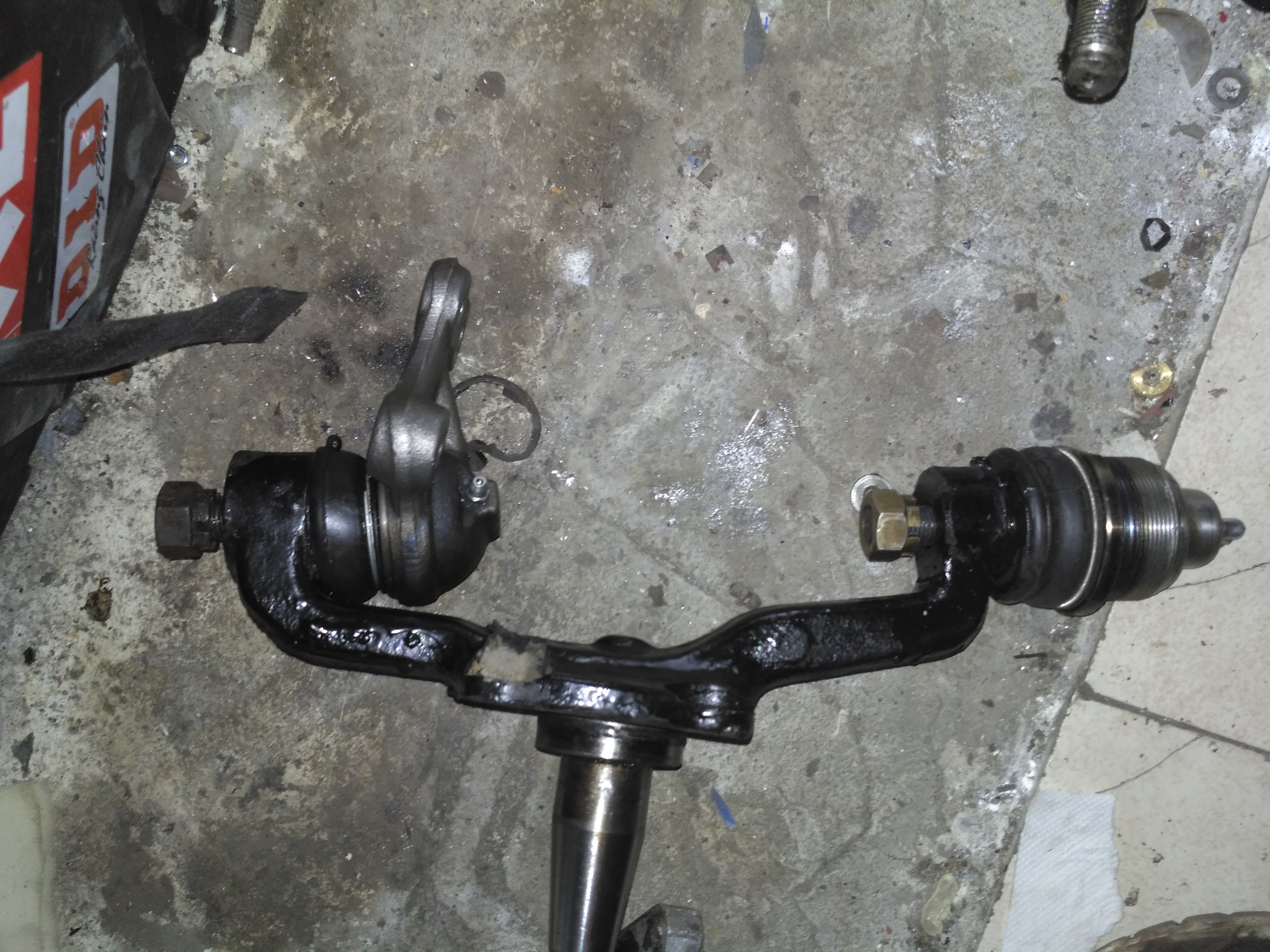

Any ideas how can i get the ball joints from the old arm with hurting them?

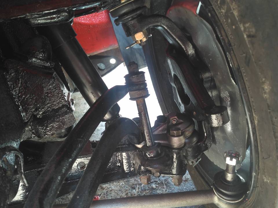

So i used i ball joint puller and safely removed the joints from the old arm.
The answer finally is that you can use the pup front brakes with the spindles on the first luv.

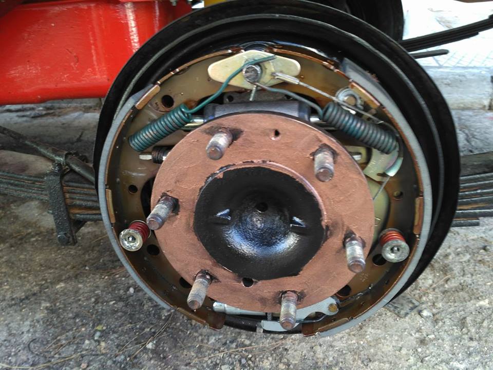

brakes done

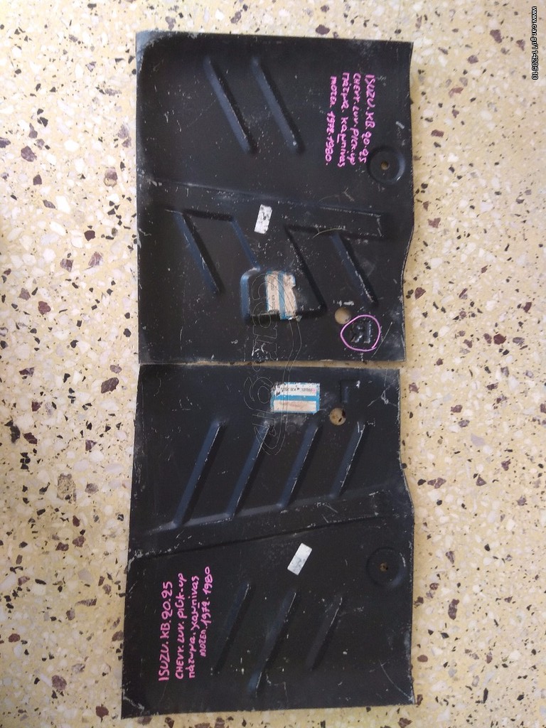

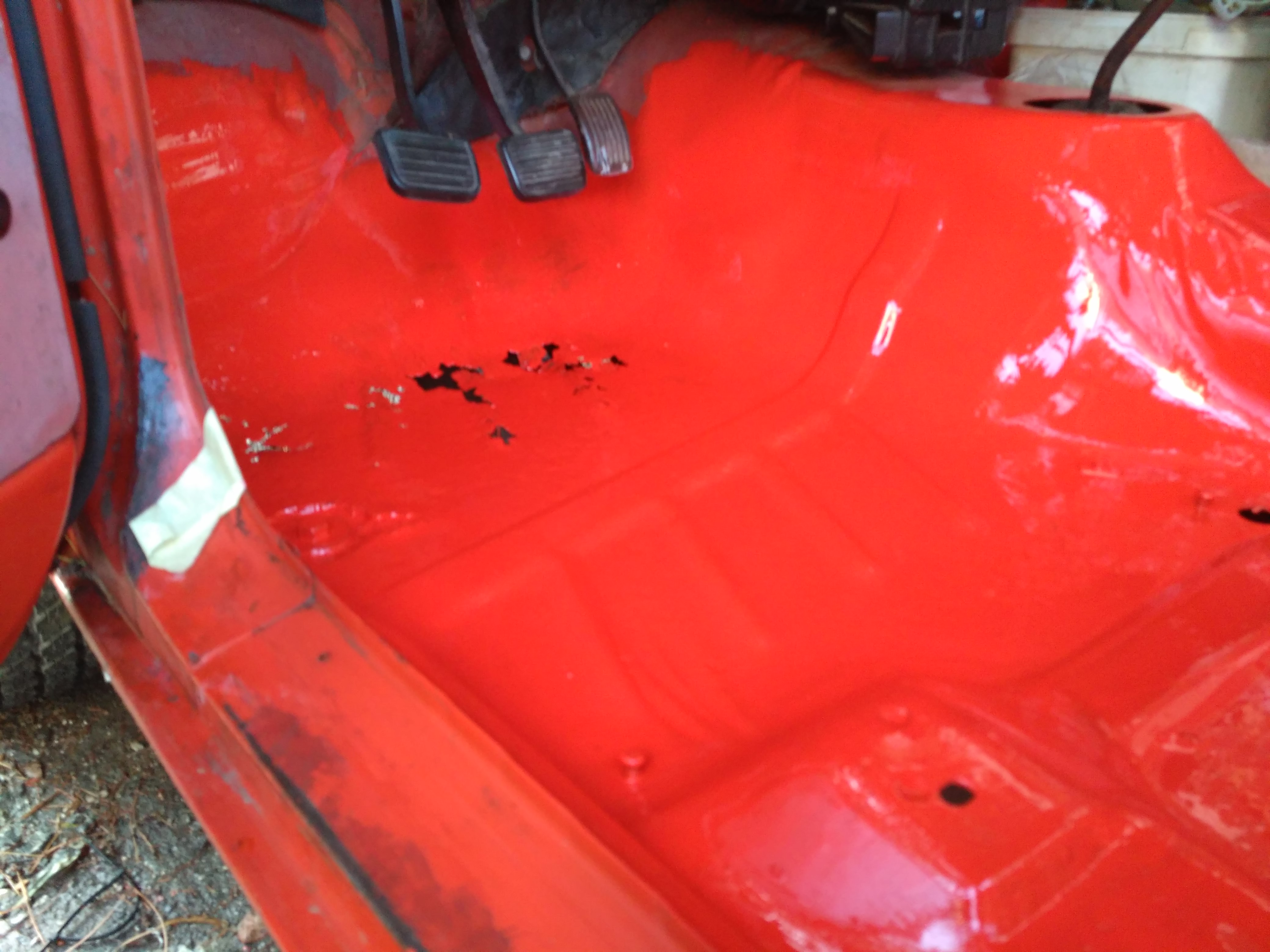

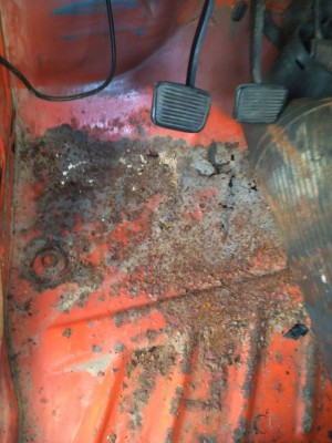

i am gonna fix the floor panels temporally with some sheet metal and for the future i got some new panels.
Anyone knows how many psi is the radiator cap?

I removed the bench and painted the floors.Still got to make some patches.Also i am planning to get a pair of buckets from a tiburon.

Could you please tell me where you purchased those floor repair sections?

I bought the panels from a store here in Greece that had some old stock for luvs.
