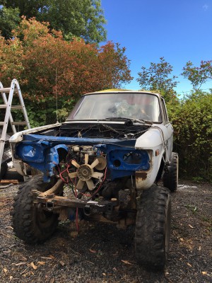

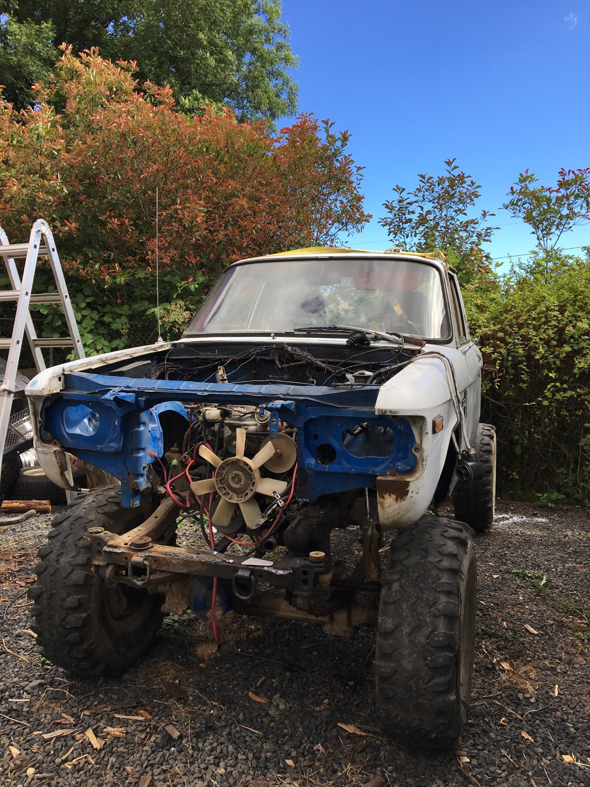

PostPosted: Sun Jul 01, 2018 10:57 pm
Sold a while back
New owner sent me a pic of how it's sitting today. On its new home on a Toyota chassis. Needs body mounts fabbed but i guess thats how its gonna sit

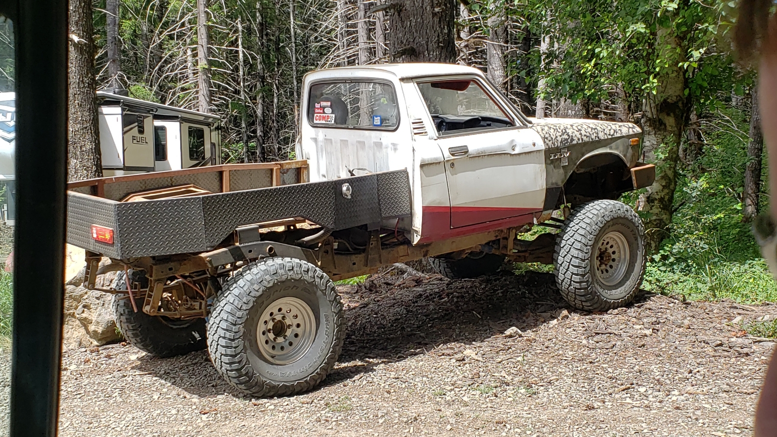

PostPosted: Sun Jun 23, 2019 1:04 am
Unfortunately I wasn't there to see it but my brother saw my old truck at a poker run today and got a picture for me. The new owner definitely went all out on that Toyota chassis swap. Really glad to see that it's actually being put to use and didn't get scrapped but this is definitely not going to be one of those cases where I reunite with my truck in 10 years
