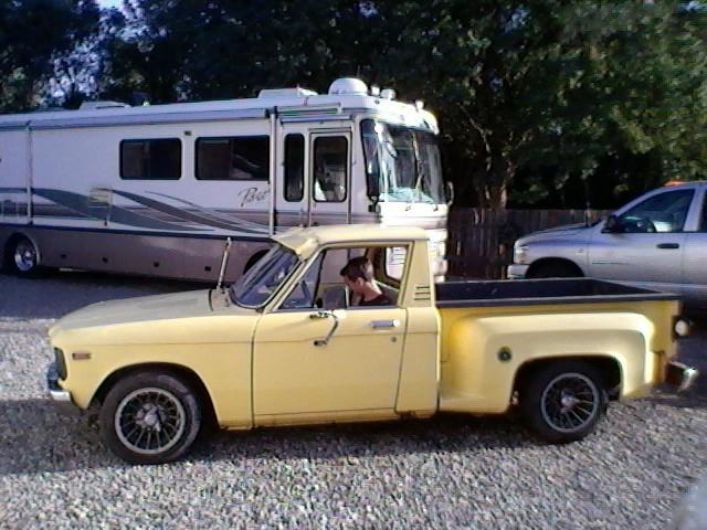

So after months of me deciding where I want to go with my 79 Chevy Luv, I've finally decided.
I want to drop it low.
So far the torsion bars are cranked all the way down, and in the rear it has 3in lowering blocks.
Here is 2 pictures of it.
I WANT IT A LITTLE LOWER.

If you want it lower in the rear you can pull out a leaf spring. On the front is your rubber snubbers cut down? If not start cutting them down.

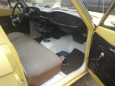

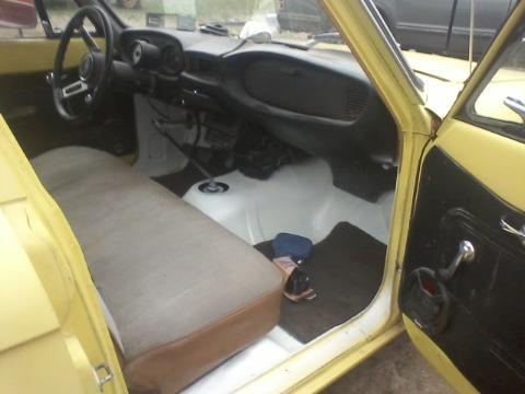

Here is a quick update, I painted inside the cab white.
The color way i'm planning for is White and Black.
File comment: I'm really liking this, it's cool to see the progress.

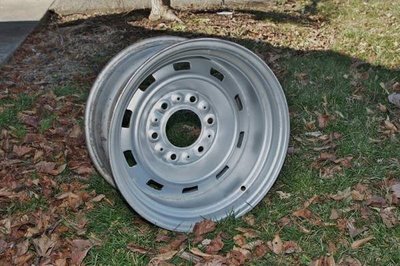

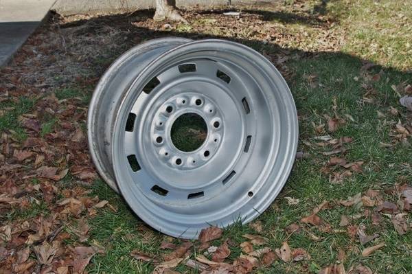

I picked up these steelies for the luv today.
Bought them being told they were 15x8s but they are really 16x8s..

PostPosted: Sun Apr 28, 2013 11:04 pm
Before buying tires make sure the offset will work on your truck. Try mounting them on your truck and try to see if the tires will clear the suspension and fender.

Since they are fiberglass it would involve trimming. Determining back space and offset is something that needs to be done before buying rims and tires.

Yea I should of checked the clearance and everything, oh and I found out they are 15x8s
I was just measuring them wrong.

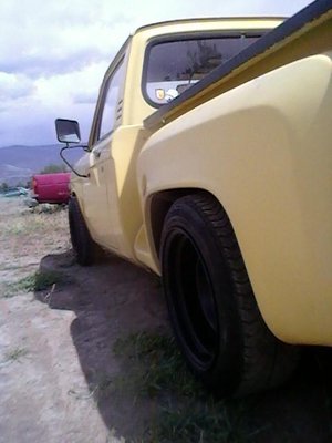

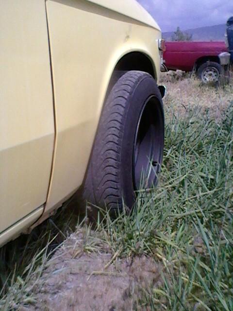

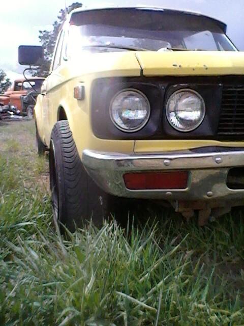

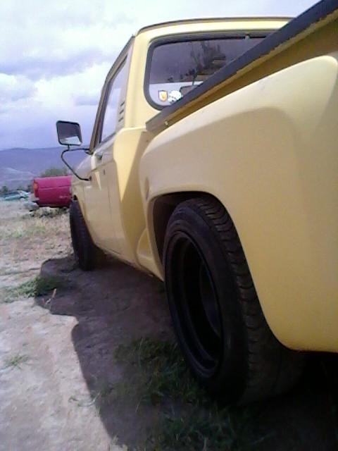

Here is an update from the weekend.
 Post subject: Re: Low Luv
PostPosted: Wed May 08, 2013 8:50 am
Can you turn the front wheels lock to lock? I had a set of 15x10's on the front and mine they rubbed.

[quote="LUVTRKR"]Can you turn the front wheels lock to lock? I had a set of 15x10's on the front and mine they rubbed.[/quote
I don't rub what so ever, I have the wheels stretched so that might make a difference.

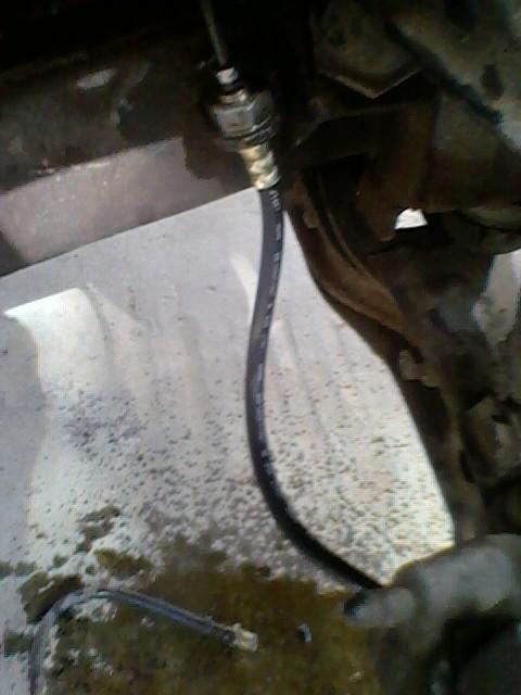

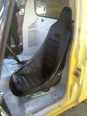

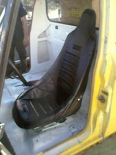

Here is an update, I changed the front brake lines and put in seats.
I forgot to take a picture with both seats in.
PostPosted: Sat Jun 01, 2013 10:20 pm
With a truck that low you might want to add a bit more padding in those seats.
Hahah, yea I came up with an idea.
I'm just trying to get ahold of some memory foam for it to happen.
