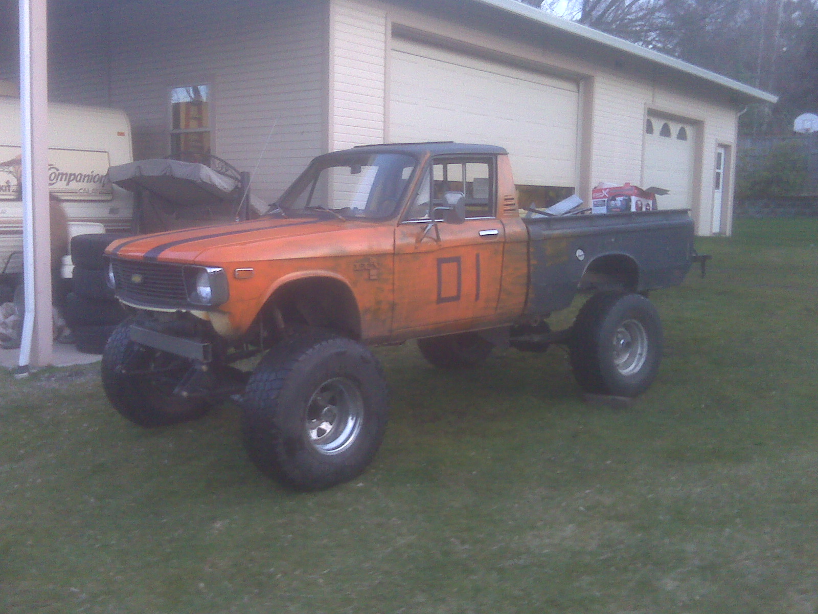

Hey every body. I'm new to this site, so don't get too mad if I screw something up. I've got a 79 luv 4x4. I have put it on Chevy half ton axles. It also has a fuel injected 305 out of a 92 camaro. The problem I'm having is getting the steering to work. I have a Toyota ifs steering box. I can't figure out how to hook it up to the 10 bolt front axle. There's no place to put a steering ARM on the passenger side. Any ideas?

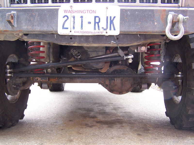

Ive heared more people just using chevy steering boxes. Are you having trouble hooking up steering linkage? Um wy couldnt you do somthing like this? Hope this helps.
(I know this isnt the same but its just aftermarket linkage that you bend and weld to what you need and you get rid of the ball joints. I read that people are very happy with the setup and how they steer. and they are very strong.)

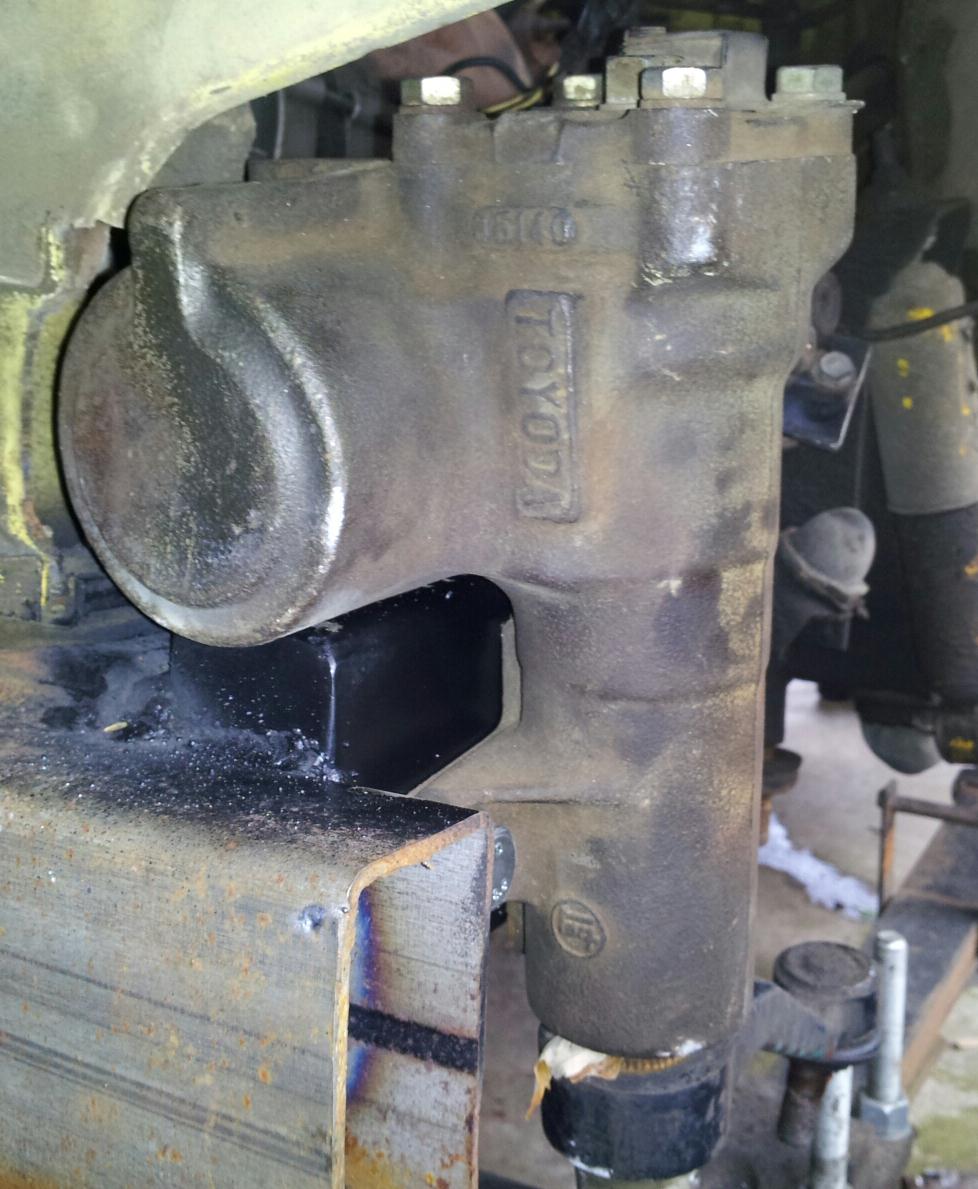

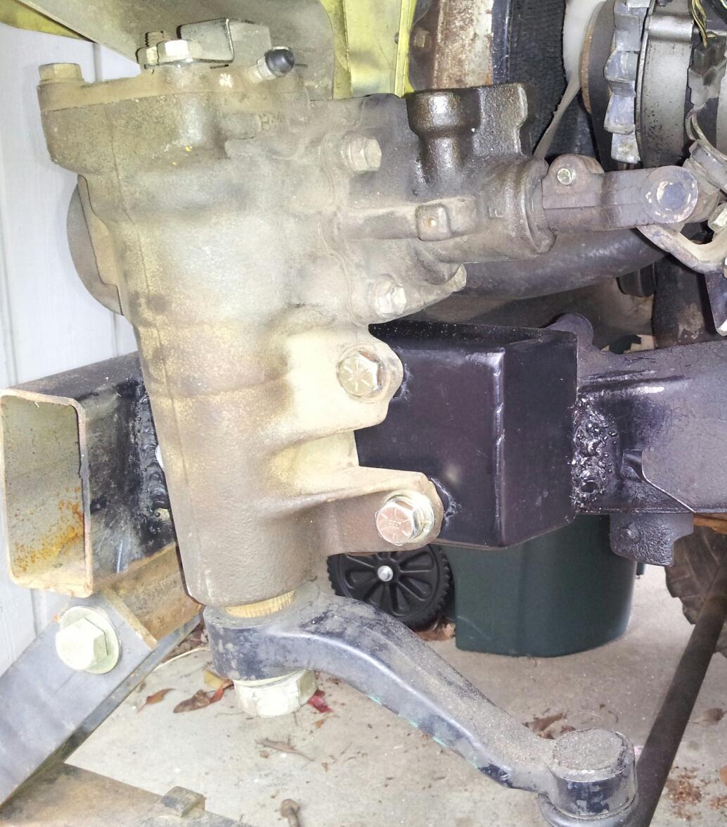

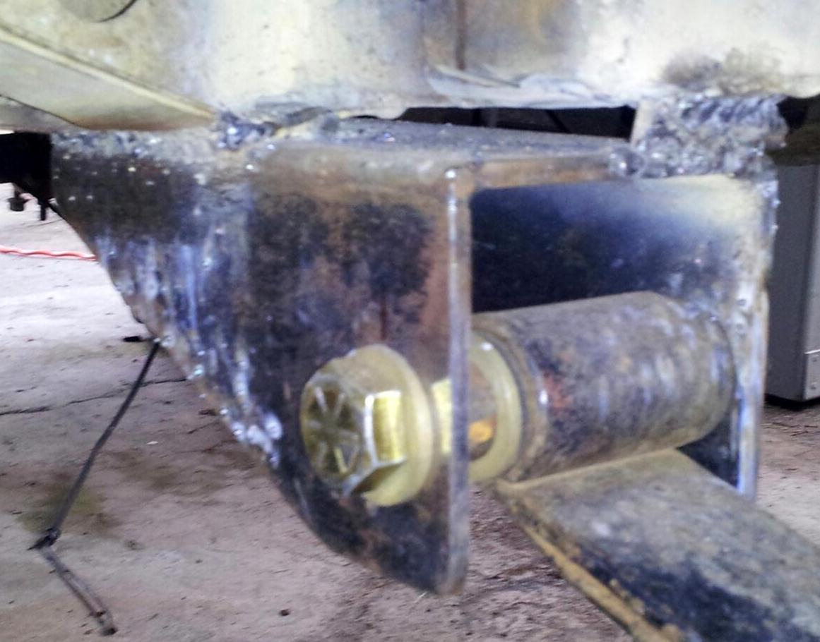

Hey guys, just got back into southern oregon. Just seen the truck for the first time in two years. Its a little rough after sitting that long lol. But after a week of working on it its coming together.bout got the steering together. Ill get some pics up as soon as i fugure out how to shrink them down a bit.

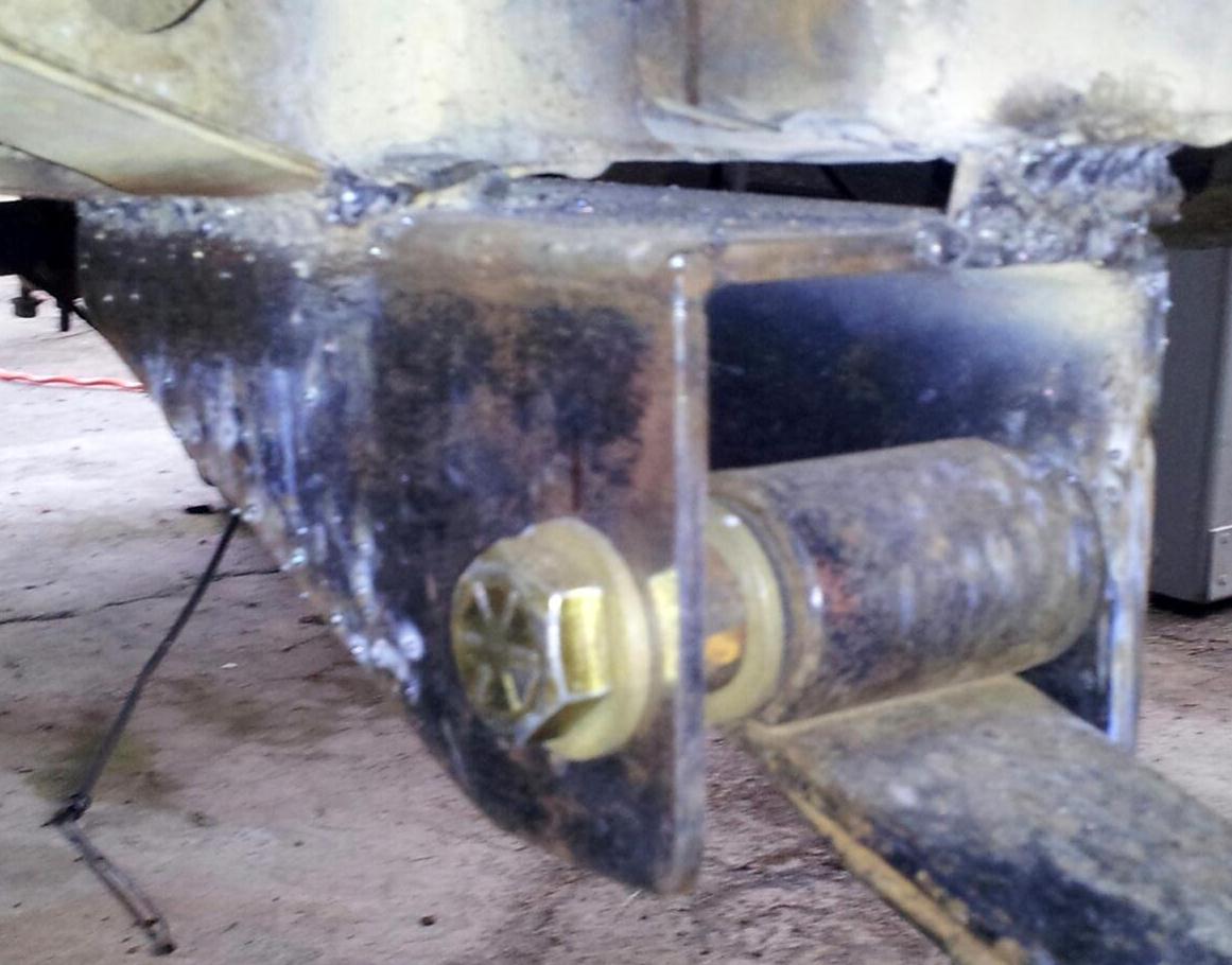

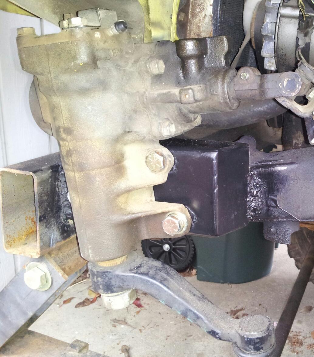

heres some more pics of the progress.

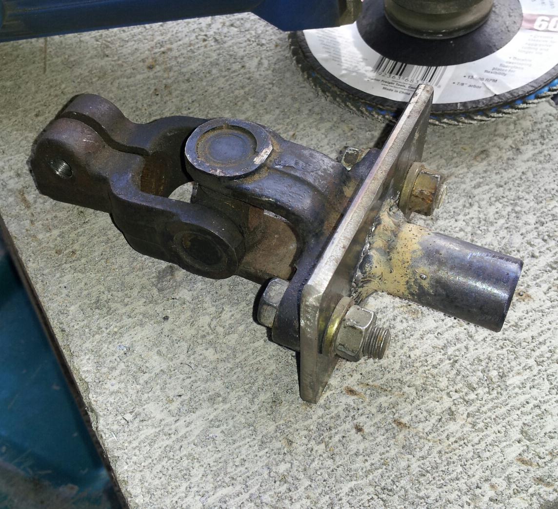

The steering coupler
