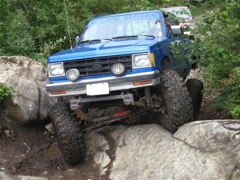

The leafs are going to be mounted in the same fashion as the rear. do a search for SAS'd trucks. Go to trail gear or Marlin Crawler's websites and search for the SAS kits they have and that'll show you what stuff looks like.
Here is a pic of my truck, this setup has been going strong for 5 years now, and seen it's share of abuse. :wink:
