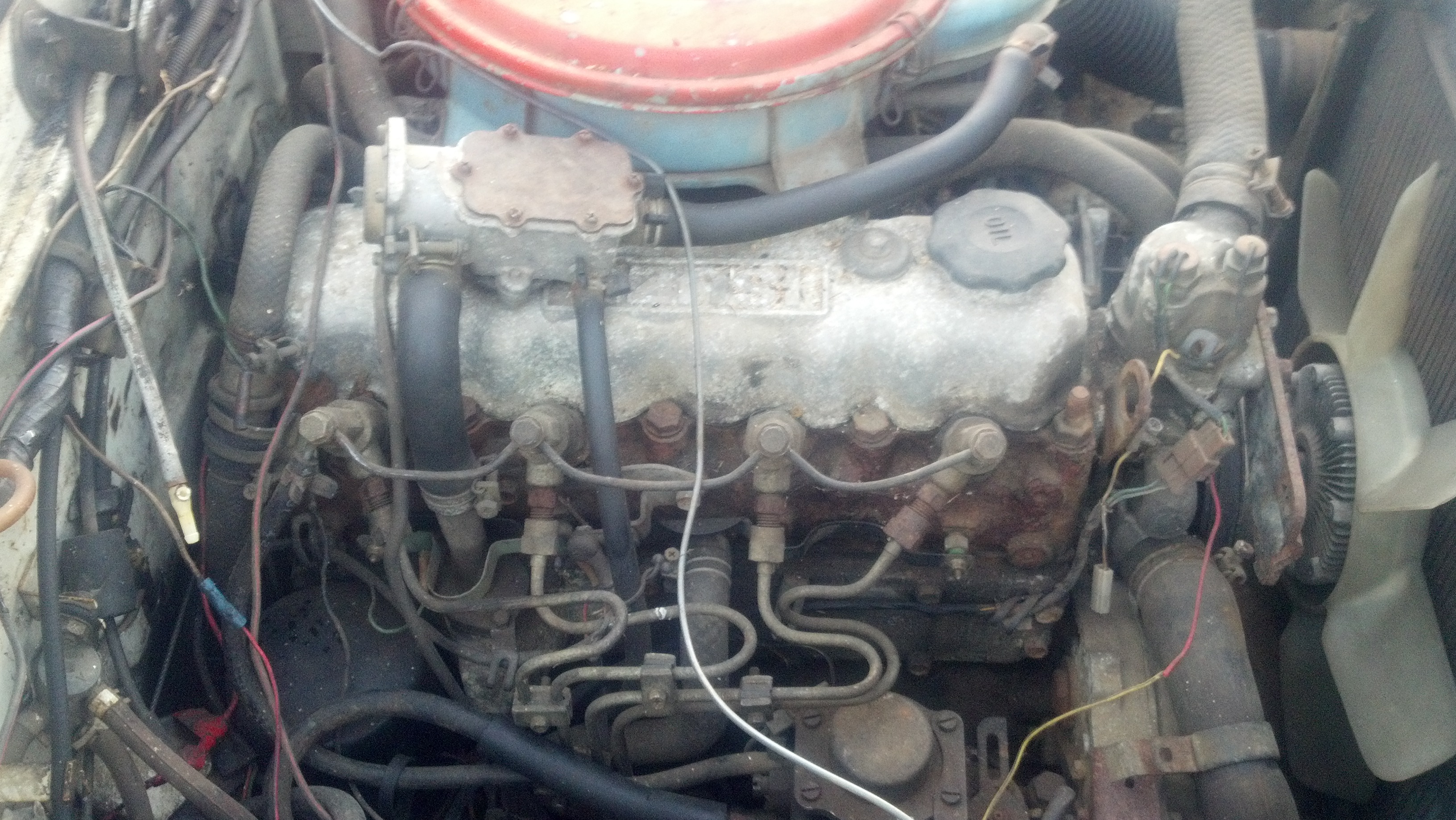

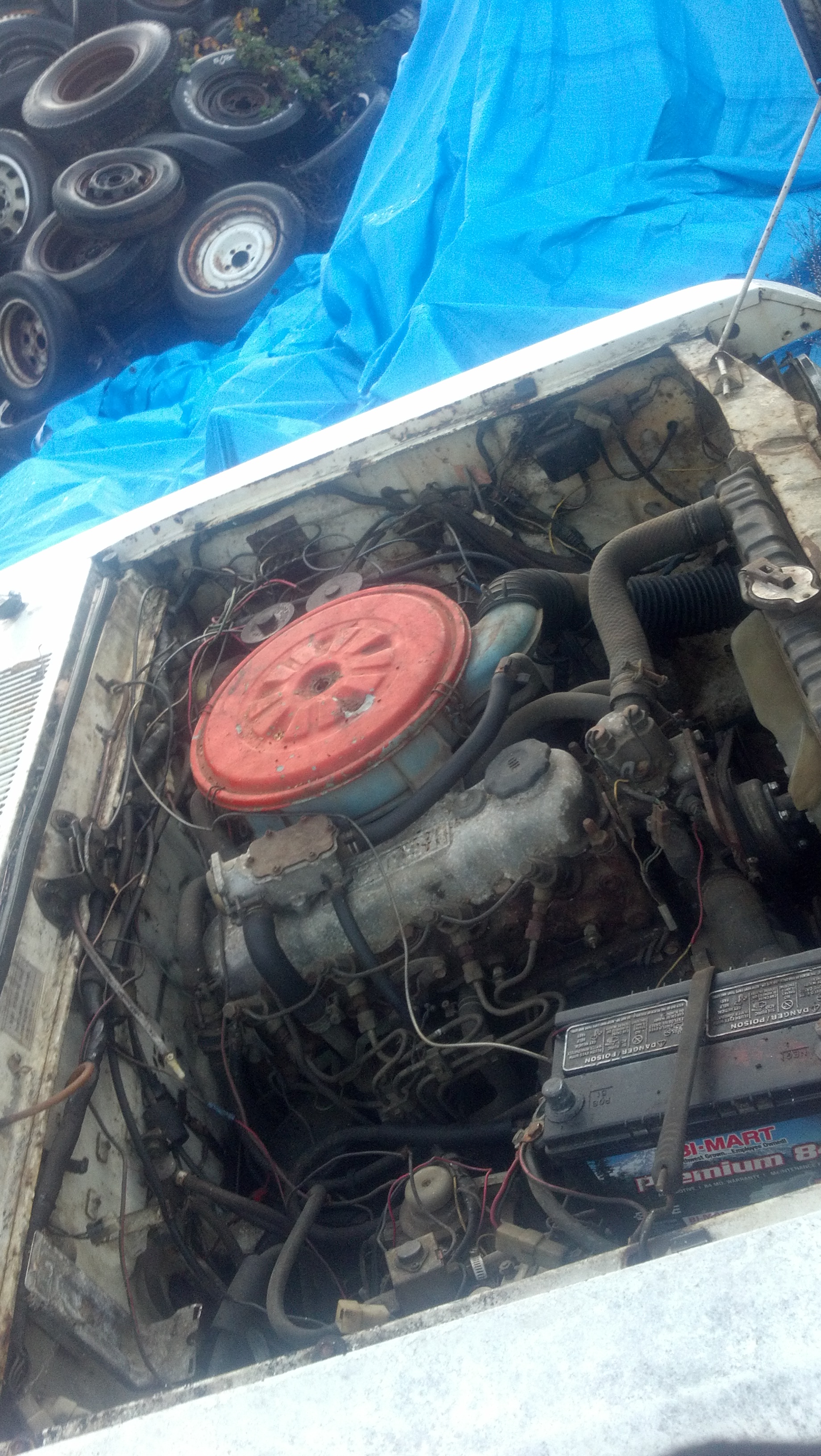

can you identify this motor? the 2.2 or the 1.8?
I attached the pics.

That's a 2.2L C223. If it's with the original radiator, I'd say it's a 1984 or 1985.
The box on the back of the valve cover, with hoses on it--that's a feature that came in '84.
In '86, they got a smaller filler neck. The radiator looks like it has the larger cap, which means it's pre-1986 if I'm right.
