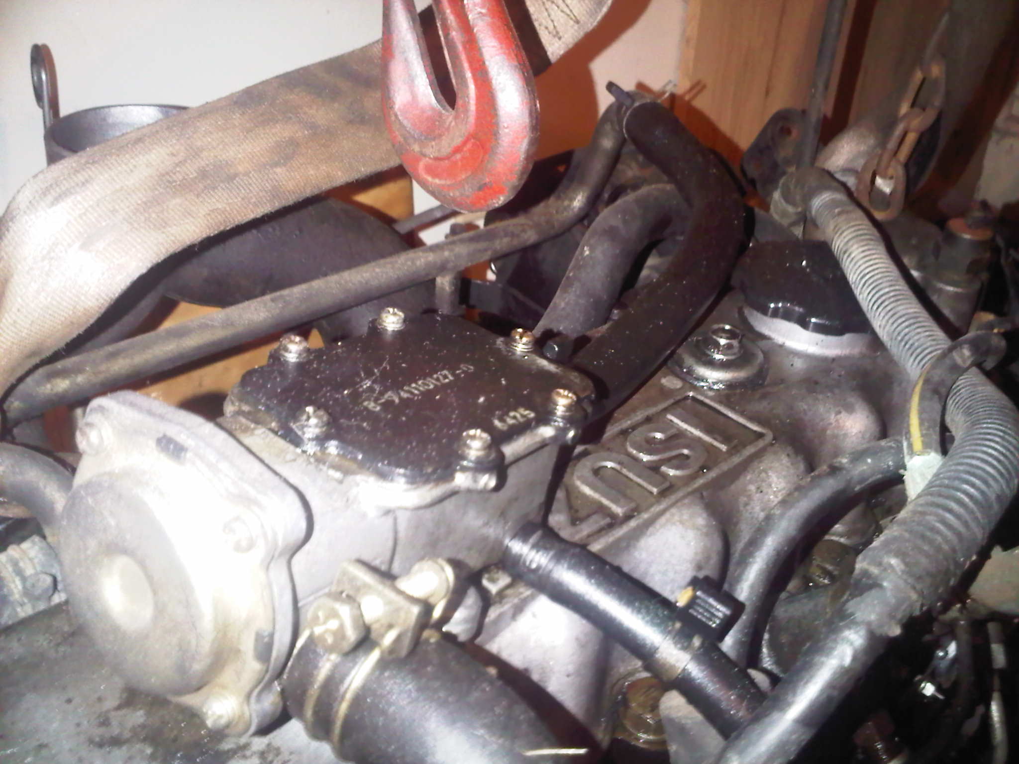

I have an '86 engine on a skid in my garage. It's practically identical to the '84. I'll snap a photo or two of the top end, so you can see what parts you're missing.

This is a view from the rear of the engine. Do you still have this assembly, and the hose that comes out the front of it, and the steel line that goes to the intake manifold?
Did your mechanic use the '82 exhaust manifold, or the '84?

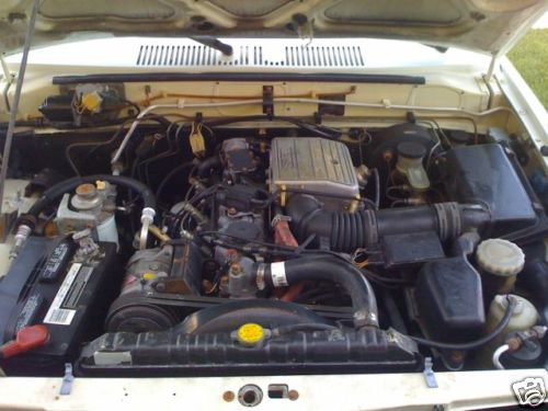

stock theres a sound muting box on the intake, it cuts the under hood sound by near 30/40% 8O 8O
i have a photo of a orignal CA EGR set up ill look for.

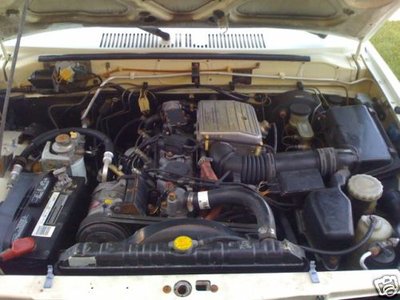

this is a 100% stock CA emissons diesel pup
!Bi0yhrwB2k~$(KGrHqQH-DwEs-pIEZygBLQ5fzklCQ~~_12.jpg [ 37.74 KiB | Viewed 11007 times ]

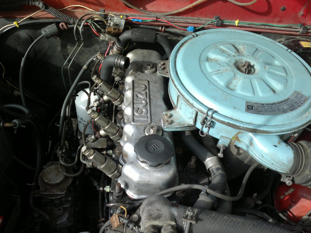

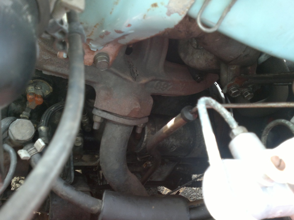

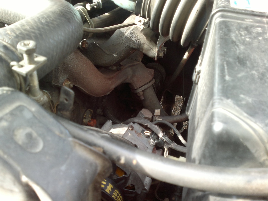

wow - i need that sound muting box! where can i get that??? my 82 intake is completely different. I am pointing both my mechanic and the person i bought the engine from to this thread. The truck is currently at my mechanics, and i will be out of town for the next few days. if you guys think we have enough parts to get the original 84 intake and exh. manifolds back on there (or if the extra ports can be temporarily plugged while we source them) - please advise. I only have a limited window for him to work on it -its my daily driver and i need it back asap!. thanks everybody.

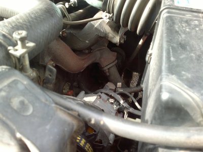

The 84 engine as installed (with 82 intake and exhaust), all these are bigger if you click on them:

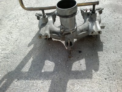

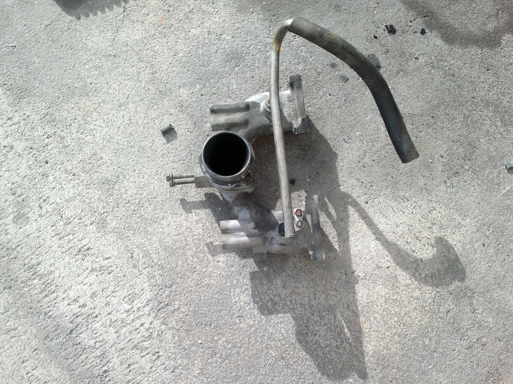

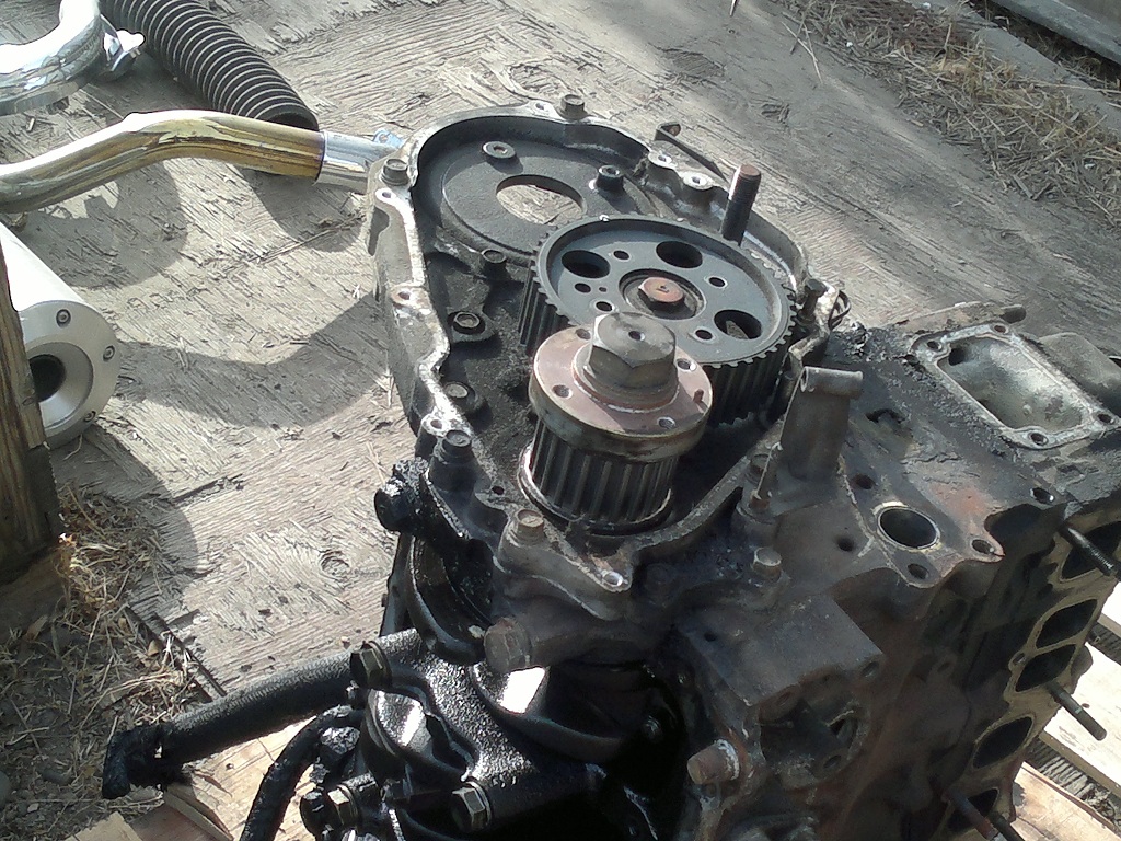

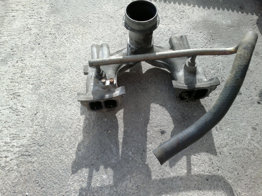

the intake that came on the 84:

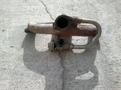

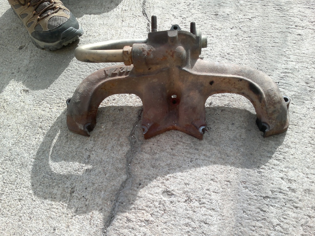

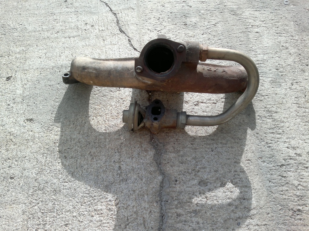

the exhaust manifold that came on the 84:

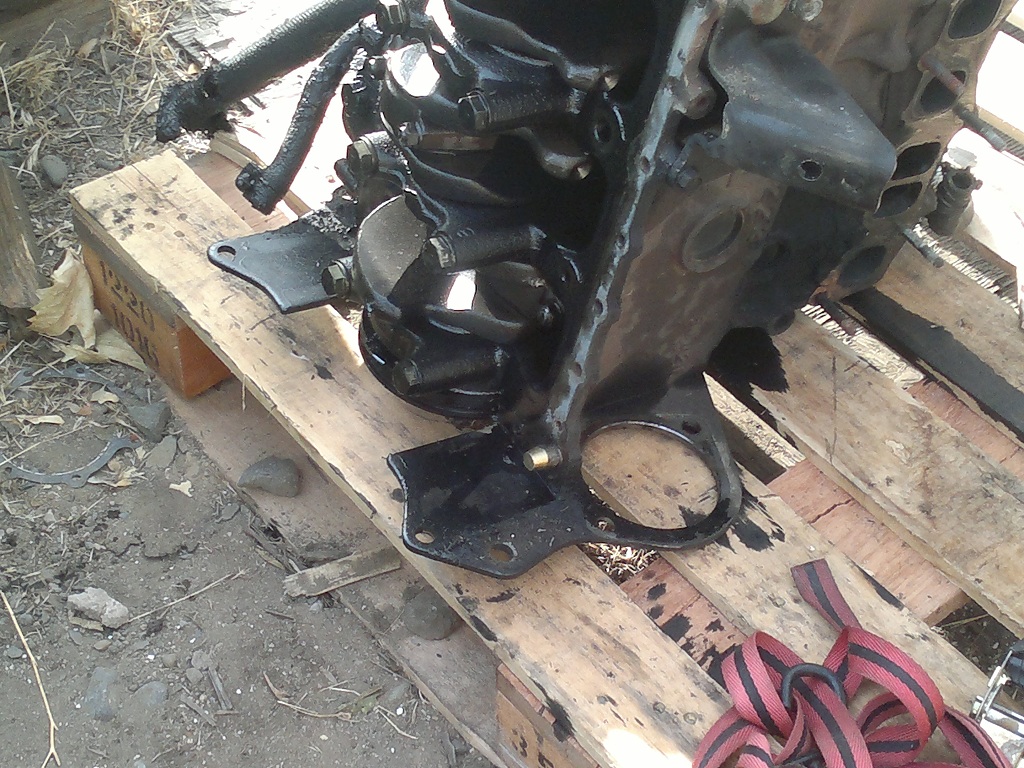

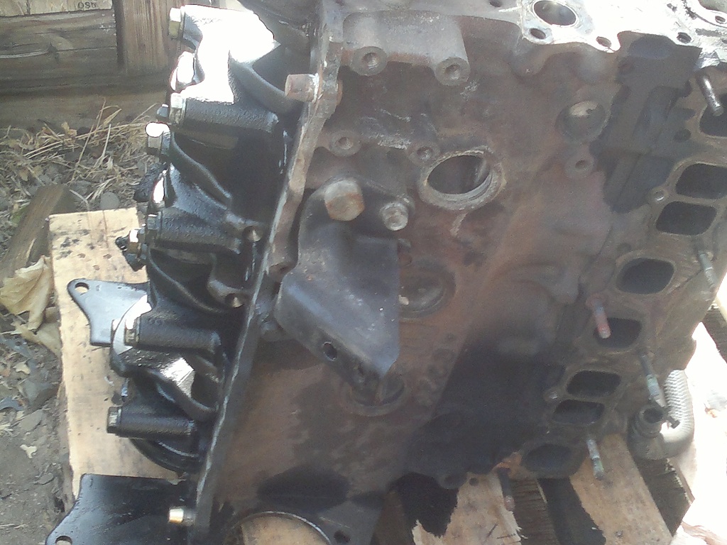

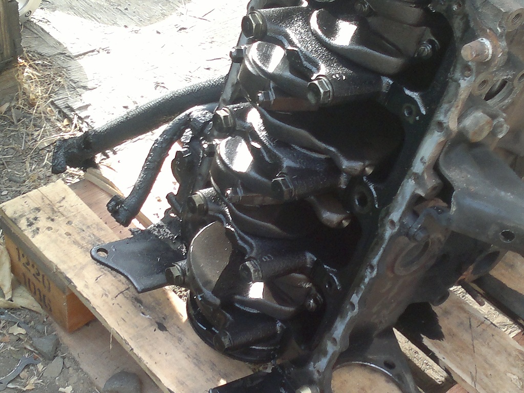

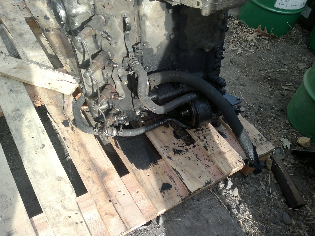

and heres whats left of the original engine (PS - aside from what we need to get this pup running, if anybody needs anything! i think it threw a rod and/or a piston but should still have some good parts):

more

the box to the right of the photo is the muting box
does it have a crack or a hole in it?
86trooperT/D 2.2
84 L\B 4x4Diesel LS 2.2
86 L\B 4X4 gas 5 speed 2.3

ill call my mechanic in the morning and ask him to look at that. is the box lined with fiberglass or anything?

Now I understand. This IS a California-spec vehicle. I can understand why the mechanic chose to put the '82 parts on it. If you don't have it, you need the oil separator and you probably need to use the intake from the '84 engine or get one from an '84-'86 Federal-spec engine.
PostPosted: Thu Dec 29, 2011 5:07 pm
Joined: Sat Oct 22, 2011 3:43 am
Posts: 54
so the oil separator is that box on the rear of the engine behind/above the valve cover that was pictured earlier in the thread? Sorry im on my phone hard to navigate thread
PostPosted: Thu Dec 29, 2011 5:56 pm
Posts: 1702
Correct! I'm pretty certain the '84 engine should have had one, although I'm really not familiar with the California-spec engine. David may be able to confirm this.
