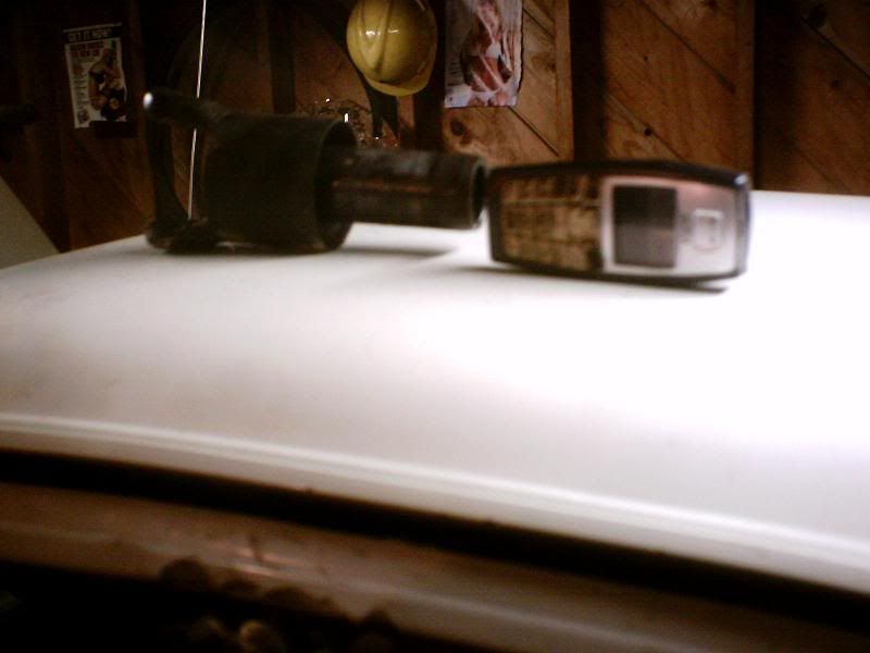

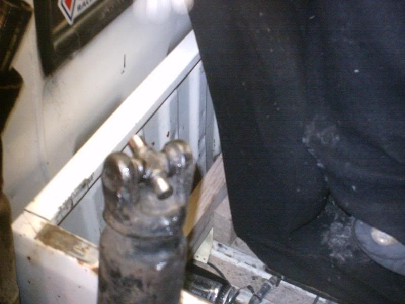

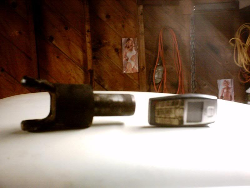

mkay. first off im gonna show ya how bad the damage was.
you can see here how much of the tranny was broken off when it was being beat to hell by the yoke.
heres what the yoke looks like
heres the driveline
WHERED MY TRANNY GO?!?!

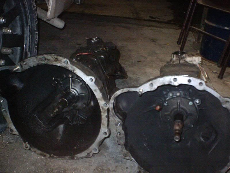

ok, now to get back on a serious note, i noticed that my new tranny was a hydraulic clutch version, and the pup has a cable clutch. so that poses a problem. the new tranny does have a spot to pivto my cable clutch arm though. ill just have to make the clucth cable run to the other side of he motor. i hope itll be long enough and wont bind.

Looking in the photo it looks like you could swap bellhousings to solve the clutch issue.
PostPosted: Wed Mar 01, 2006 8:52 pm
Posts: 993
Location: Winston Salem, NC
Exactly what I was thinking, looks like somones trannies have bad input shaft seals... I'd go on ahead and put new ones in
