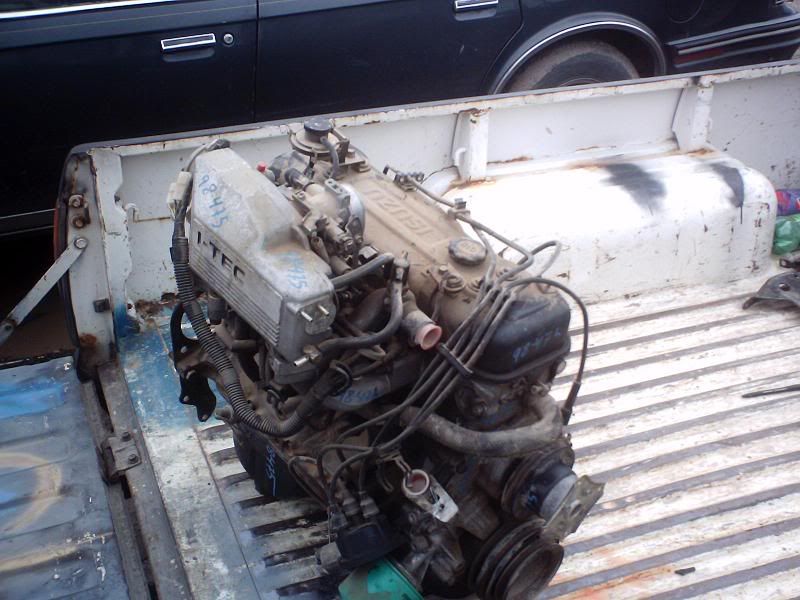

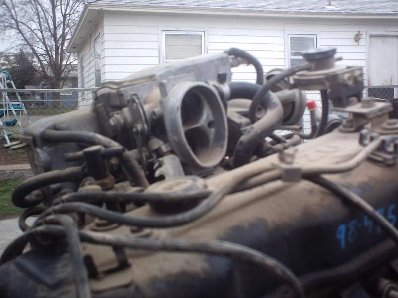

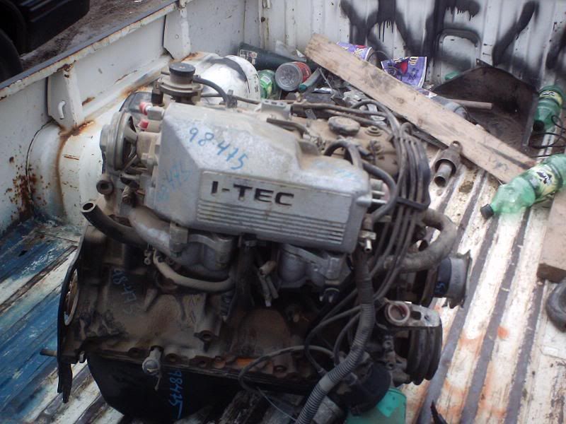

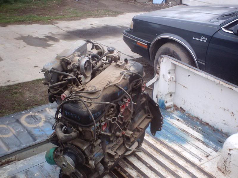

well i bought the motor a little bit ago. i paid 262.50 for it, so im doin good on money. i guess i need to start tearin down the pup to get the new motor in.
heres some pics of the little gem.
8)

mmmmmm, impulse G200.
I hate you... :P

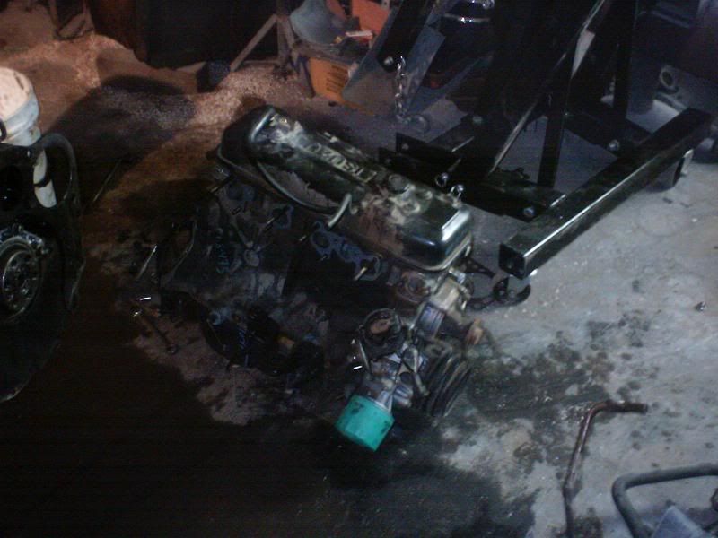

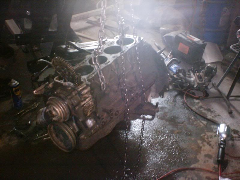

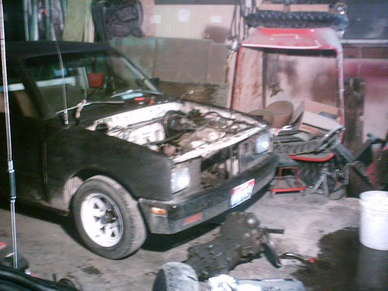

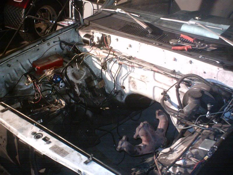

i forgot that o took some pics of the work i did yesterday.
i found that you can take the engine/tranny combo out at the same time with the exhaust manifold still on if you take the block mount off the motor on the driver side. the motor slid right out. i always forget about the shifter though. :oops:
the old "clunker"
the new "screamer!"
ill get some more pics as the motor goes back in and all that.

u wanna borrow my pressure washer and clean those hunks of greases up?
PostPosted: Fri Apr 07, 2006 7:13 am
Swap Specialist Mod
Posts: 2831
no way in hell man. the grease keeps em from leakin :lol: 8)
PostPosted: Fri Apr 07, 2006 7:14 am
LUVTruck.com's Cornholio
Posts: 1515
Why would you want to work on a greasy mess? Wouldn't you like to have clean tools and see what you are doing?
PostPosted: Fri Apr 07, 2006 7:16 am
Swap Specialist Mod
Posts: 2831
dont have time. must get done qwik. cant be lee and take my time. uggg
Posts: 1515
oh and now you have a good chance to clean up some of those wires!
PostPosted: Fri Apr 07, 2006 7:19 am
Swap Specialist Mod
Posts: 2831
well come on over and clean em up, cuz i sure as hell aint. :D
PostPosted: Fri Apr 07, 2006 7:20 am
Posts: 1515
lol
