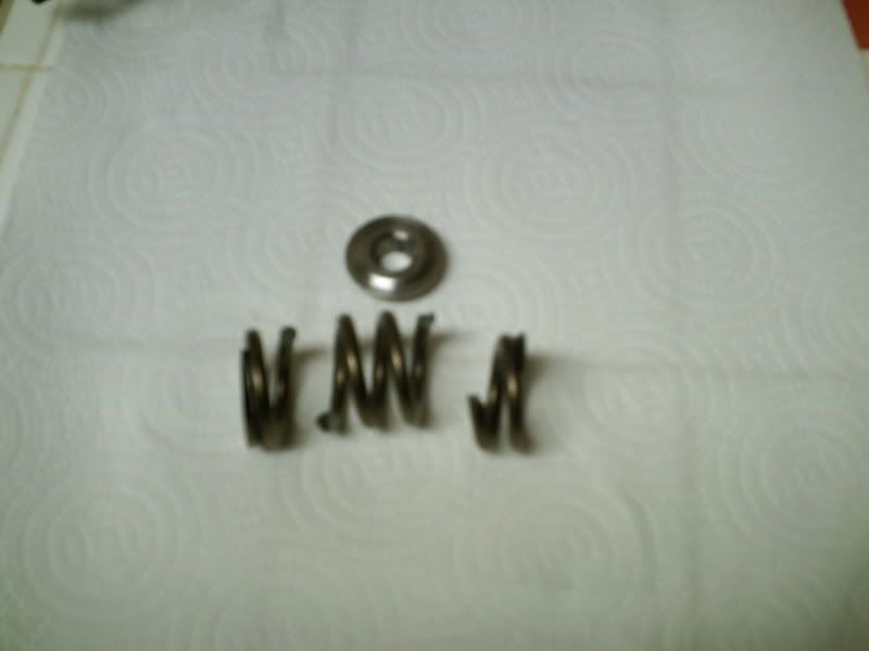

update...
ok i had to set up a couple of late night street races before i took this thing down to the body shop and left it there for week + so my friend set up a race between me and a supercharged Cobra a few nights ago and i absolutely drug his azz. anyway i was screwing around on the return road and i double clutched just to see if it would spark the tires at a 35mph roll and then i started rowing gears. well... I missed 3rd (DAMN HURST SHIFTER!!!) and a valve spring let go. Yesterday i swapped the spring out, and NOW its off to the body shop. good thing i didnt do that during the race. that would have been embarassing if i took a loss that way.

the carnage from race night
I guess these LS1/6 motors are notorious for breaking springs and bending push rods.

PostPosted: Wed Dec 20, 2006 1:48 am
Swap Specialist Mod
Posts: 2831
damn! broke in 2 places!

Japanese Redneck
Posts: 1125
I was pretty surprised... that it did that. the rev limiter is pretty tight in these cars (6600 I think). I did bang the limiter on the return road but it wasnt the first time and that really isnt much RPM. still, vettes have a reputation for doing that kind of thing and mine is no exception.
In any case the factory replacement is a beehive type spring... thats all the dealership has for a replacement part so that valve is the only one in the bank that has a beehive. I think i am going to replace them all with Isky Gold springs at some point in the near future.

PostPosted: Sun Dec 24, 2006 5:44 pm
Go with the beehive spring it is a good long lasting,and durable spring that you will probably never see again .(I hate working on my own stuff)
