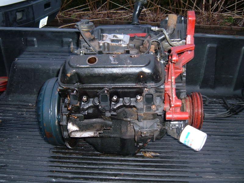

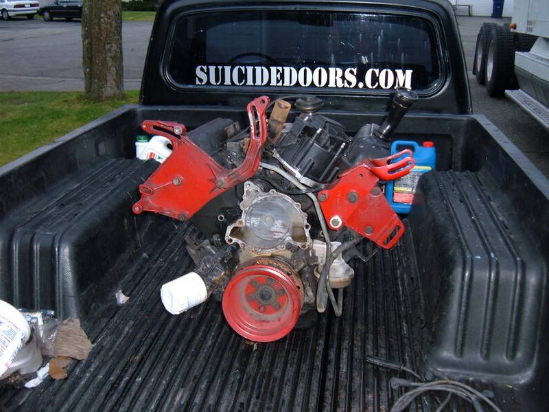

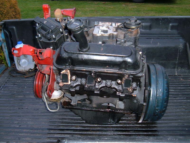

The other day I was looking through the ads and found this 231 V6 for the perfect price. :shocked!: Free!!! :shocked!: Im considering dropping this in my '78 but before I do what kind of fuel milage are you guys getting with these in your luvs?
Heres some pic's...

I checked the compression and looked at the oil it seems to be a good motor. I turned it over by hand but I'll find out once I get a new intake, carb and a vacum advance distributor.
I guess I'll just keep it for another project then. Fuel was cheap when I built my V8 luv but when I finished the swap gas prices went up. I thought the v6 would get a little better milage but oh well atleast I still got the 5-speed lol.
