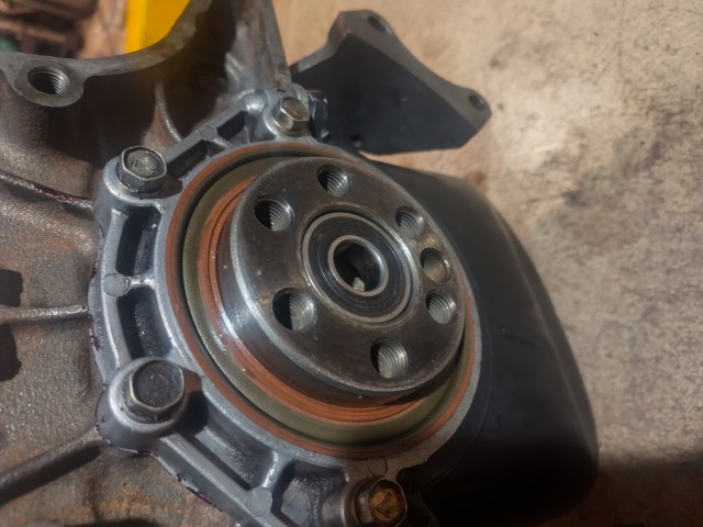

File comment: New pilot bearing installed

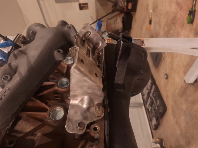

File comment: Primed, painted heat/splash shield

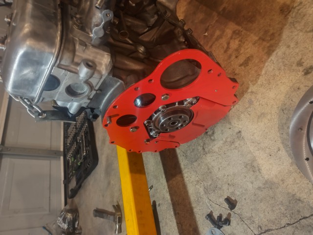

File comment: Resurfaced flywheel

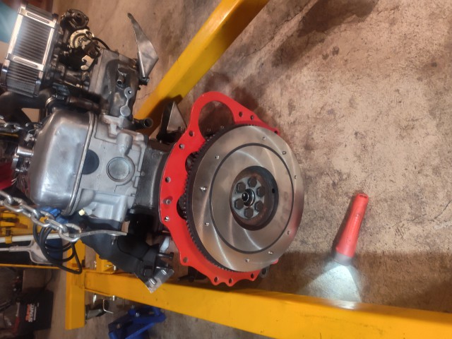

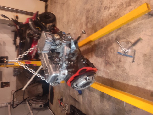

File comment: Clutch and pressure plate installed

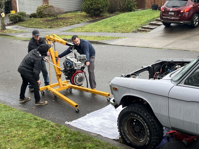

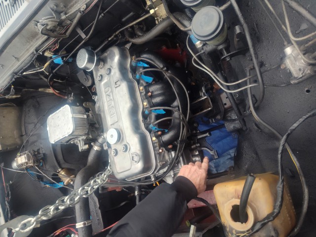

Yep, it's been up and running for about a month now. runs strong and smooth. I got a new Weber on its way cause the one I have on it has worn out components and the throttle plate gets stuck when returning to idle, I have tovfeatger and blip the gas pedal to get it back to idle. Also the idle mixture screw does absolutely nothing so I'm opting for a new carb rather than a rebuild. Im now working on a front end rebuild. Installed an idler arm assembly out of an 85' trooper, new upper/lower ball joints, new inner/putter tie-rods, new center-link and boots for my cv axles.
