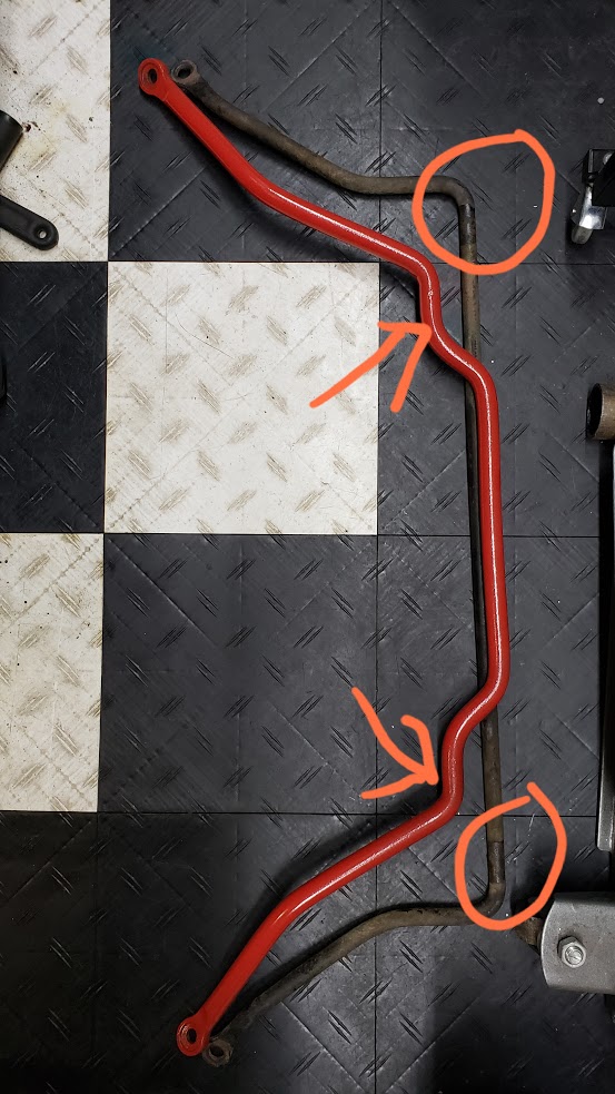

PostPosted: Fri Mar 20, 2020 8:38 am
Posts: 54
Location: Lake Stevens, WA
Does this swap work for 2WD luv? I pulled a 84 trooper sway bar and cleaned it up. Tried installing it but the sway bar bushing locations do not line up as well as the original post.
Worse case is move mounts in about 1-2" to match new sway bar locations
