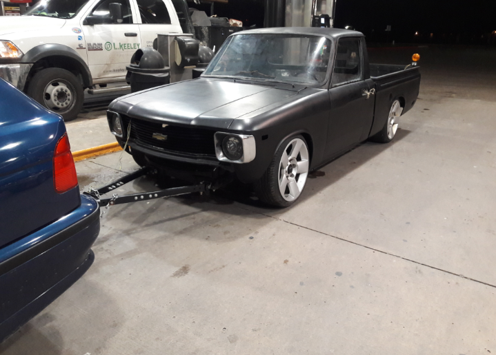

Hey this is my 80 luv lowered on 5 inch rear blocks and custom modded upper arms, torsion bars deleted, lower balljoint spacers. Rear monroe arimax shocks ma824

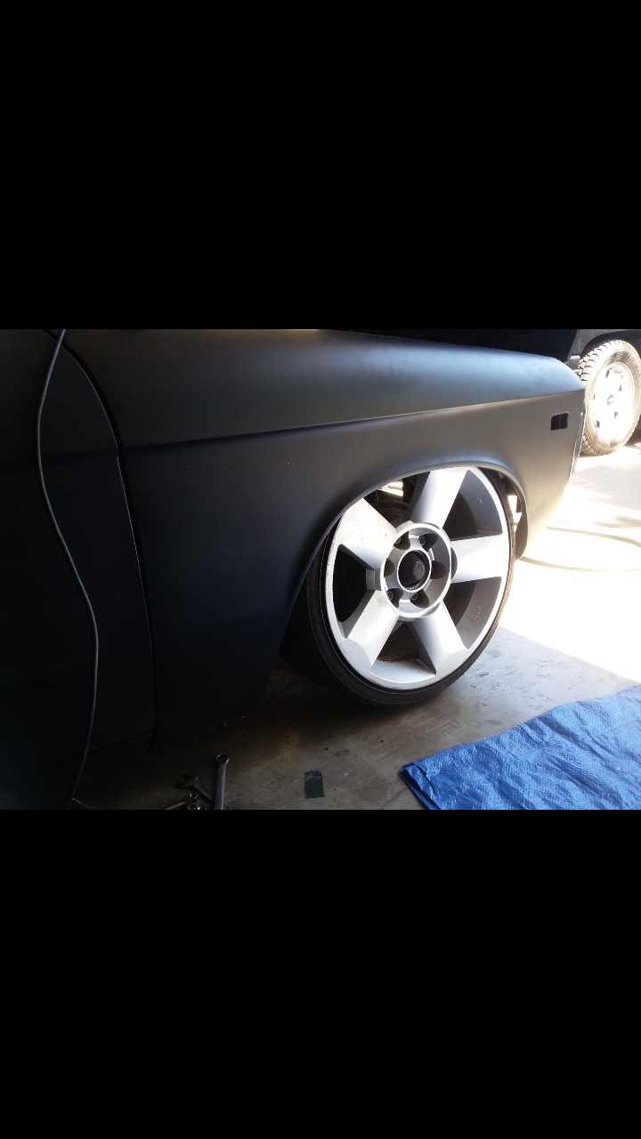

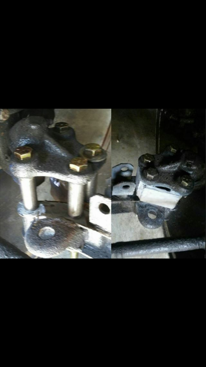

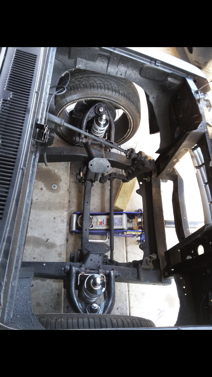

I have upper arms modified, cut and weld.for.a better balljoint angle. 1.5 imch spacers for the lower balljoint
