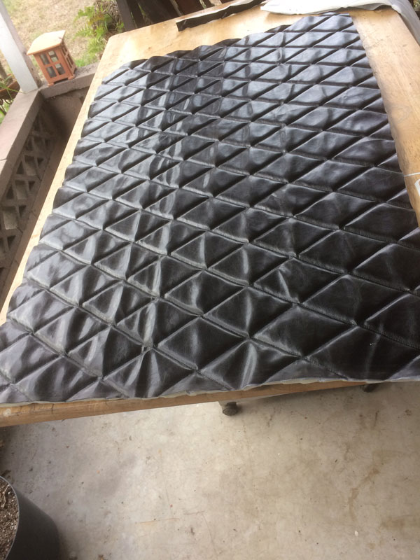

My 78 Luvs headliner fell apart mid summer so I pulled it all out and decided to copy the roof in my 72. The way the roof is constructed, there is a 1/4" gap around the top of the cab and the roof itself. This makes a perfect place to tuck in the edges of some material and make a headliner.
You could use almost any fabric you want and then glue it to some 3/8" foam. I chose to use some diamond pleated vinyl I found on EBay. It has the foam and some batting already attached. I bought 1 yard which was 54"x36" and I had enough to do the roof, the package shelf and make a matching dash cover.
I measured the cab and cut my material to 28"x45" to get close to the size

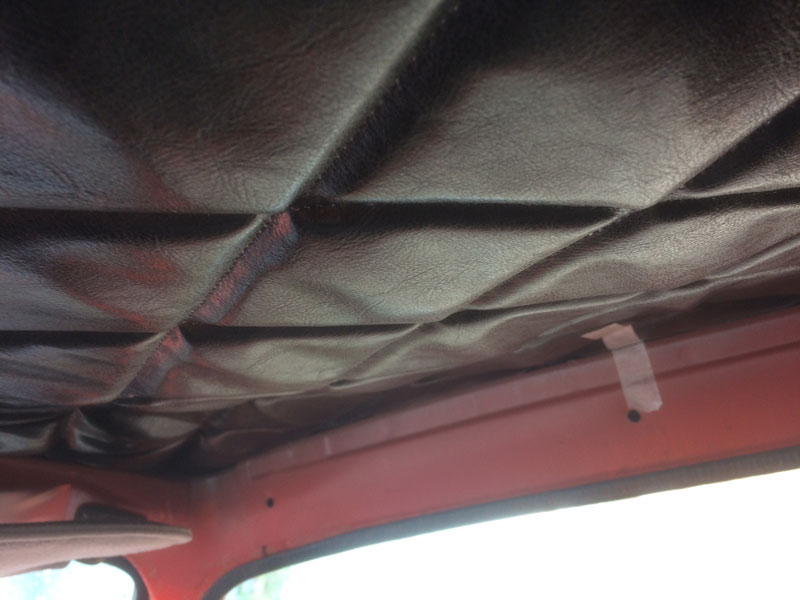

So its just hanging there I took pieces of masking tape and taped reference points for front back and sides. then took a light crayon and traced the edge of the opening where the vinyl is tucked in. All the way around and make sure you can see it.

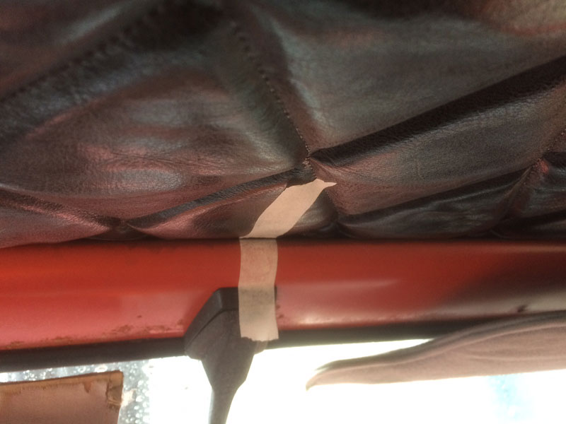

Another angle

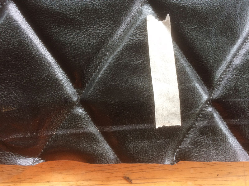

Next I pulled it out and trimmed the fabric to 1/2" from the crayon outline of the roof. This makes less fabric to have to stuff in and a closer fit.

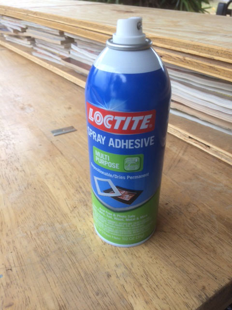

Next is the adhesive, follow the instructions on yours. I sprayed the entire back of the material and the roof of the truck. Don't fprget to cover the seat and dash to avoid overspray

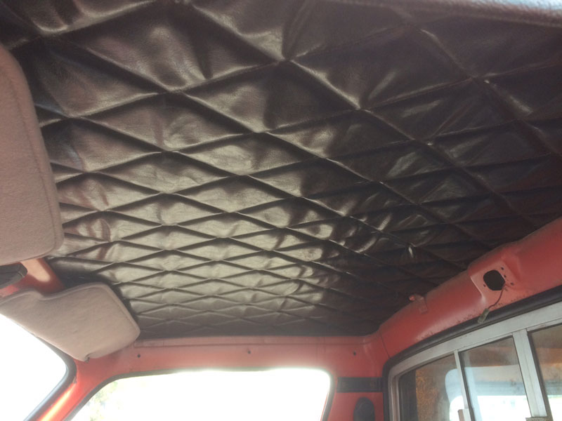

Now that tape for alignment comes in. I started with the sides and then went front to back. The adhesive is repositionable for a short time. I thought it went in easier than expected.

Ok, it looks like the Loctite glue I used was not strong enough to hold the fabric up to the metal roof. So I am going to retry gluing it with some 3M professional grade fabric adhesive. I will update this when I get that done. We had some upper 80's last week and it was sagging when I got in last Saturday. The glue is still tacky but not holding it in place. :roll:

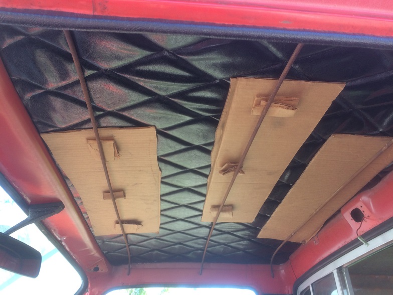

I got the headliner glued in again and it is holding well now. I wound up using 3M super 77 and so far it is working well. I also used some cardboard along with the original headliner bows to hold it up for the first 24 hours. It has been a couple weeks and it's sticking good. The original glue I used is more for crafts not upholstery.

LUVTRKR Did you glue that material on a panel of sorts 1st for stiffness or just spray n stick the material to the top of the cab ?
PostPosted: Tue Feb 14, 2017 7:19 am
The material had a foam backing sewn to it already. Per the instructions you spray both surfaces then wait for a few minutes for it to set up. Then put it in place. It's good to have alignment marks on the material and roof so you can get it in the right spot.
