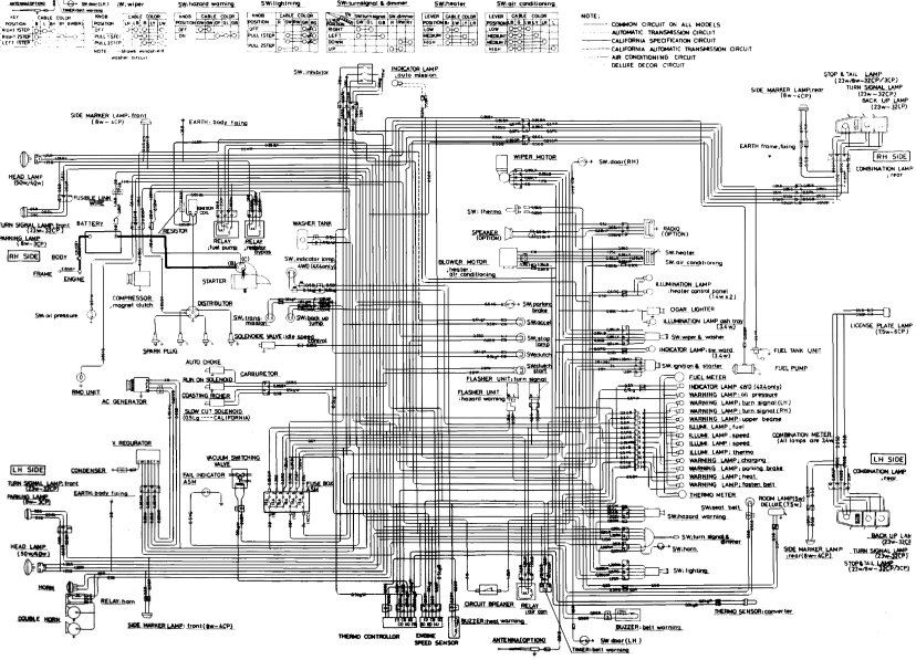

I've posted the wiring schematics for a 1980.
It's not very clear in some places but this is the best diagram I've found.
Hope it helps.

Thanks for the info and the wiring diagram.
I was thinking of going with this fuse holder:
http://www.ebay.com/itm/Car-Truck-Van-6-Way-Circuit-Standard-ATO-Blade-Fuse-Box-Block-Holder-12V-24V-/290924672899?hash=item43bc763783&vxp=mtr
Would this box be straightforward for wiring? I believe my 80 Luv's wiring is stock.
