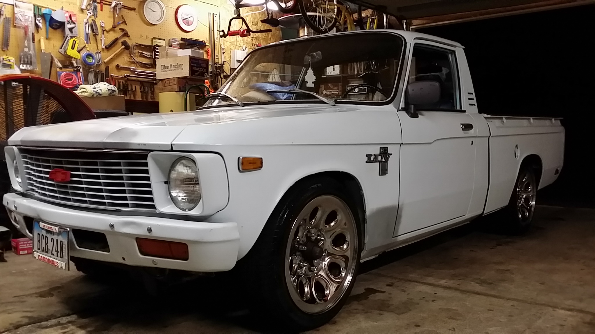

FRIGE..... THANKS so much. Got them today and here is the final result. ....back on the road again.
