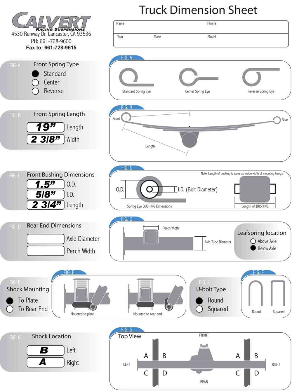

My leaf springs are ruined and CANNOT be measured. Does anyone know the measurements for the leaf springs on a 2wd 74 Luv?

Here is a link to what Calvert tells me that I need. http://www.calvertracing.com/documents/CalTracsDimension-truck.pdf

PostPosted: Thu Mar 13, 2014 10:10 pm
Here is what I came up with. On the original Calvert form their diagram shows the axle under the spring. On a Luv the axle is over so I measured over the leaf. My measurements were from 1972 springs. I do know that the 76 springs I have on now use different size bushings and bolts than the earlier trucks.

PostPosted: Fri Mar 14, 2014 10:25 am
HotRod80 said that Calvert has the measurements. I would hope they can confirm what I measured just to be safe.
