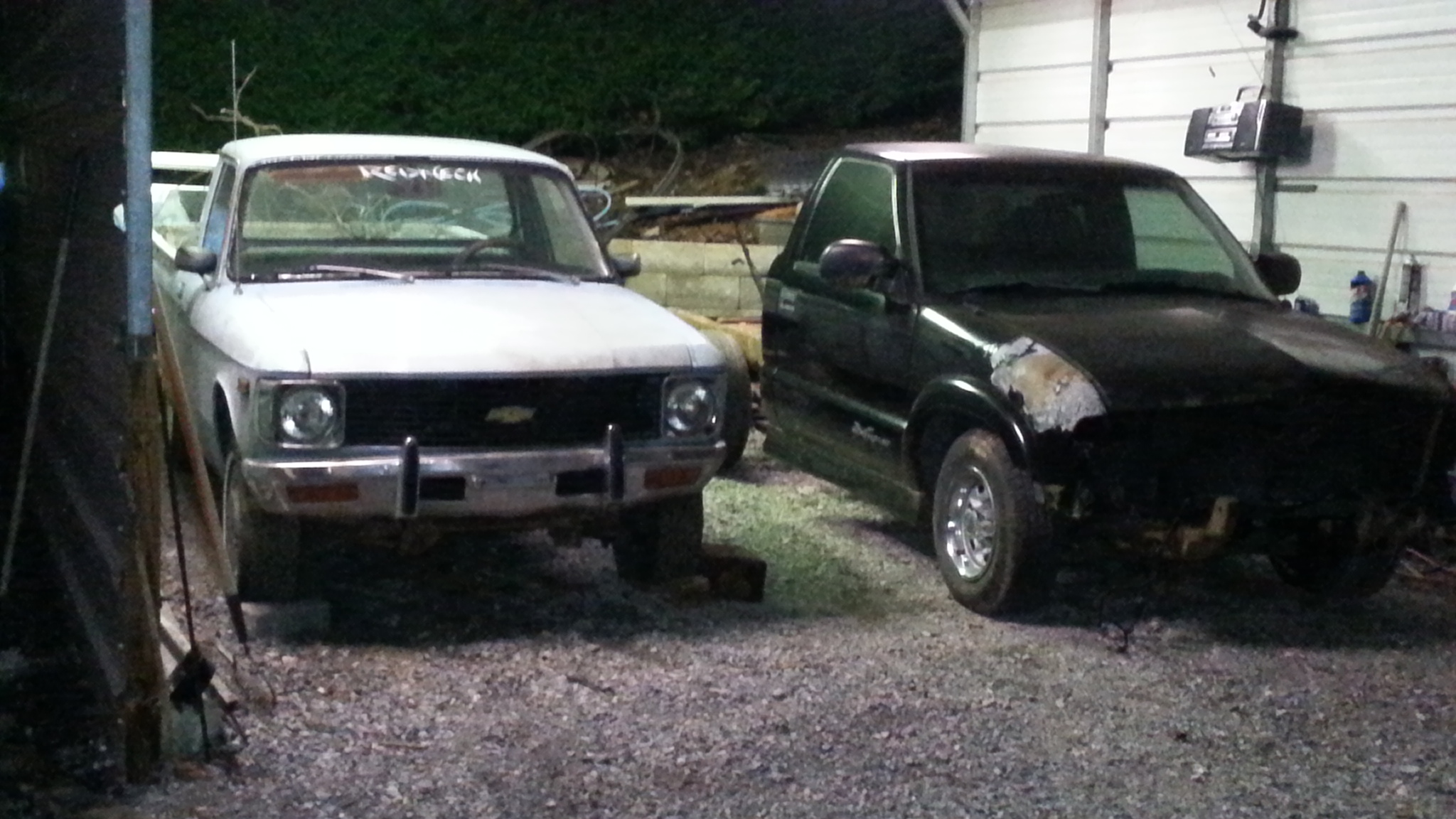

Gonna start on my S10 frame swap soon. My Luv frame is Rotted beyond repair and I like the ZQ8 option the 99 Extreme has.
