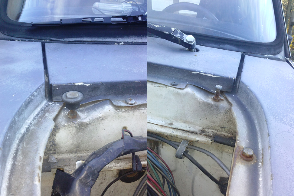

On my 80 Luv 4x4 I have one of the rubber hood rests (not sure if they are called something else) missing.
Just wondering what other Luv owners have down to replace them? Maybe take some JB Weld and form the same shape?

I am looking into a possible lead on aftermarket part for this. I've been asked if I have an OEM part number for the rubber hood bumpers.
Maybe one of the following people have this info: oldestisuzuist, Luvrv8, Tilted
If anyone has that number, please reply. Thanks! 8)

Don't have a part number,but those are universal Japanese parts. I have the same ones on my 89 Camry,same size,same shape,but the Camry ones have a Phillips head "screw" in the middle of the rubber to hold it on,while the Luv parts are solid rubber...

Same part number for series 1-10
Bumper (rest asm.). 90402858
Bumper (rest). 90420859
