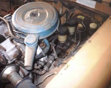

Now i need to ask if the motor is original to the truck? Does it look like this?
PostPosted: Fri Jun 09, 2006 2:59 pm
Posts: 2013
Here's a pic i found in the gallery. Next to the brake booster in the corner just aft of the fuse block, you can see a clutch cylinder on the firewall. The slave cylinder bolt to the side of the trans (passenger side).
