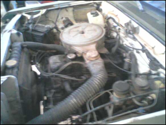

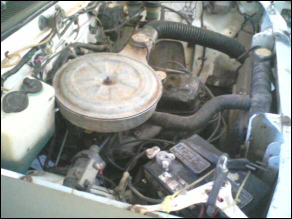

Well, after completely rebuilding the stock Hitachi last year, the acceleretor pump bit the dust.
I decided it was WEBER TIME!! Got the Redline conversion kit, and using the Youtube video of the install for referance, she's Weberized!
BEFORE:

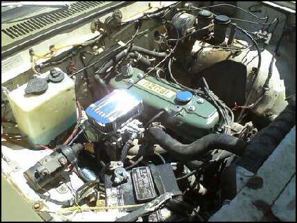

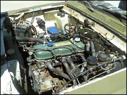

AFTER: 8O
The Redline kit is great, and the Youtube video was especially helpful in knowing what to remove from the stock carb and how to mount it to the Weber.
My black phenolic spacer was intact, so I bolted the adapter(s) to it rather than to try to remove it.
I also got a 3 nipple fuel filter (for an 81 jeep application) designed for the fuel return line.
All told about 2 hours and $350 invested.
Worth every bit of it!
