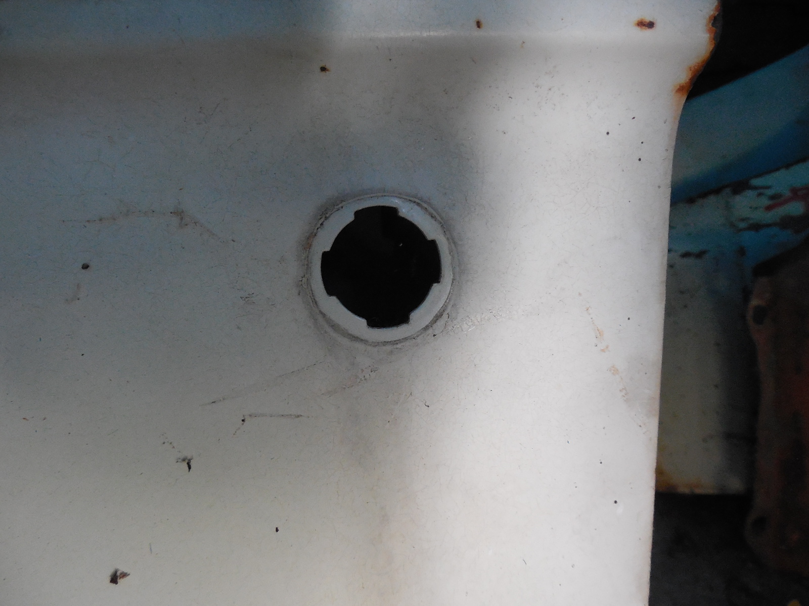

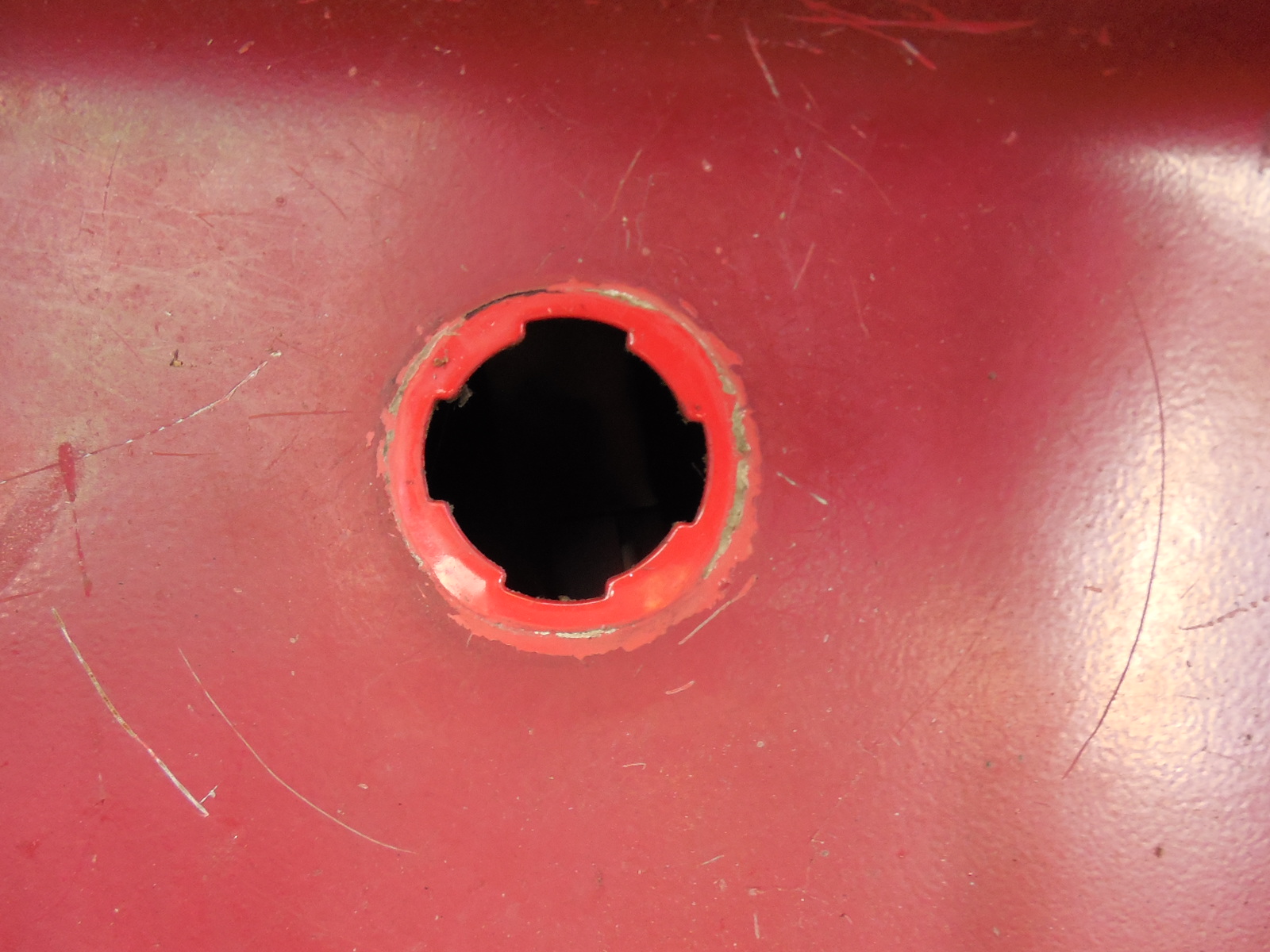

PostPosted: Mon Sep 18, 2017 12:01 pm
Posts: 607
zelelelachlan wrote:
I have bought 3 lock and cylinders now, and they won't fit the doors of my new 1980 Luv. Is it possible that the doors could be from a different model? The doors on it have the triangular window at the front that swivels out.
Thanks in advance
How sure are you them locks are for a Luv ... maybe post up a picture of your parts someone could notice a difference
here's the lock hole on 75 white - 80 red door & my 77 is the same
& PART #'S ON THE EBAY LINK ARE 1 # DIFFERENT IN THE 2 SO I GUESS LEFT /RIGHT LOCKS
http://www.ebay.com/itm/Isuzu-KB20-KBD- ... gj&vxp=mtr
