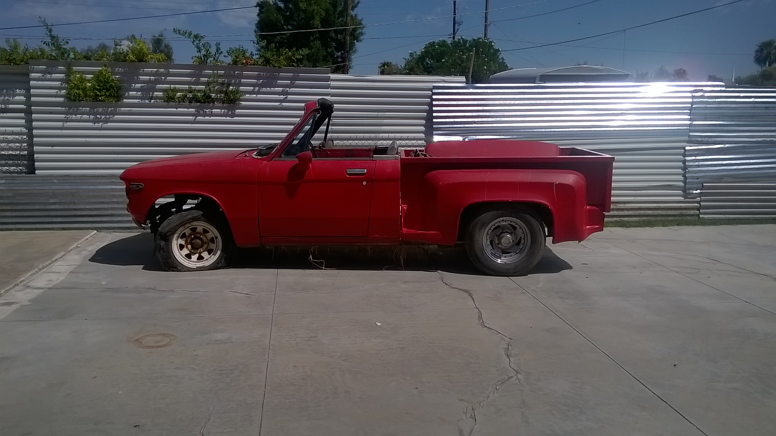

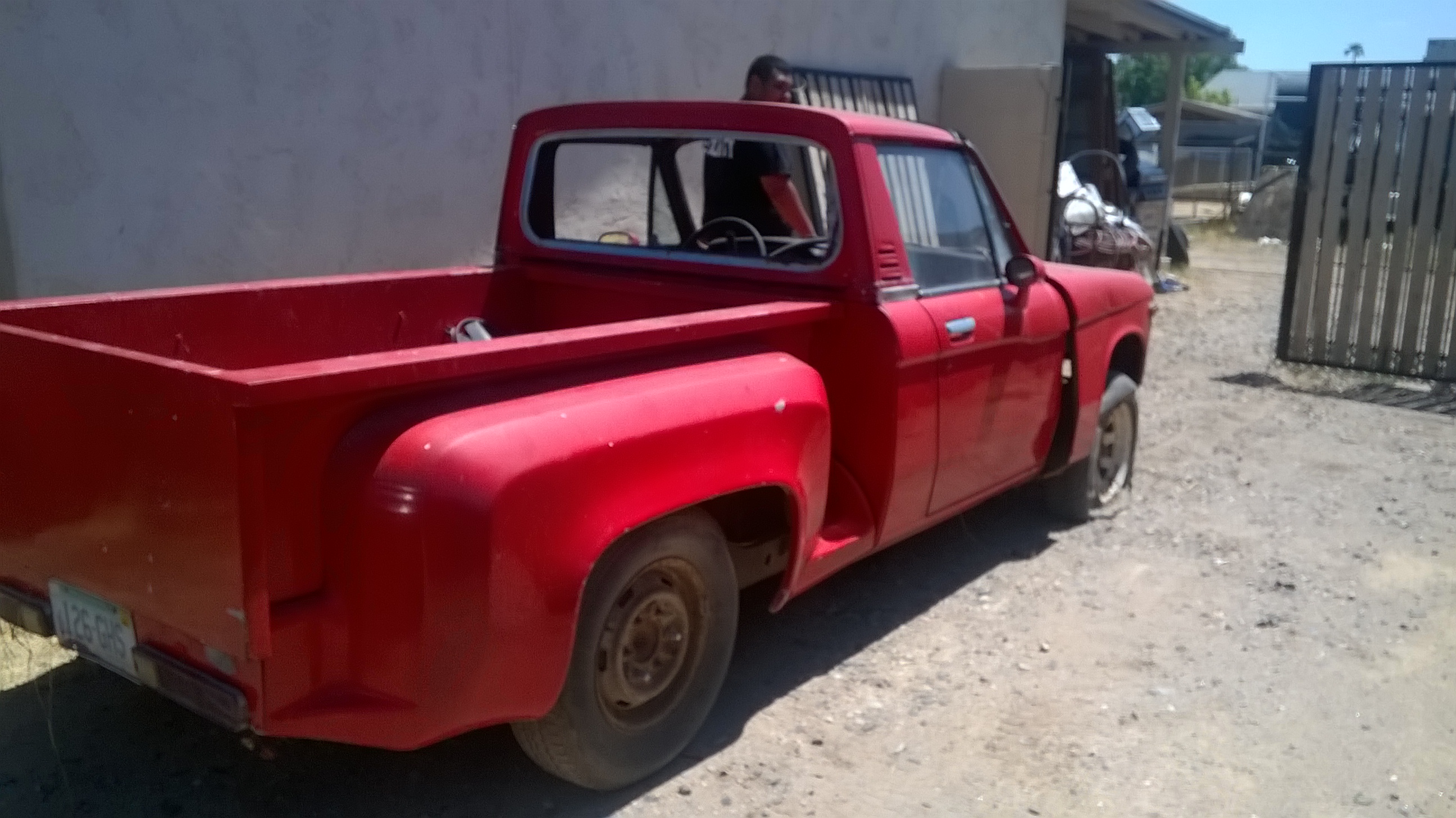

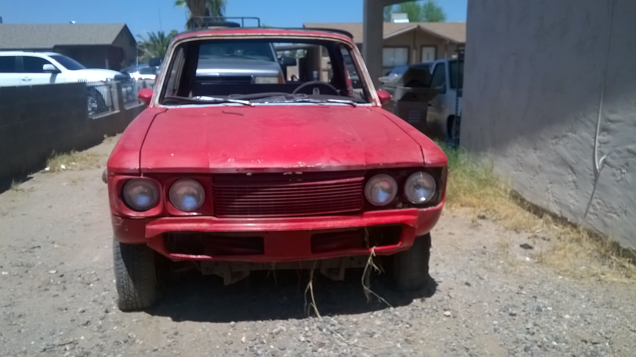

Hi I'm new to the LUV world, I just got a 1976 Chevy Luv stepside convertible project and I'm planning on putting a 5.3 V8 Vortec with a 4L60E tranny, but don't know where to start. What kind of motor mounts will I have to use. Will it be a bolt-in or weld to the frame. Any info and-or pictures would be very appreciated
