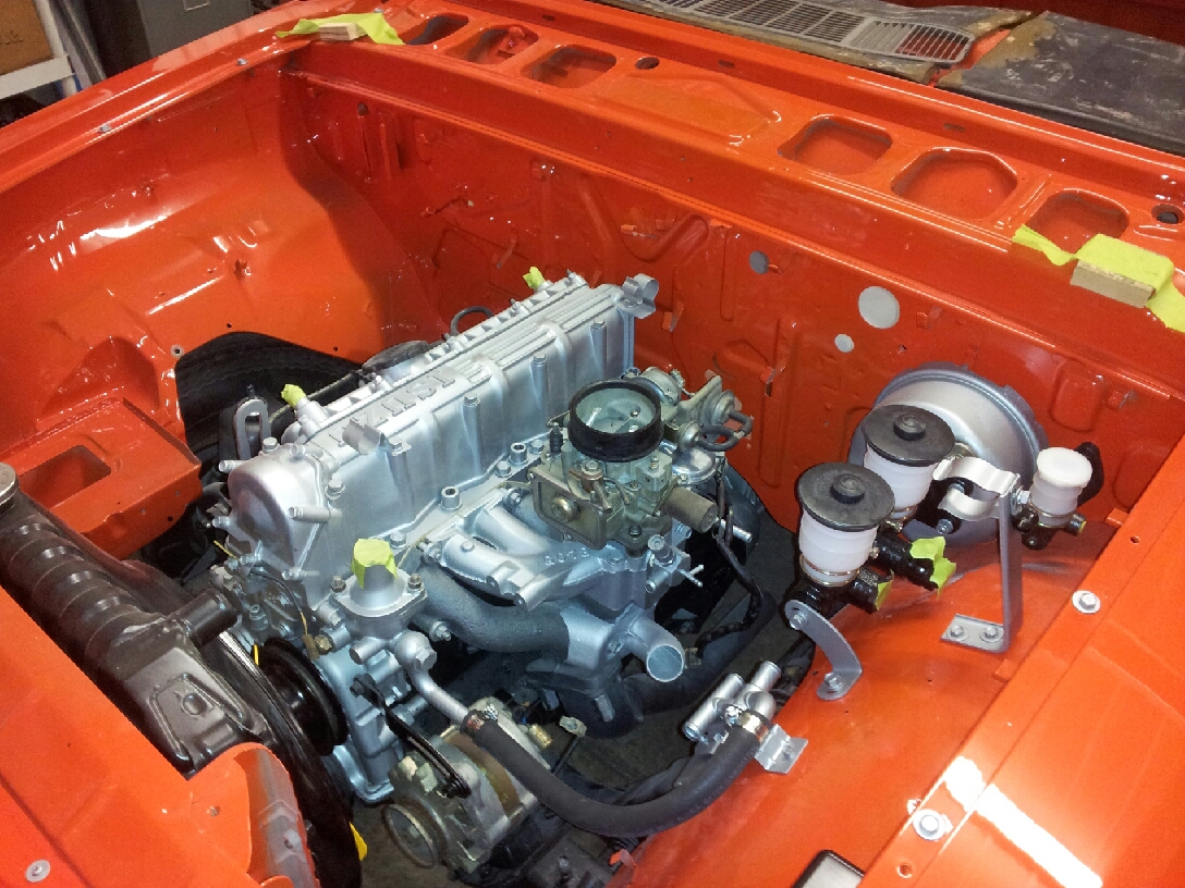

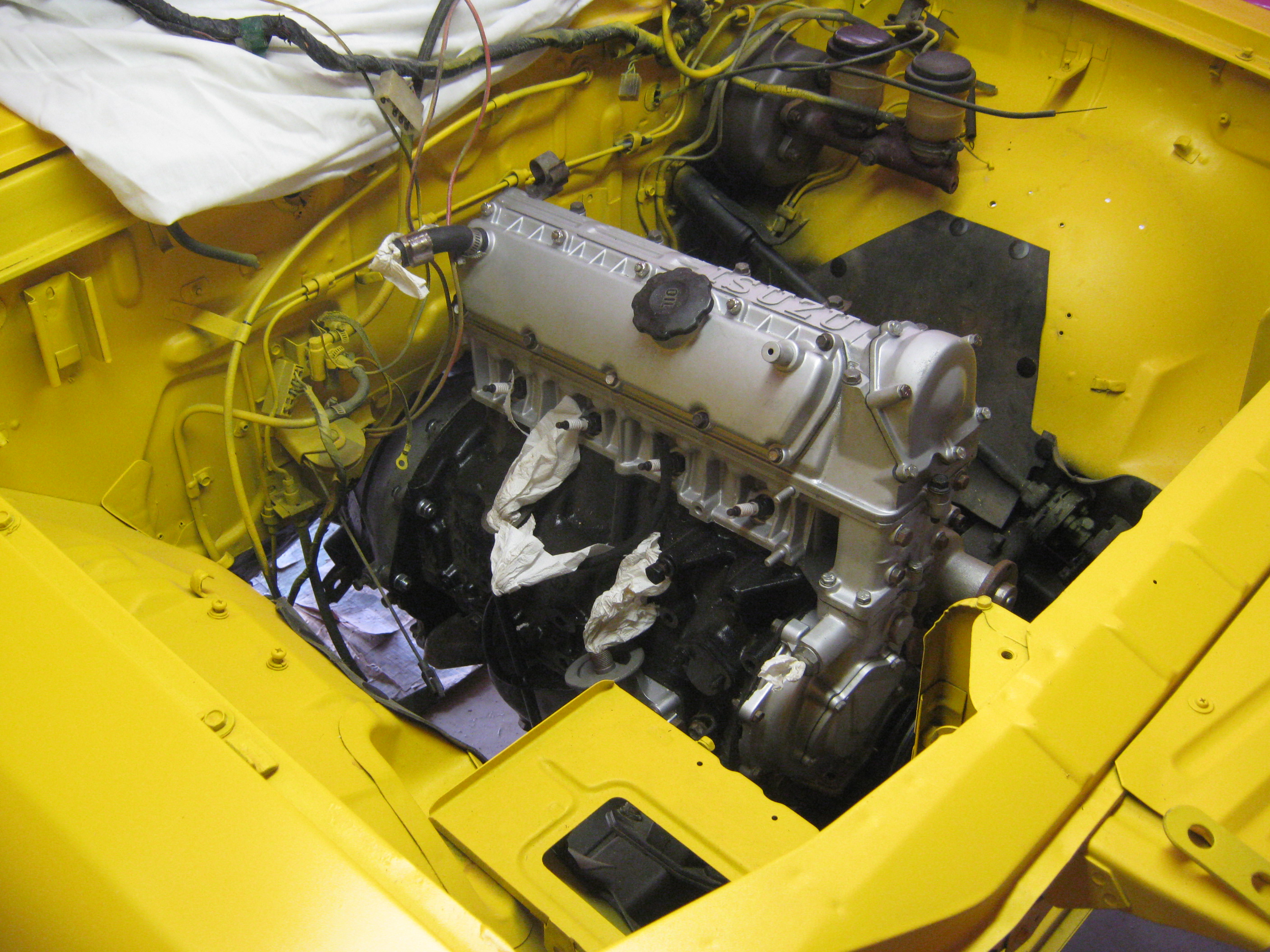

Thanks for the replies. It has been suggest to use the flat top pistons and shave the head to regain lost compression from not using the domed top pistons. Here are a couple of photos of the 1975 engine. the yellow one is mine and the orange one is from off the internet. Also another configuration in the shop manual show what look like air tubes coming from out of the block leading to the valve cover. You will notice in the photo of the engine in the orange, that these tube holes have been plugged. There are no holes for these tubes in my engine block
The mystery is, are the combustion chambers the same and did the manufacturer just installed the domed pistons or is there an actual difference in the two heads.
Here's some photos so as to maybe joggle some memories out there.
Where is that dang Isuzu guru named Joe when you need him?
Thanks

Isn't the yellow engine the later crossflow engine? The early engines have the intake and exhaust manifolds on the same side... Tiny pics and my phone may lead to confusion on my part...
PostPosted: Sun Jun 21, 2015 11:08 pm
They are both the early engine just different sides. It's been since 1988 since I had a head off of a early engine but u do remember the Pistons being flat tops or possibly a slight dish.
