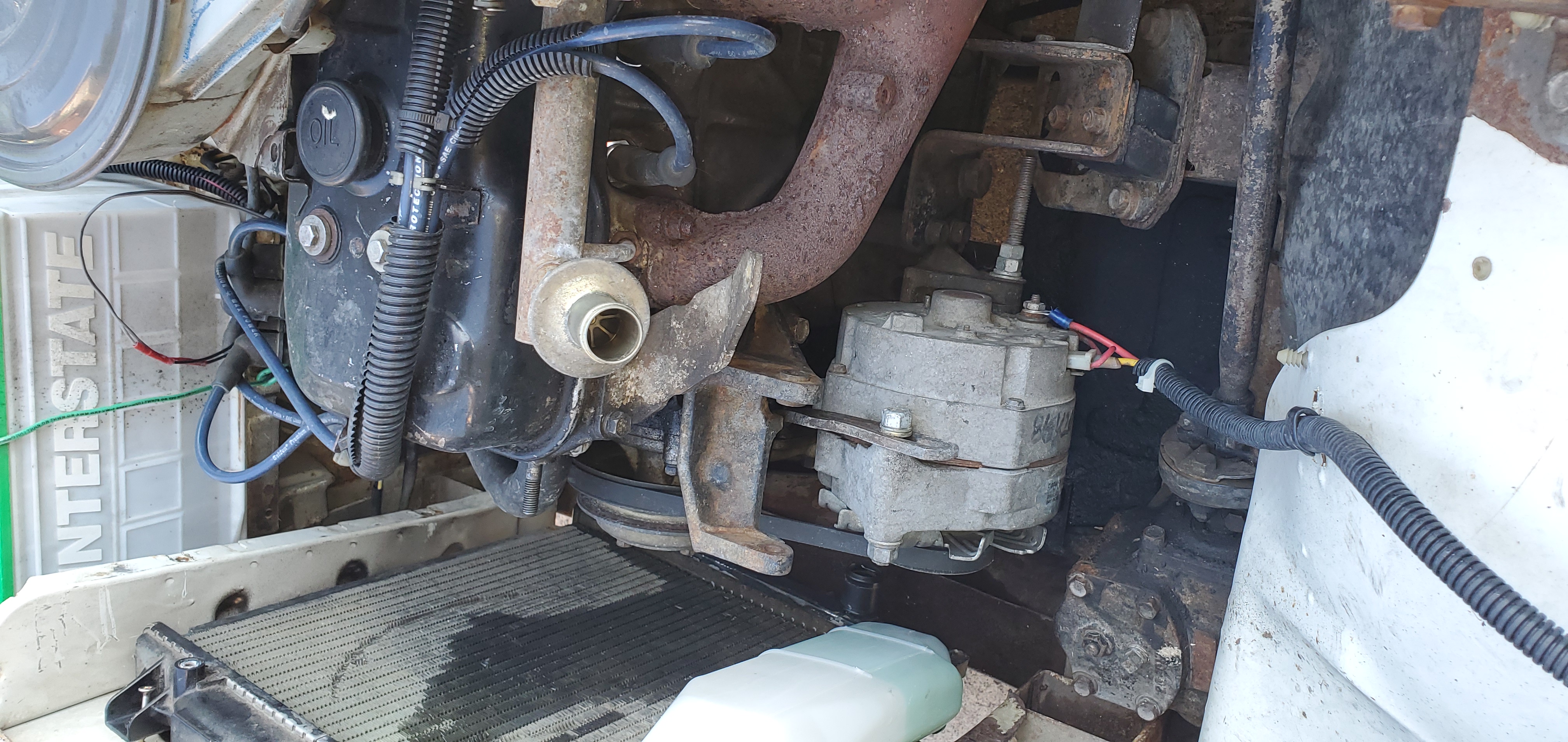

What's the outer pulley/missing belt for? I got the truck without these parts

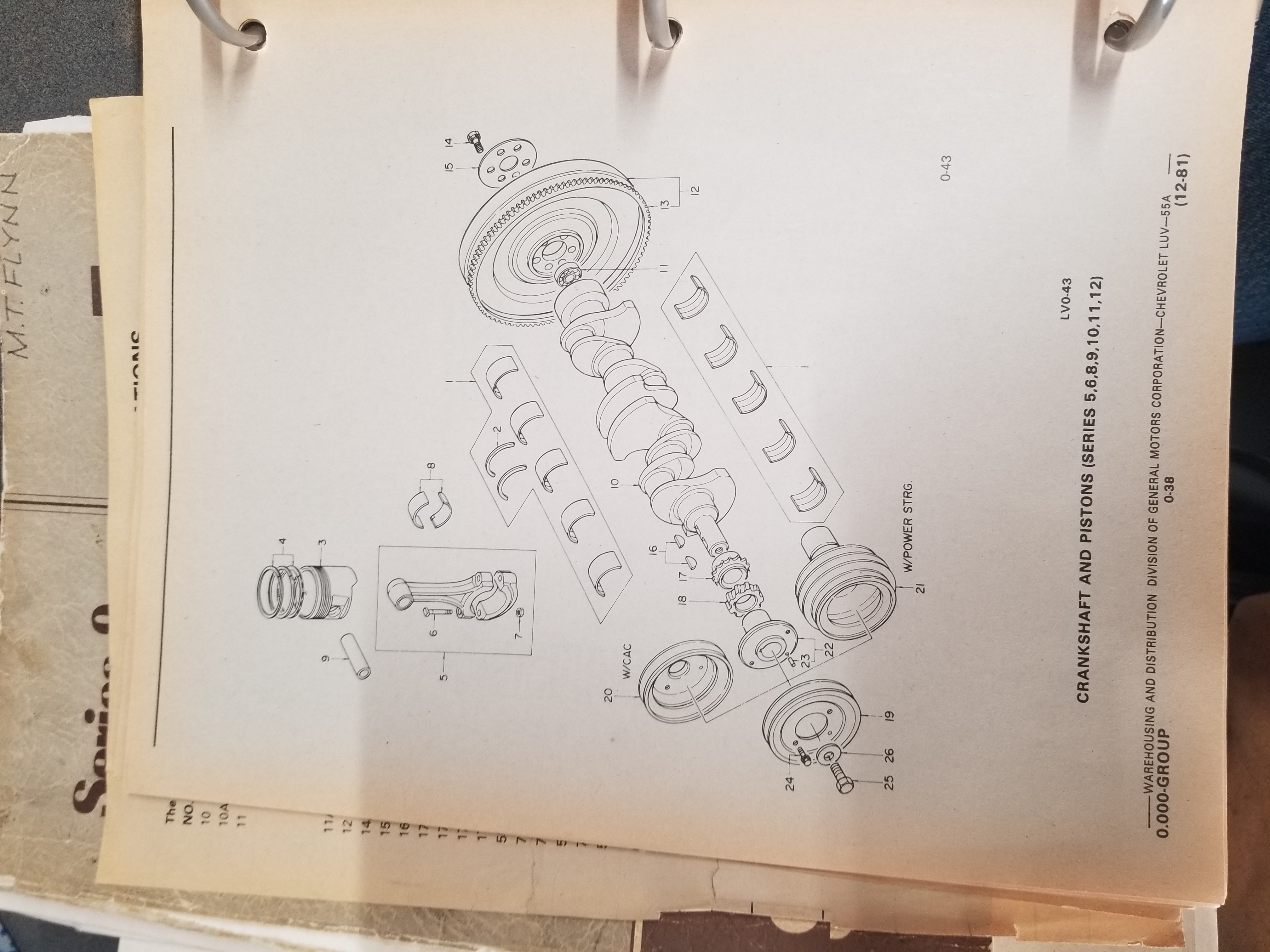

Would that outer pulley & missing belt be for models that came with AC?
Either way, does anyone know if these pulleys separate or if I need to find a single groove pulley to replace it with?
Something like this... https://www.speedwaymotors.com/Holley-9 ... 91663.html
PostPosted: Thu Aug 06, 2020 10:51 am
Yeah the mikado models came with ac. Not sure if the pulley separates but you could maybe find a single groove in a junkyard or buy one from someone here.

File comment: As you can see, I got the 2nd pulley off, but even putting on an after market single setup, that shaft is still poking out. I know small blocks came with short and long shaft water pumps. But don't know anything about this isuzu setup
PostPosted: Sun Sep 06, 2020 5:44 pm
I'm trying to remember, I think a spacer is used in place of the pulley. I doubt there two different water pumps for these trucks. I know what you mean on the SBC though.

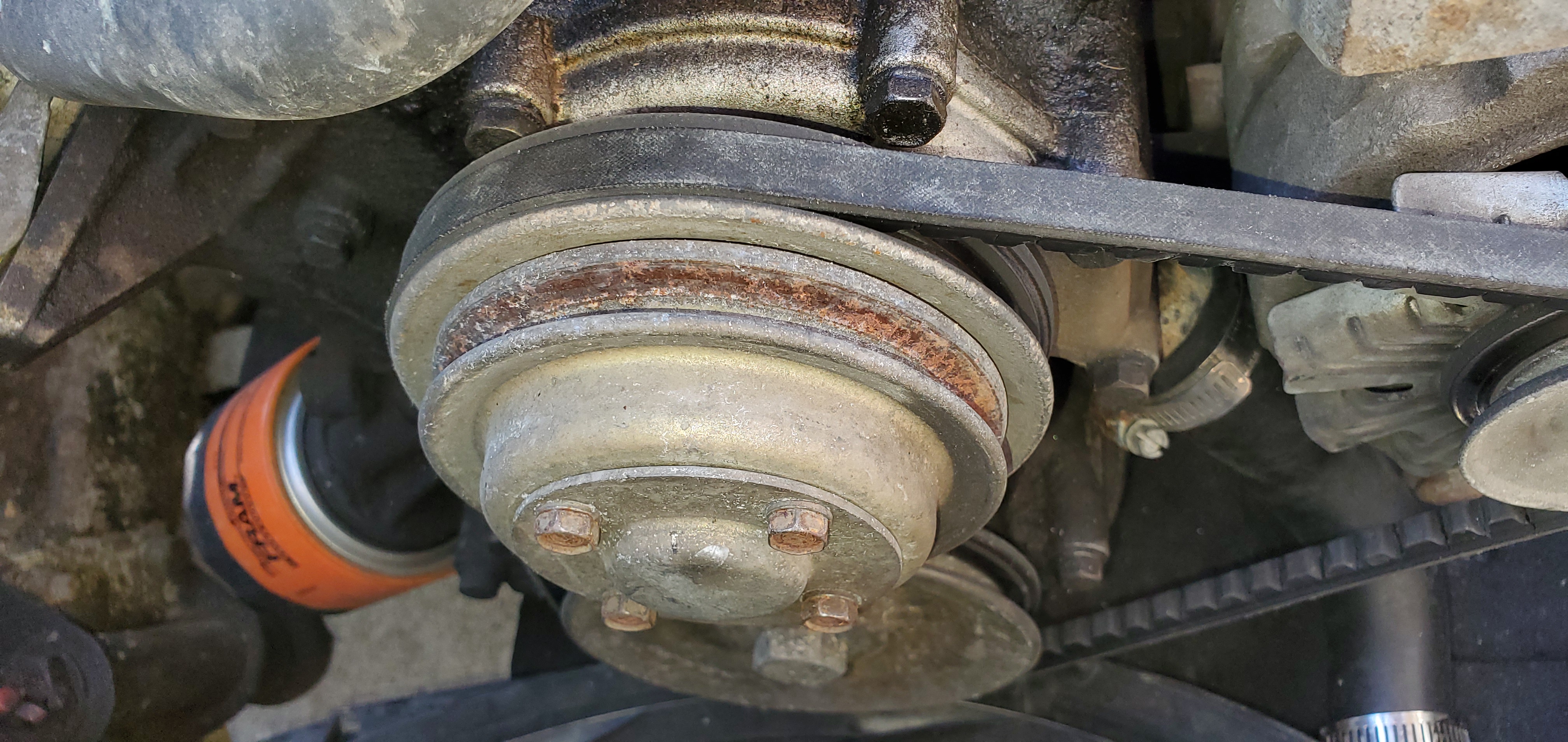

Not sure if it is any help, but this is from the factory parts book.
