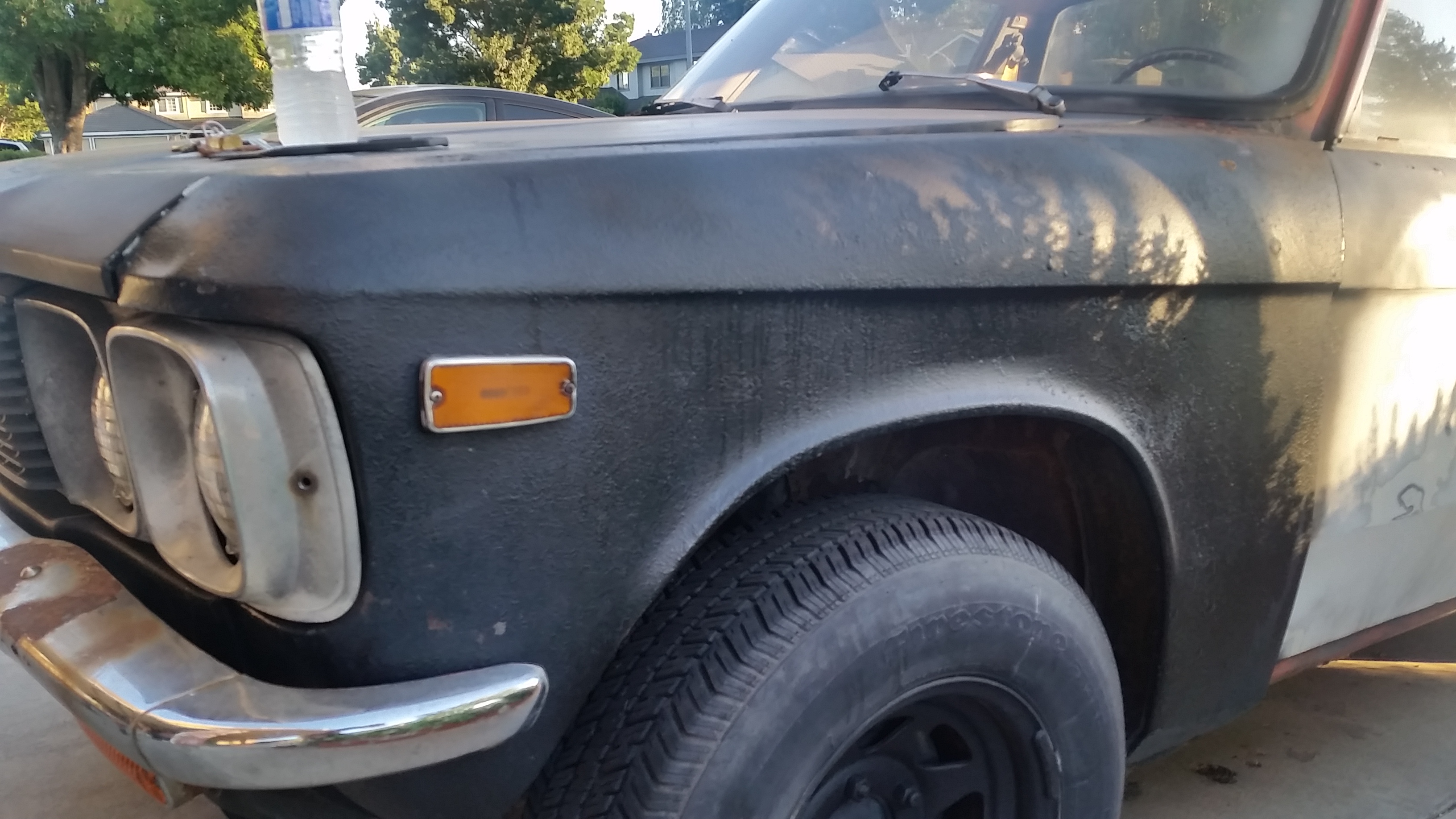

Ok this is my 74 luv. Been owning it since feb of this year. Ive done stuff and a few lil mods to it already. Im goin to start on removing bedliner from the fenders. Hope this stuff works.

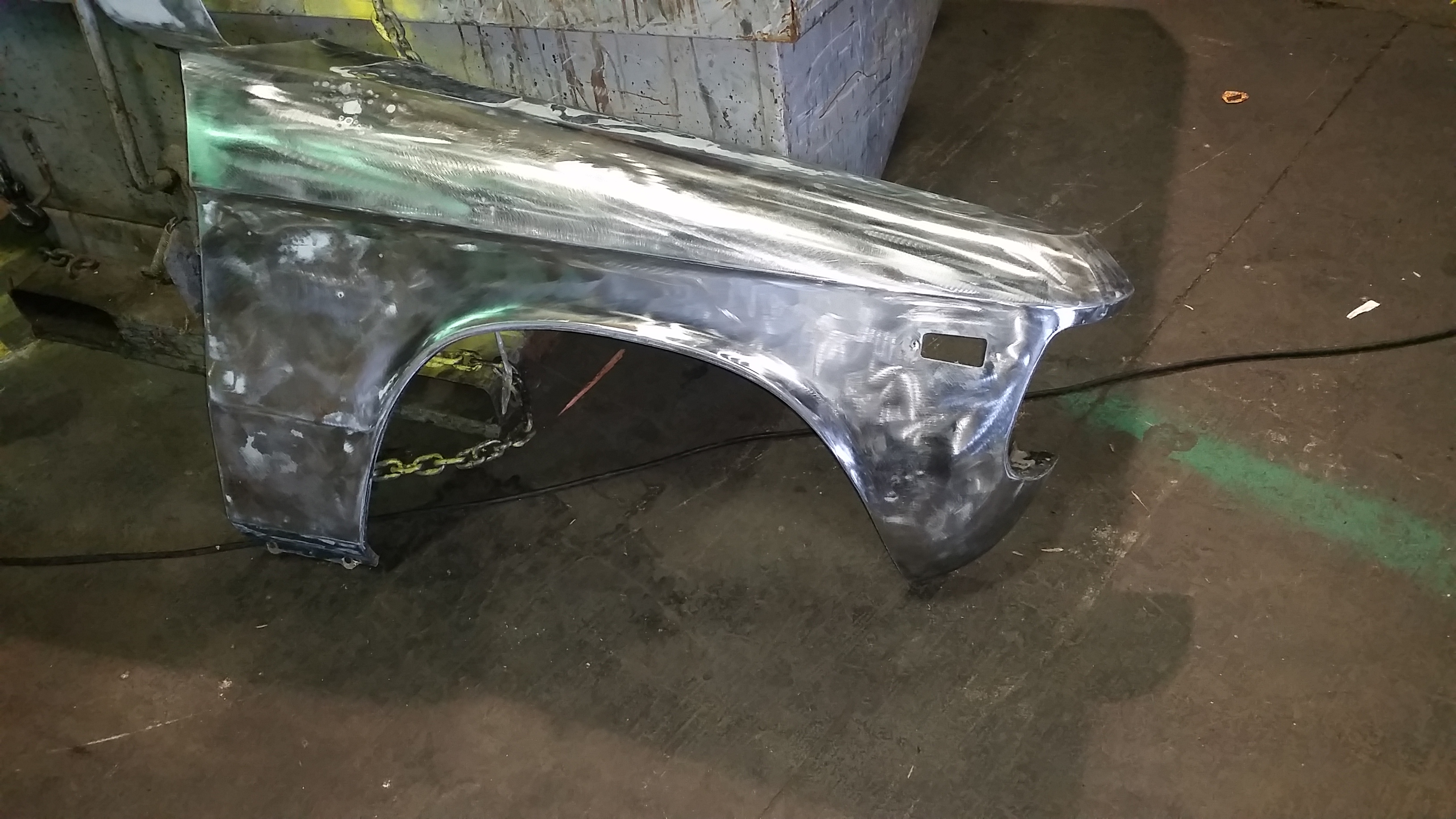

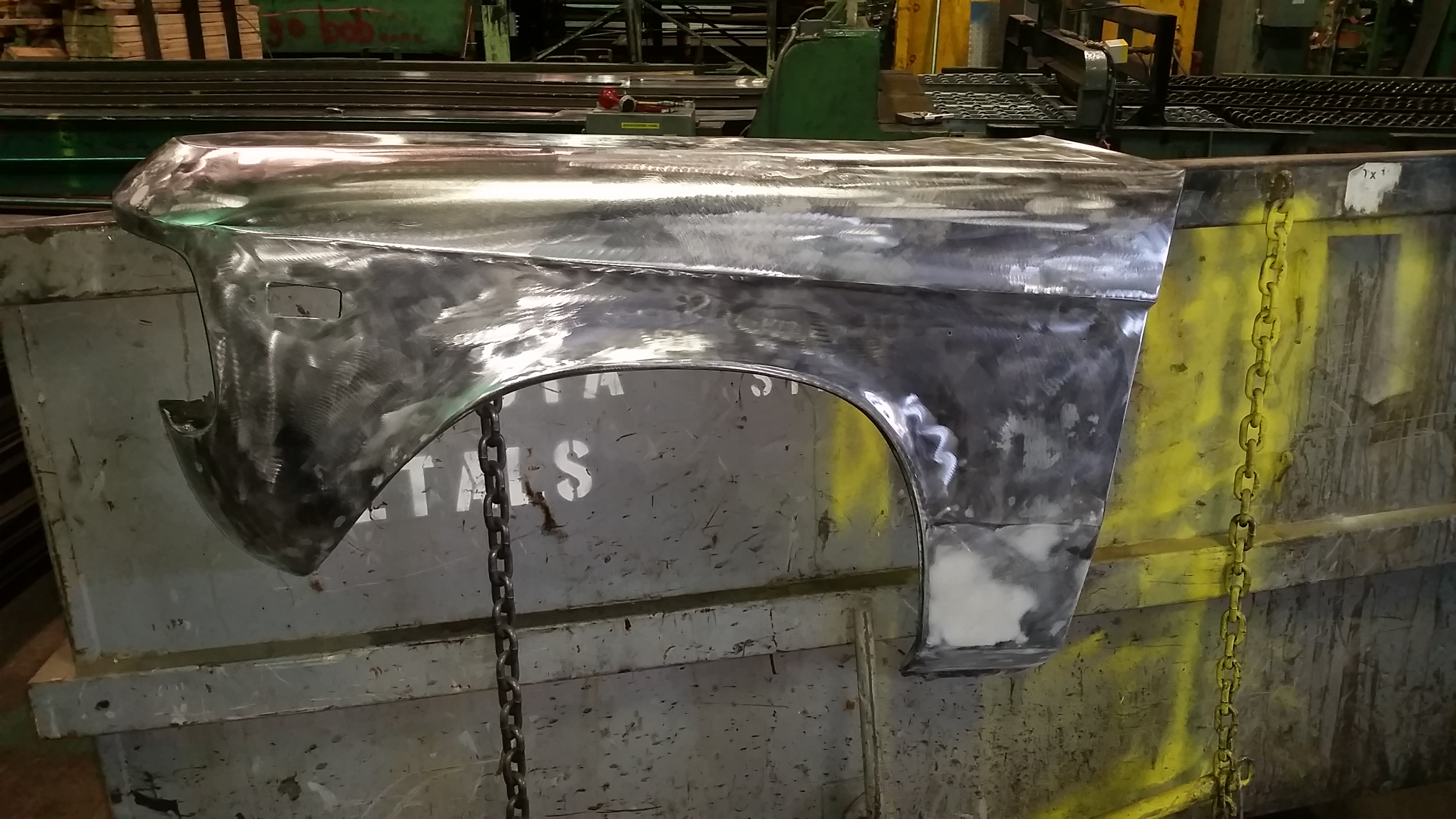

Well ive had a few slow days at work and i was able to work on my fenders. I used some of that jasco epoxy remover to remove the bedliner crap from the fenders. It worked pretty good but still had a rough time getting it off.

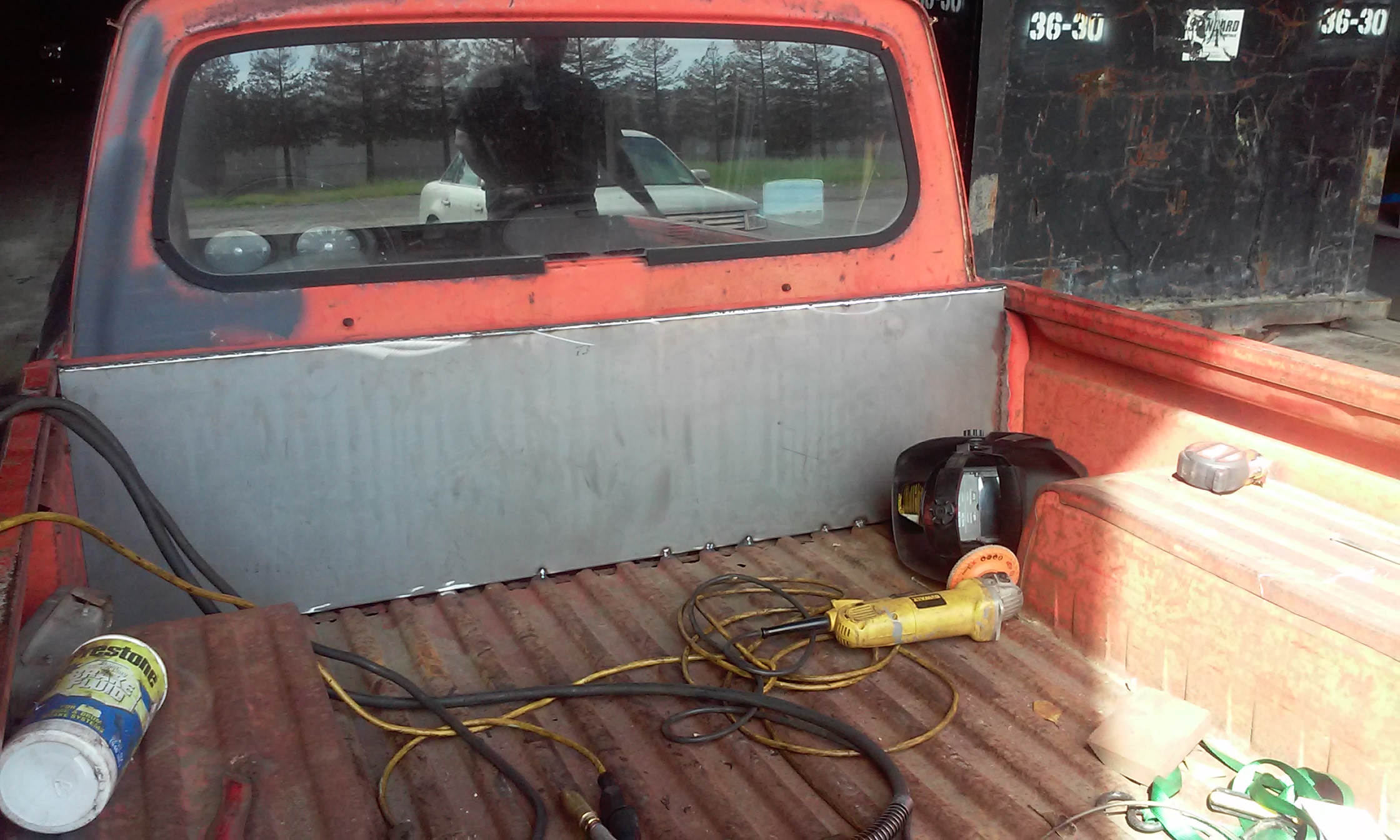

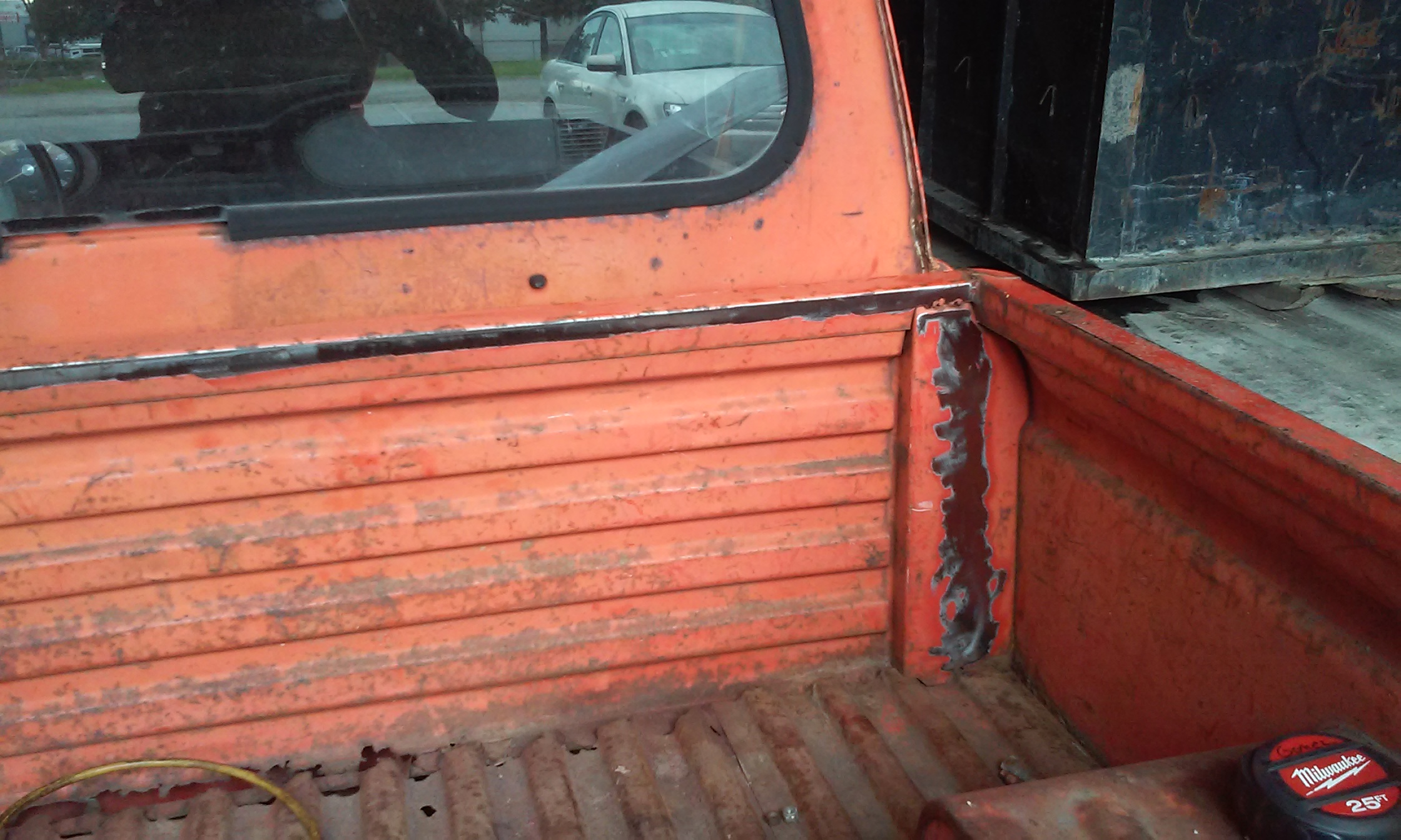

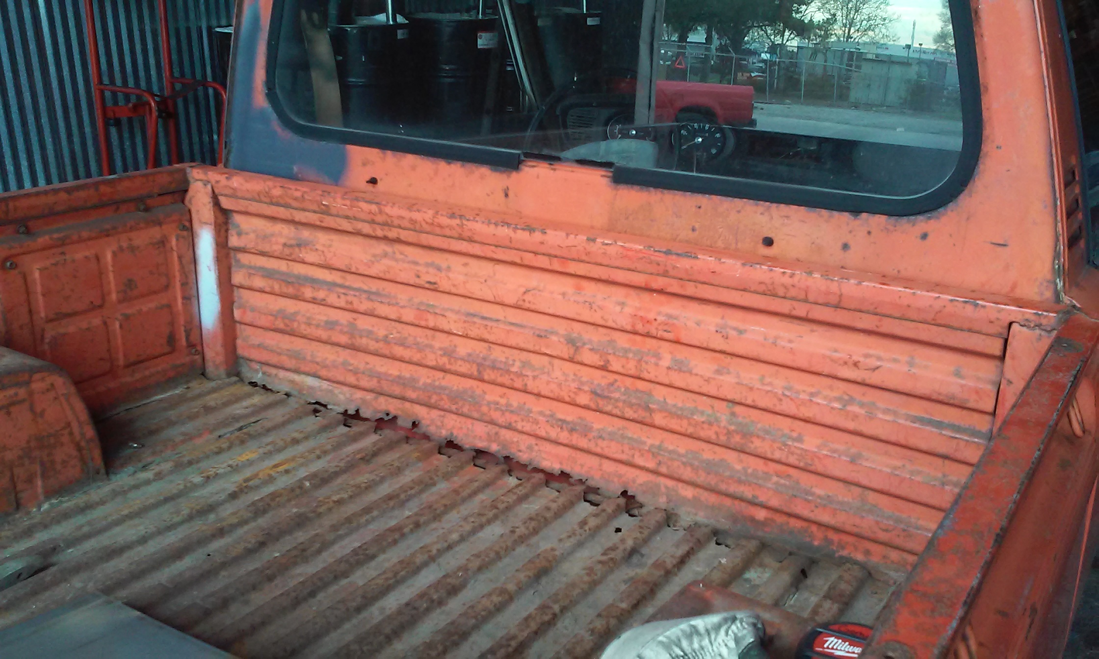

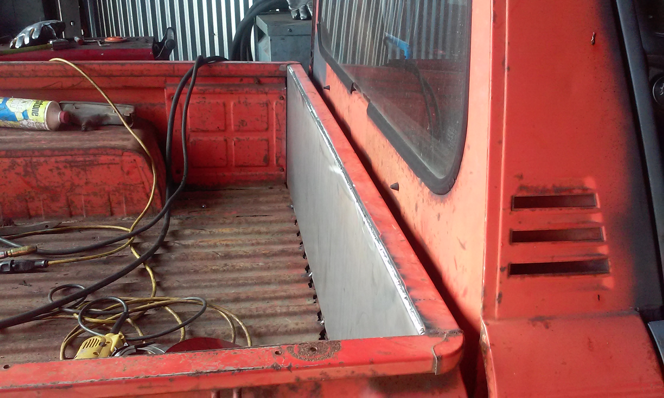

Well my luv doesnt come close to looking like east coast luv, but i did do a lil work on it today at work. Im planning on maken the bed double walled. I did the front of the bed today.

After.

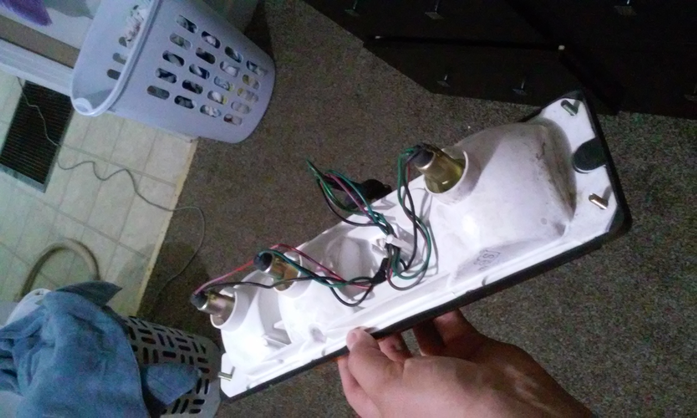

Just got another nos tail light this one for cheap on 19.99 on ebay.

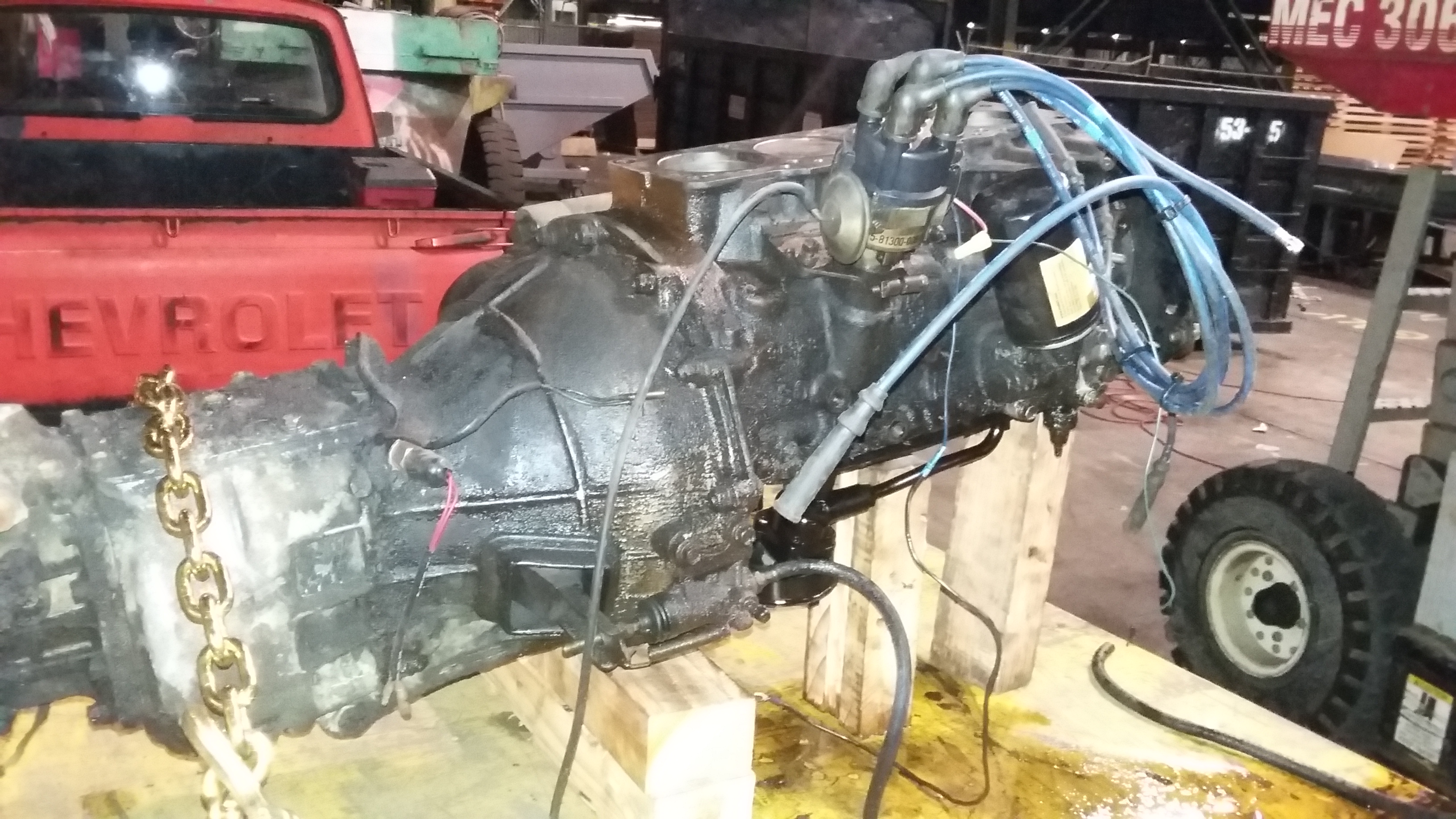

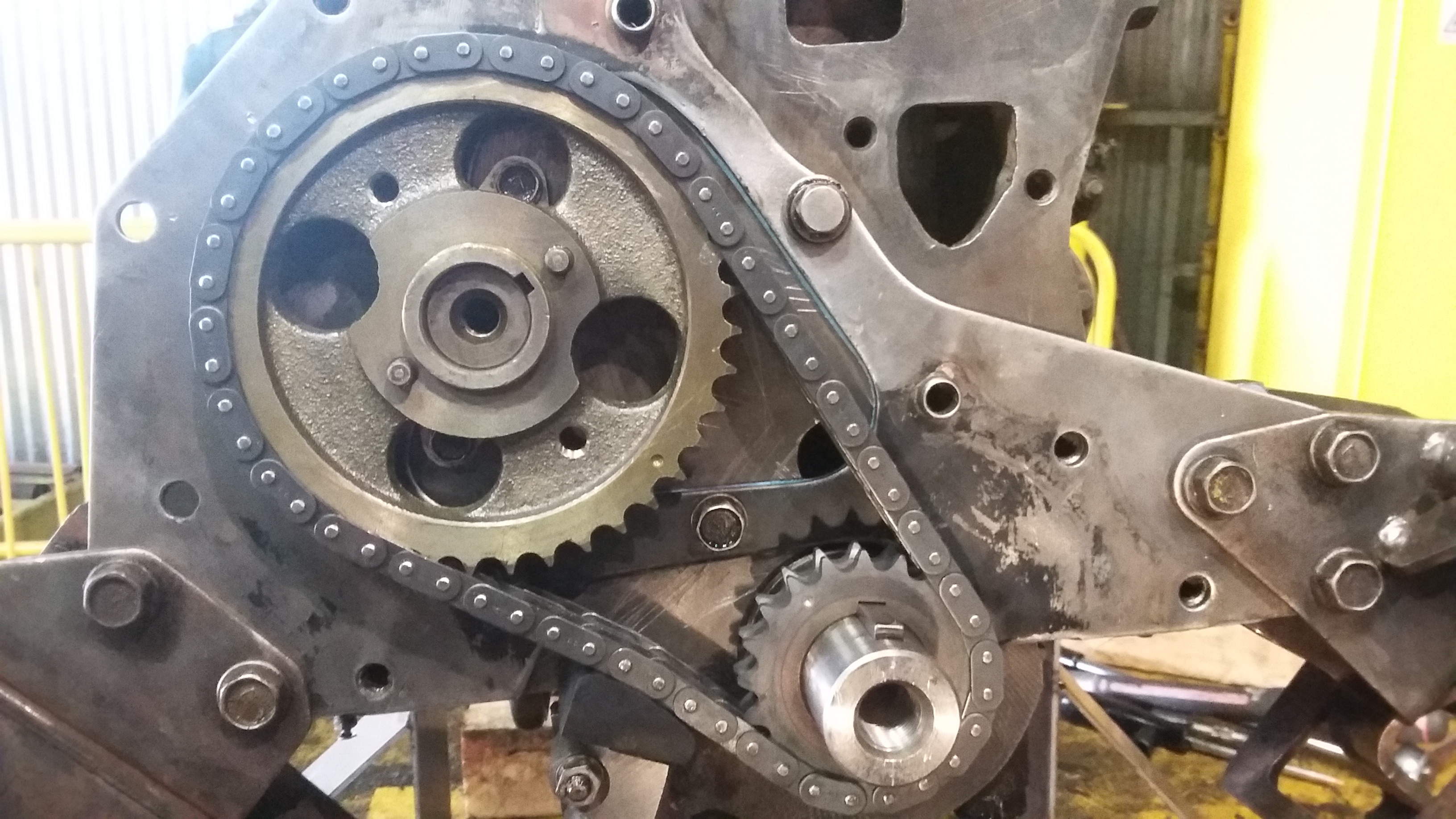

Well I've been working on her luv this year. My timing chain went out so I'm replacing that and all the gaskets. I was having trouble on how to work on it and thanks to Matt I got my self a shop book on my luv. Here are a few pics

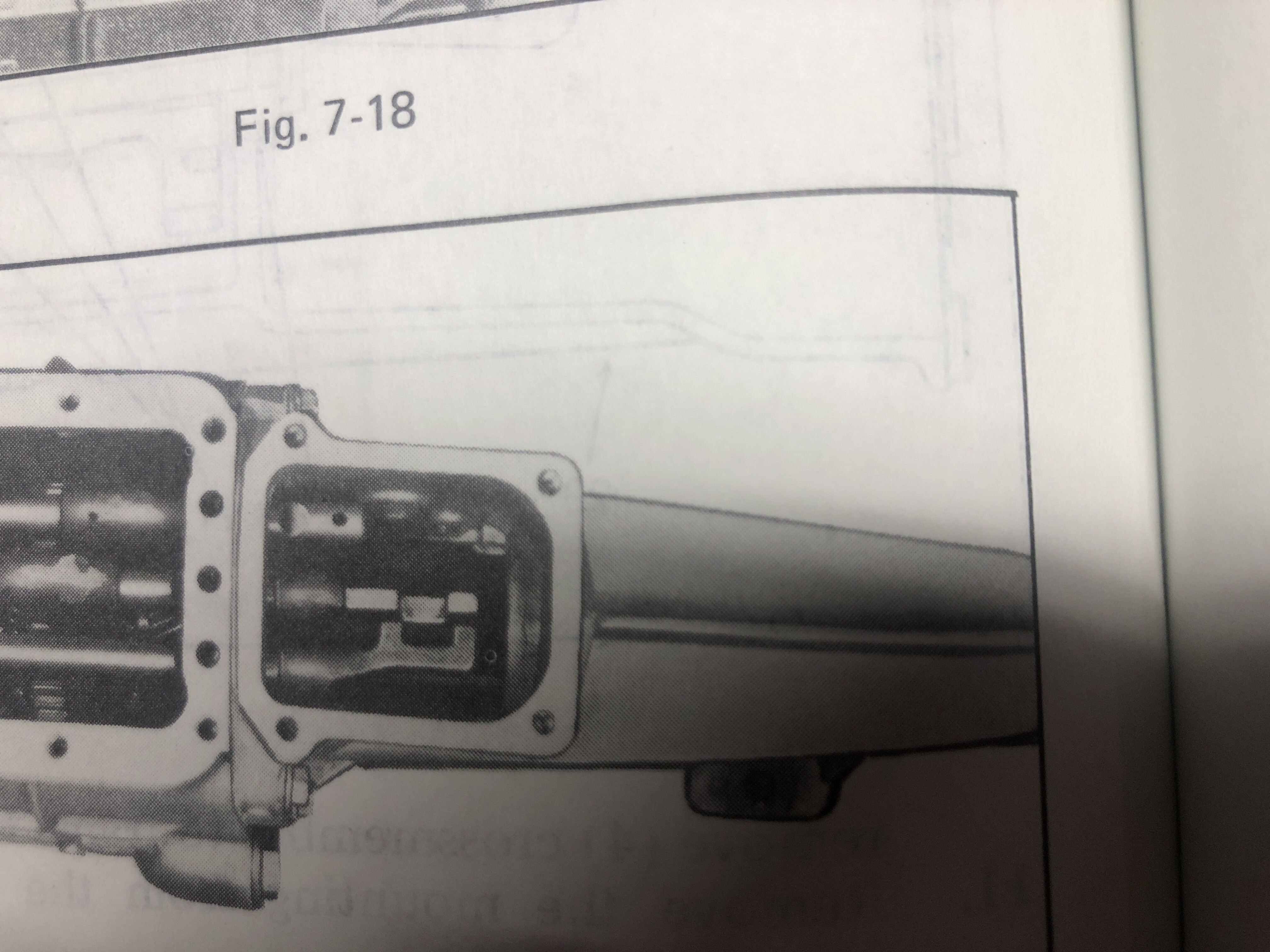

I decided to work on the luv over the weekend I unbolted the gearshift lever and even that was stuck. It didn’t slide right out like it’s supposed to so then I decided to the cap that’s under that so I took the 4 bolts off and I still couldn’t remove the shifter then after playing with it and rocking it side to side it popped out and I noticed that it was jammed in one of the gear rods so then I lined up the rods put it back together and I was able to put it in N R and then in 1-2-3-4 I was really happy!! Then I drove it around the block and it seemed really good but then but now I need to bleed out my breaks.
File comment: Then took this one off and wiggled the shifter for a while till it popped out and then I lined up the rods and put it back together
File comment: Took this one off first and it was jammed
