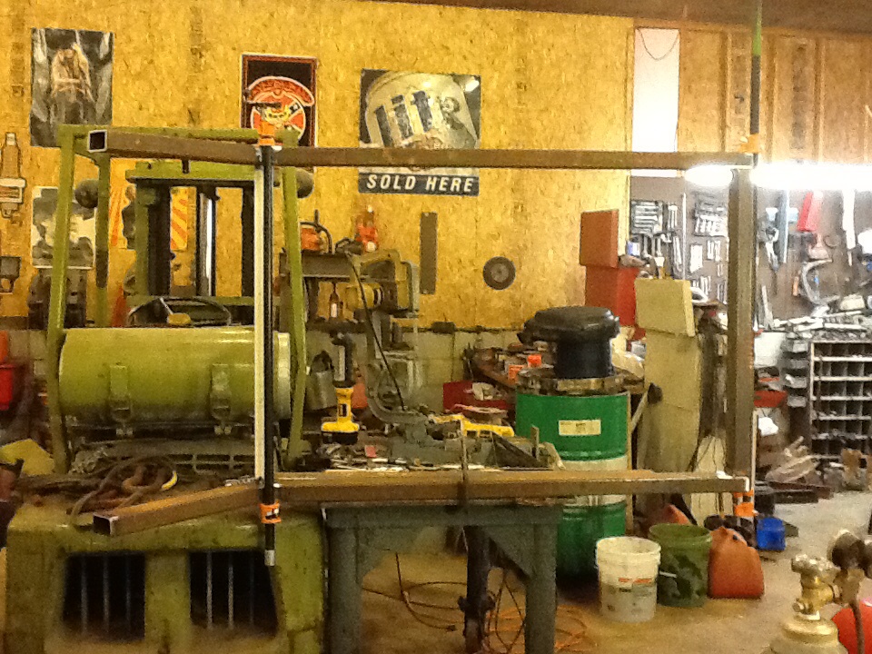

Posts: 95
Mocking frame rails

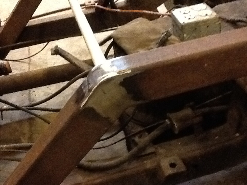

Posts: 95
Cut the rails at a 45 so I didn't have a point therefore I radius the one cut and then folded the top piece down because I don't have a bender for 2x3 lol

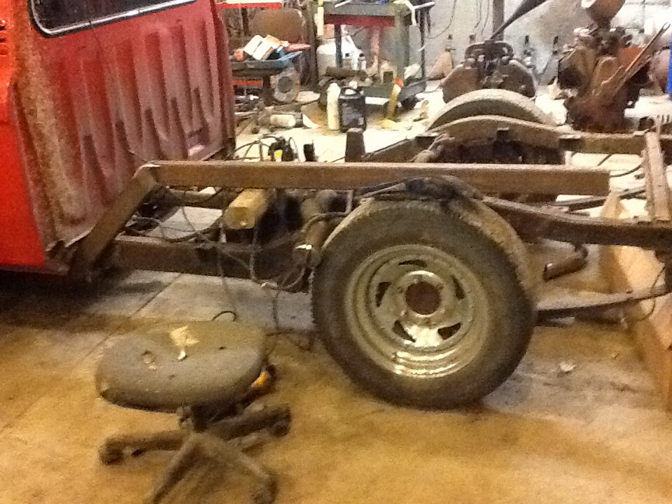

Posts: 95
Set on the truck to get an idea of what she'll look like

Posts: 95
The back half looks short because I forgot to say its along bed truck I'm shortening to a swb truck
