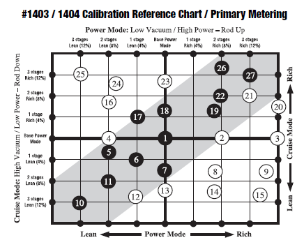

PostPosted: Thu Nov 05, 2015 7:41 pm
attached the Edelbrock tuning chart to this one..
I started at setting 18.. idle and up to about 2500 was good as long as I didn't try to suddenly jump on the gas, beyond that all sputtering and missing and struggling to gain speed smoothly
currently at setting 5
the idle and right off idle is really rough and when I first give it gas coming off idle it drops rpm then picks up and by 1500 it is running great,
it runs more smoothly at 2000rpm than it ever has it pulls along really well, I found a nice dead end road way out there and I was able to keep the tire spinning 1st thru 4th until I let off, anywhere above the idle area it runs great it pulls really hard from 2000-5500, there is a very slight miss/something in there but it doesn't slow it down in any way.
I am thinking it wants to be more rich way down low so I am going to pick up a pair of rods to move it to setting 4 and richen it up by 3% at the very bottom. still 5% more lean than I had it before but it is at the 0% mark right where the carb was set to begin with.
I am considering a more high quality distributor than the one I have now and see how much that helps. will be getting it on a dyno soon to check my a/f ratio and get a power slip
gonna try to get my hands on a vacuum gauge so I can check my idle vacuum

PostPosted: Fri Nov 06, 2015 6:22 pm
Couldn't get the idle right.
Bumped the base timing from 10* to 8*
Swapped to setting #11 so it is 2 stages lean all across the board
Idle improved but not perfect, still a bobble when I try to accelerate. Remembered i changed from the 6 in/hg spring the carb came with to the pink 7in/hg spring for some reason not sure why... so i just swapped that back to the 6" spring. Havent run it yet
On my way to get a vacuum gauge so I can finally fine tune the idle for max vacuum. And I should be able to hook it on my wiper so I can monitor when my rod step up springs should be opening vs when they actually are and make sure the springs are right. Hopefully today or tomorrow I can get it dialed in well enough to merit a dyno run
