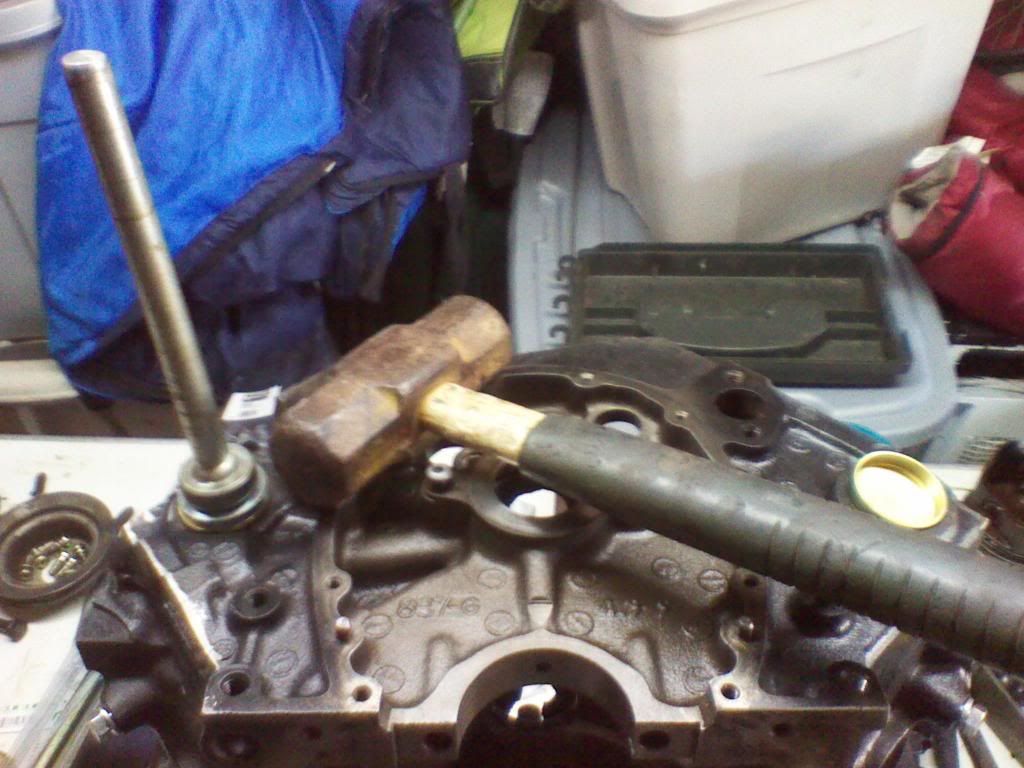

PostPosted: Mon Jul 22, 2013 12:01 am
small update
drove in the rest of the expansion plugs
popped the block up on my stand for assembly now that the new cam bearings are in.
used some carb cleaner and a no fuzz rag to clean the rust preventing coat off the crank
got the main bearings installed and plasti-gauged, each one has clearance In the middle of the acceptable range, same with end play, its good to go :ebiggrin
with that done broke out some more assembly lube and torqued down the main caps
I need to pick up a piston ring compressor and I will be able to finish the shortblock. ordering valve springs this week and then I can pop the heads on. going to break out the dremel to gasket match and smooth the intake ports and water jackets while I have them off to lap the valves and install the new springs
