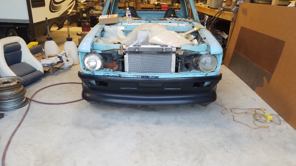

Almost to the point of tearing it back apart for paint and a few more details! I have been busy with family, friends, and other activity's that have gotten in the way of the build. This is a few pics. that show some progress!
The first one is of the new bumper setup and it is a nice piece too!

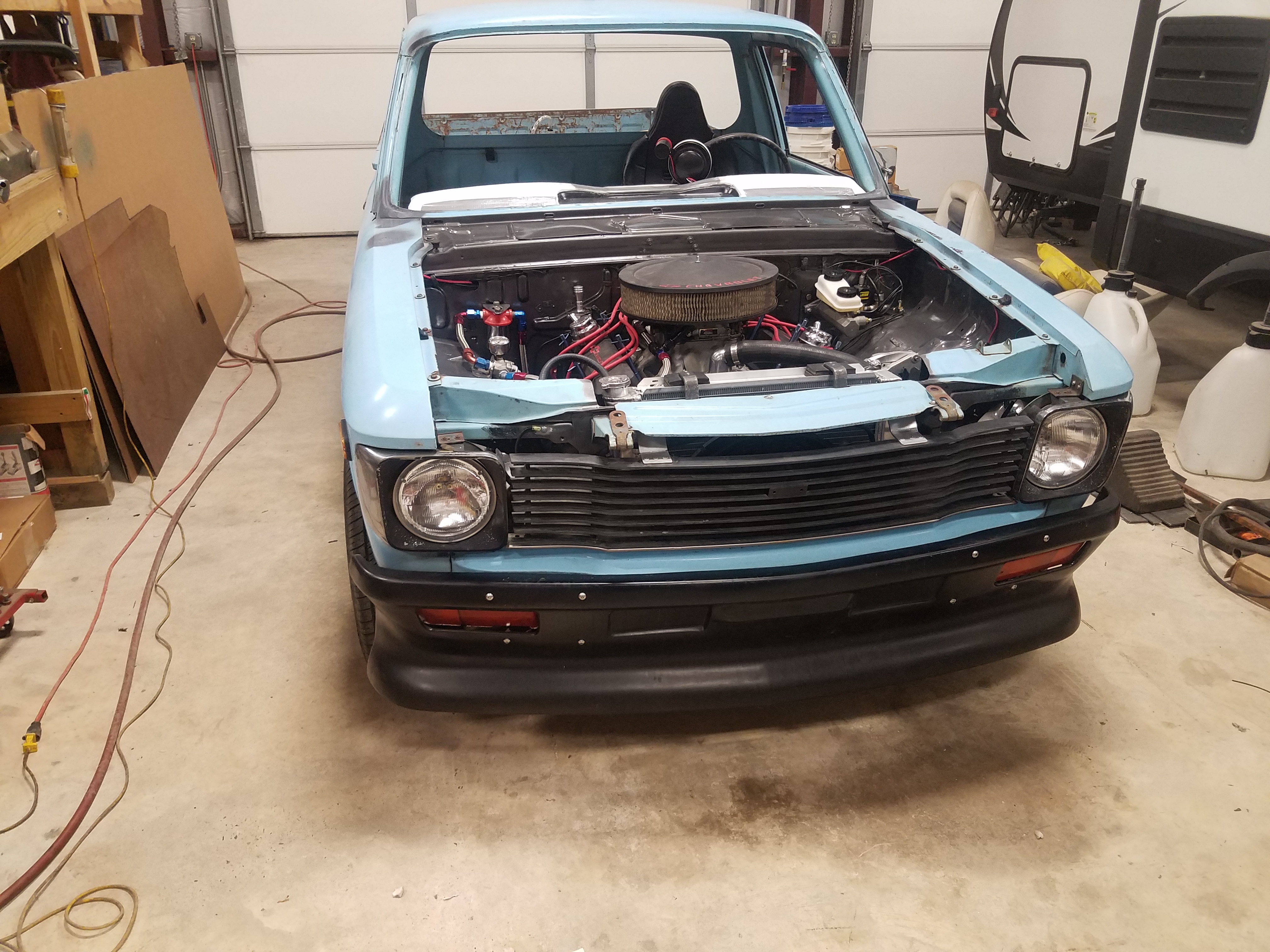

PostPosted: Thu Sep 26, 2019 10:14 pm
Posts: 114
Location: Magnolia, AR.
I have driven this truck twice. Just down the road and back Found a problem or two and corrected them. The biggest one involved firing order (as I didn't build this motor) it had a 4/7 swap cam. Swapped wires and BAM this thing will fly. Scrubbed it down to clean it up and got it ready to install the roll cage and glass then testing will begin!
