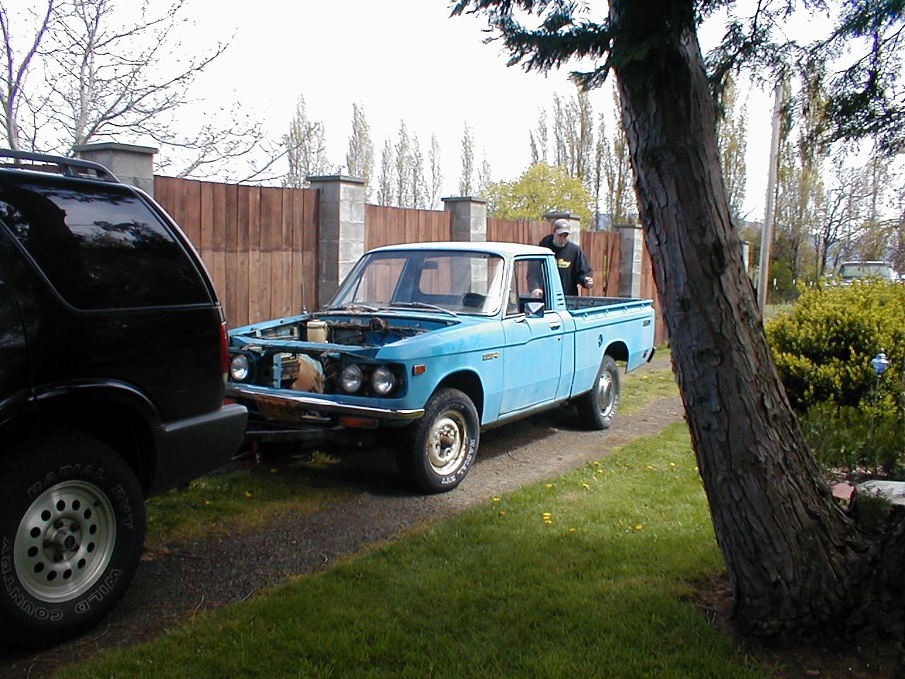

The LUV project has finally got started.
Pics of the progress...
