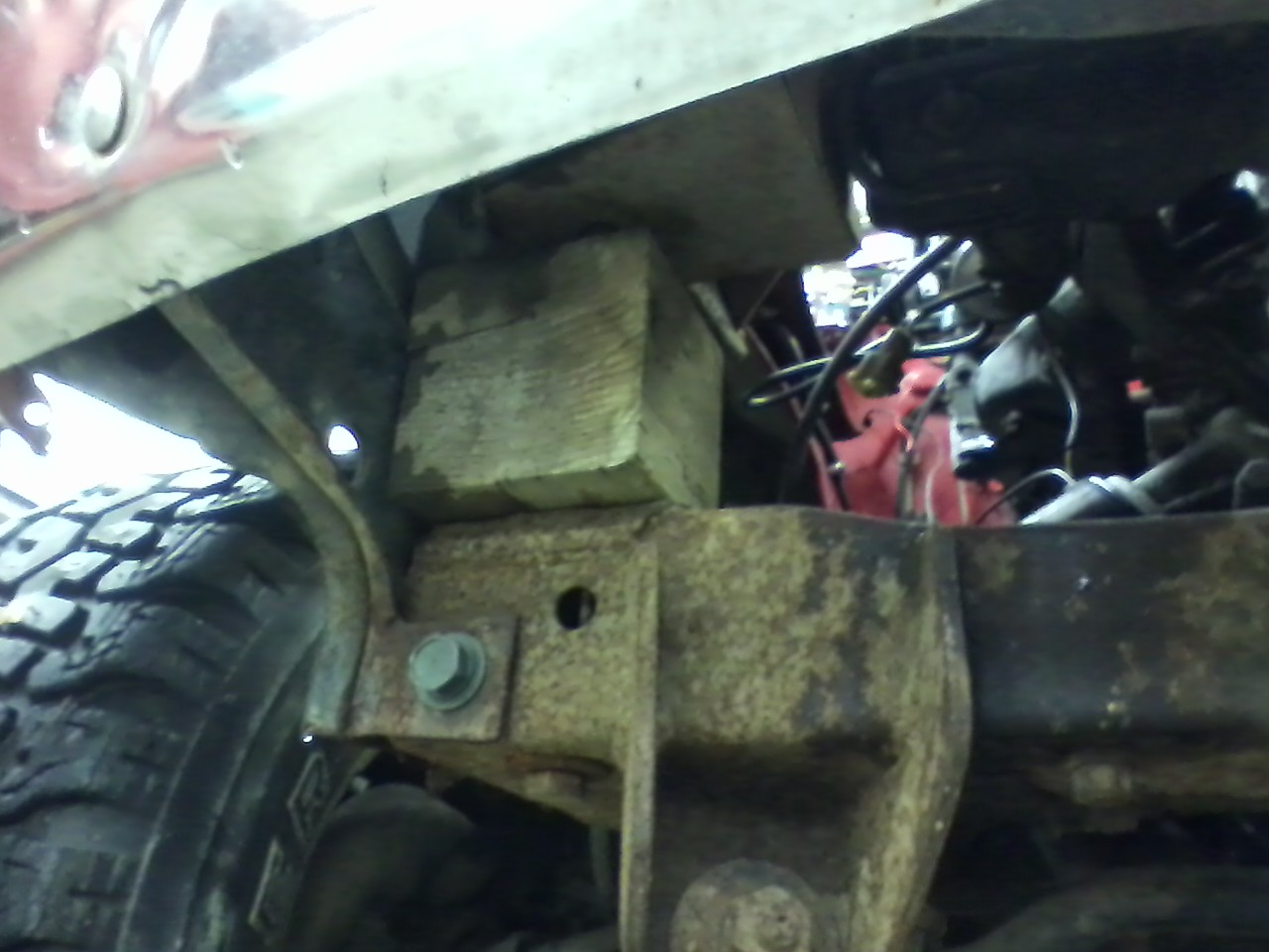

If you want one that bad you can have mine when I'm done with it on monday. $15 for shipping and it's yours daaawg. they're even pressure treated for long lasting durability :lol!:
And no, I didn't put them in
