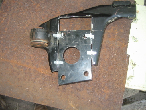

Has anyone sucessfully dropped the front diff to help decrease the cv angle on a torsion bar lifted Luv.
Its been done on Rodeo's, heres a few pics.
File comment: Marked out ready to cut

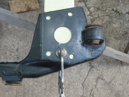

File comment: Cut out an relocated, ready to weld

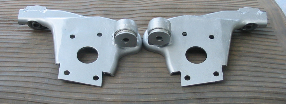

File comment: Finished product, diff now sits lower.

Made a start on my Diff Drop today, pulled the brackets out of my 80 Luv, 81 Luv and 85 Trooper parts rigs. The brackets from all the rigs are the same. After looking at the brackets, i decided to cut out the diff bolt and axel holes out ready to weld a new longer piece of metal in. Before i cut i made a template of the diff bolt pattern , i left the top two holes to help transfer the bolt pattern back onto the new metal, only this time 1 and half inches lower. I hope this all makes sense 8)
