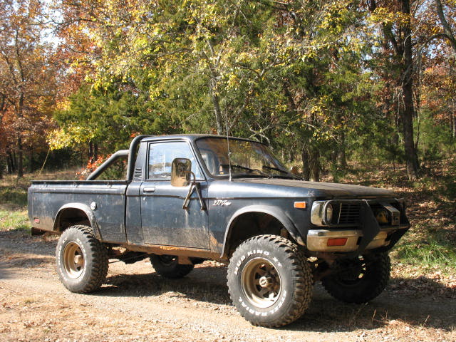

Even with the trimming on the white truck I guarantee the front tires still rub. The rims don't have a lot of backspace or they would rub even more. I don't think you can eliminate rub with anything more than 31" tires, 8" wide rim max & as little backspace a possible & still clear the frame.
My truck has way more lift than the white one or than you're talking about adding, has 31/10.50s on 8" rims with 3" backspace plus a lot of fender trim & the tires still rub on the back front liner. It also has more suspension travel & flex than yours will have, so maybe you'll be OK. The same tires on 7" rims with 4" backspace might not rub.

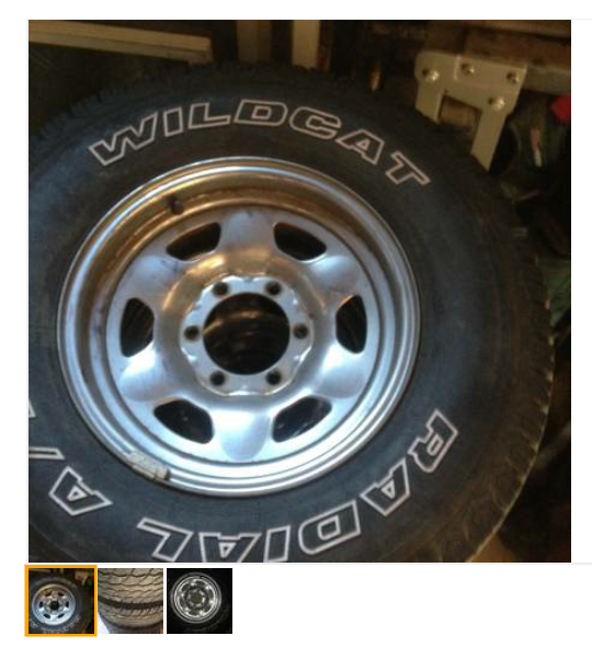

Something like this wheel most likely. Toyota truck 15" with minimal back spacing and 8.7-9.5" wide tires

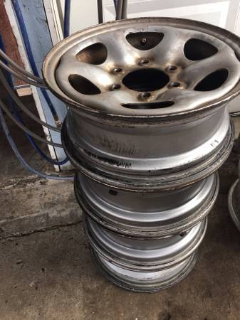

Found a set of 30x9.5R15 with wheels I am gonna take a look at later today to measure back spacing.
Tires dont have a ton of tread but they are very cheap and will work fine for getting my trimming and lift sorted out and a few months of use
PostPosted: Sun Feb 21, 2016 2:34 pm
Wheels I have now are 14x6 3.5" bs Picked up those wheels above they are 15x7 3" bs with 30x9.5s
Will see how well or not well they fit soon and go from there. They were only 75 with usable tires so no big loss either way if the wheels don't work out but I hope they do. Was aiming for 3.5-4" bs but the deal was just too good. Somehow left with a 5 gallon gas can too :lol:
