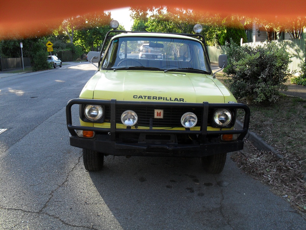

For those who wish to fit a bull bar to their Luvs, i have found the ARB 3434010 is a compatable fitment for the Luv. They are listed for fitment to 81-88 Mitsubishi Montero's. All you need to do to fit, is fabricate two simple brackets from flat steel and drill four holes.
http://62.26.12.209/indext.php?artnr=2- ... 1000030010

for that price you could custom fab one along with matching rear bumper! :lol:
does look pretty beastly on the luv, "caterpillar" is a nice touch :egeek
