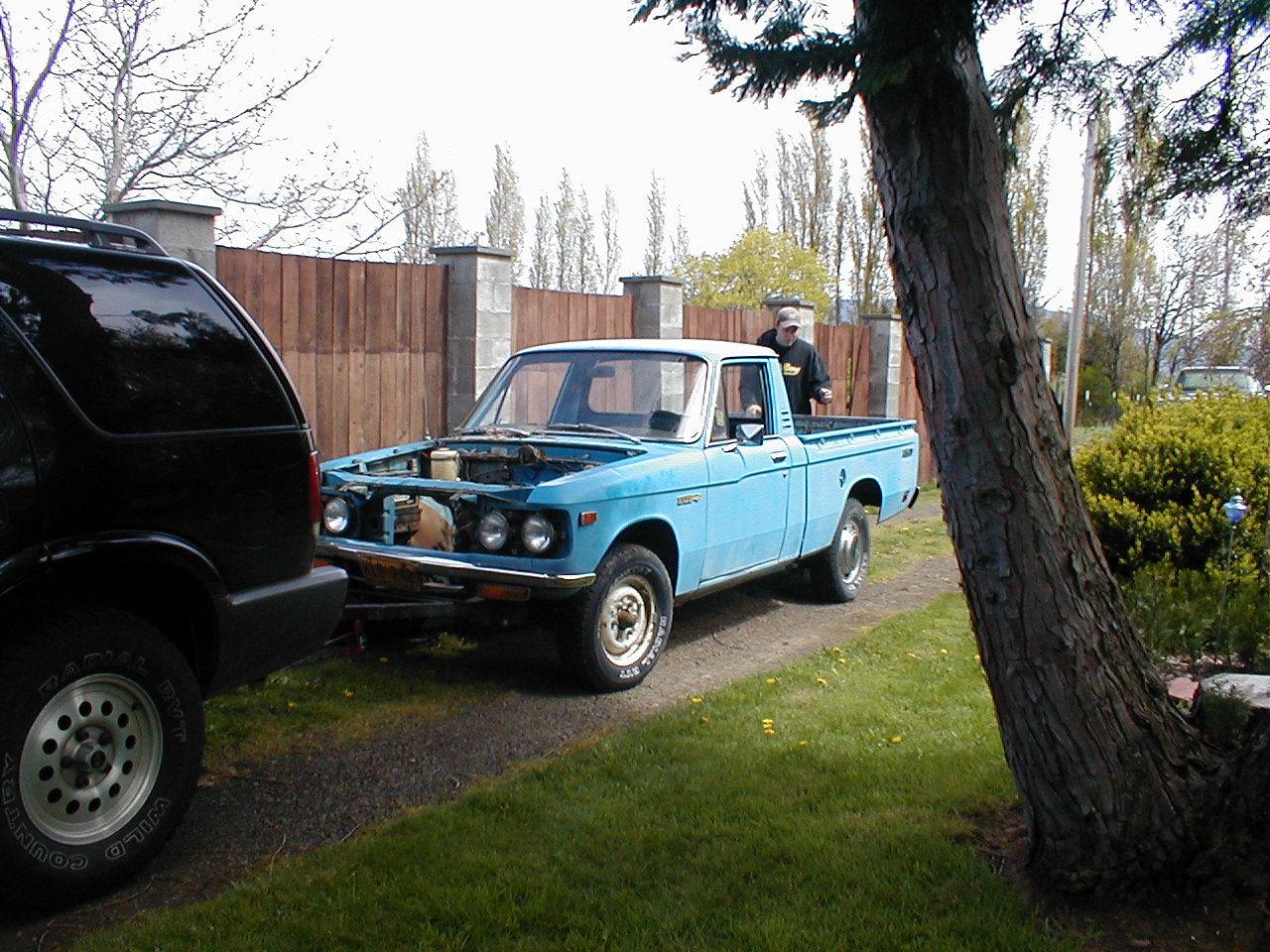

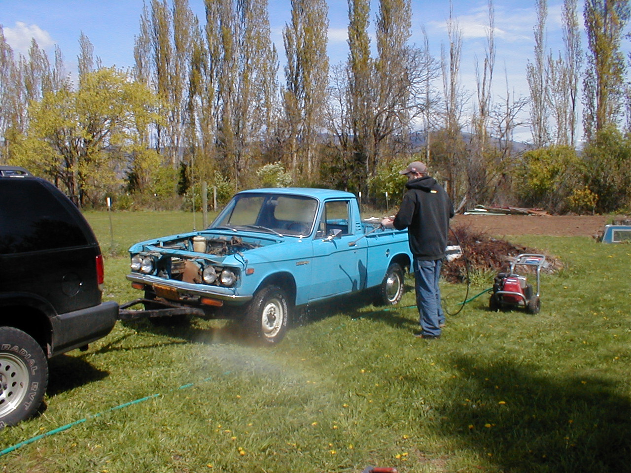

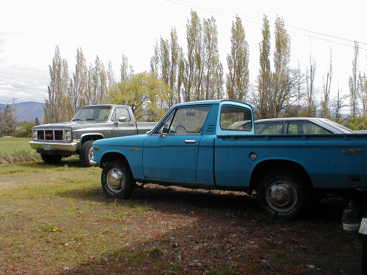

Here's a few of pictures of the Luv.
My wife & I purchased the Luv in 1991. It was a daily driver for about 10 years until it overheated for the last time and cracked the head or block?? Very hardy little truck. Replaced it with a 1986 GMC 4x4. Now it's time to bring the Luv back to life.
Ready to install 350/350 auto in Luv. Any suggestions? Have Hooker tranny & motor mounts. If the engine & tranny are connected and installed together, is there enough clearance to get them in the Luv. Is it better to install the tranny first then the engine. How much of the front needs to be cut away? Any advise will help.
Thanks

There are a couple of links on the main page of this site that will be helpful. http://www.luvtruck.com/Information.htm
Beer budget V8 Swap http://www.luvtruck.com/pdf/engswap.pdf
Hooker Kit Instructions http://www.luvtruck.com/pdf/12606.pdf
You can download these in zip format also. If you want to keep the core support in tact, my understanding is that the truck needs to be close to 3 feet off the ground in order to get the engine/trans in as one piece. Another option would be a pit. You can also cut the core support loose from the front fenders and cut out the inner fenders altogether. The fenders hang fine from just the cab and the core support. Look for photos here of some of the V8 trucks, it will make more sense.
I'm not actually sure how folks have gotten their engines in. I'm sure you'll get more answers...
What do you plan to use for exhaust?
What are your plans for HP?
Street truck or 1/4 miler?
You may want to look at upgrading the brakes too... :ebiggrin
Your truck looks really solid, have fun!

There is plenty of room. I installed my motor and trans as 1 unit and have a full stock core support. I only had my front tires maybee 6 inchs off of the ground.
