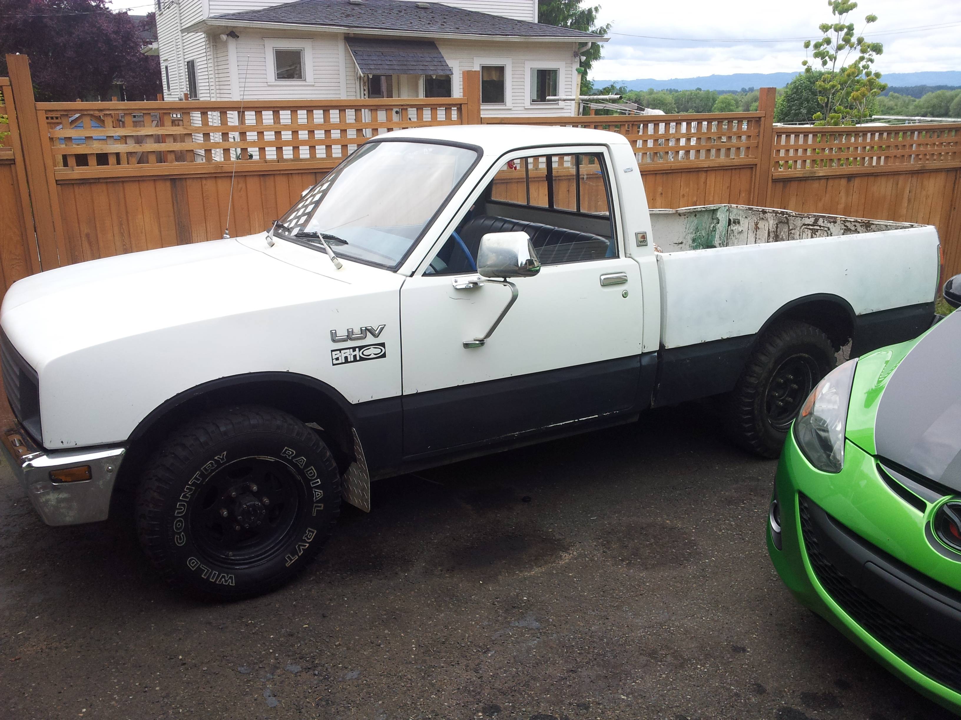

I actually bought this rig about 6 months ago to drive while my main daily driver was in the shop, She is quite the frankentruck! it says 1980 luv on the title but i know shes a hodpodge of parts. Right now its sitting idle until i can throw a new carb and water pump on there, which I would like to order but i have a couple questions! I'm very excited about getting this truck fixed correctly. The person i bought it from used it as a farm truck for a number of years so there are a lot of farmer fixes on there! Engine wise, there's a g180 stamped very clearly on the right side of the block. which is paired to the 4spd 4x4 transmission. The bed is toast, which makes me sad but im sure i will find another one out there somewhere. I paid 800 bucks for the truck, and i certainly got my used out of it. I look forward to talking with everyone as i get this ugly duck to where she deserves to be.
What year were the g180 engines put in the LUV trucks? any recommendations for a replacement water pump?
http://i.imgur.com/CZAUINA.jpg
http://i.imgur.com/tlw92Vj.jpg
http://i.imgur.com/k03F7O2.jpg
http://i.imgur.com/j3zrske.jpg
^Pictures are too big to embed in post ^
Thanks everyone!

The g180 sohc cross flow headed engine the 1980 has was put in there in 76 I believe and is the same as the later 81-82 luv as well. The earlier g180 was a wedge head with intake and exhaust on the same side
As for the water pump it doesn't make huge difference as far as I know. Go with a brand you have heard of and it should last
PostPosted: Fri Mar 27, 2015 5:40 pm
That body style is actually a 81 or 82. Nice truck.
PostPosted: Sat Mar 28, 2015 11:16 am
Yep it is
whoops i didn't even look at the pics I just went off the 1980 title :lol:

Really? Nope. Attach them, don't use the "Img" button. Here's the original, unedited image...
The forum makes the thumbnail image, but click it to see it full-size.
File comment: Too big? Nah.
That bed looks better than most I've seen. Short beds seem to be easier to find than long beds. It took me about 10 years to find a decent long bed to replace mine, and I got pretty lucky.

The bed is incredibly shot in the middle, the sides are OK, the tailgate is swiss cheese. Currently there is a 1/2'' rubber Mat protecting my load from falling out through the center of the bed! but as far as aestetics, yeah its better than many others, the cab is just beautiful and Rust free, so I'd take my rust in the bed any day. There is a guy about 50 miles from me that has a lot of parts, so I'll be driving down there at some point this summer to hunt for a bed, and potentially a transmission, It whines like a hungry child, and 3rd is so warn down it pops out pretty easily. I will make a new post and video to see if i can get some help from you folks there.
